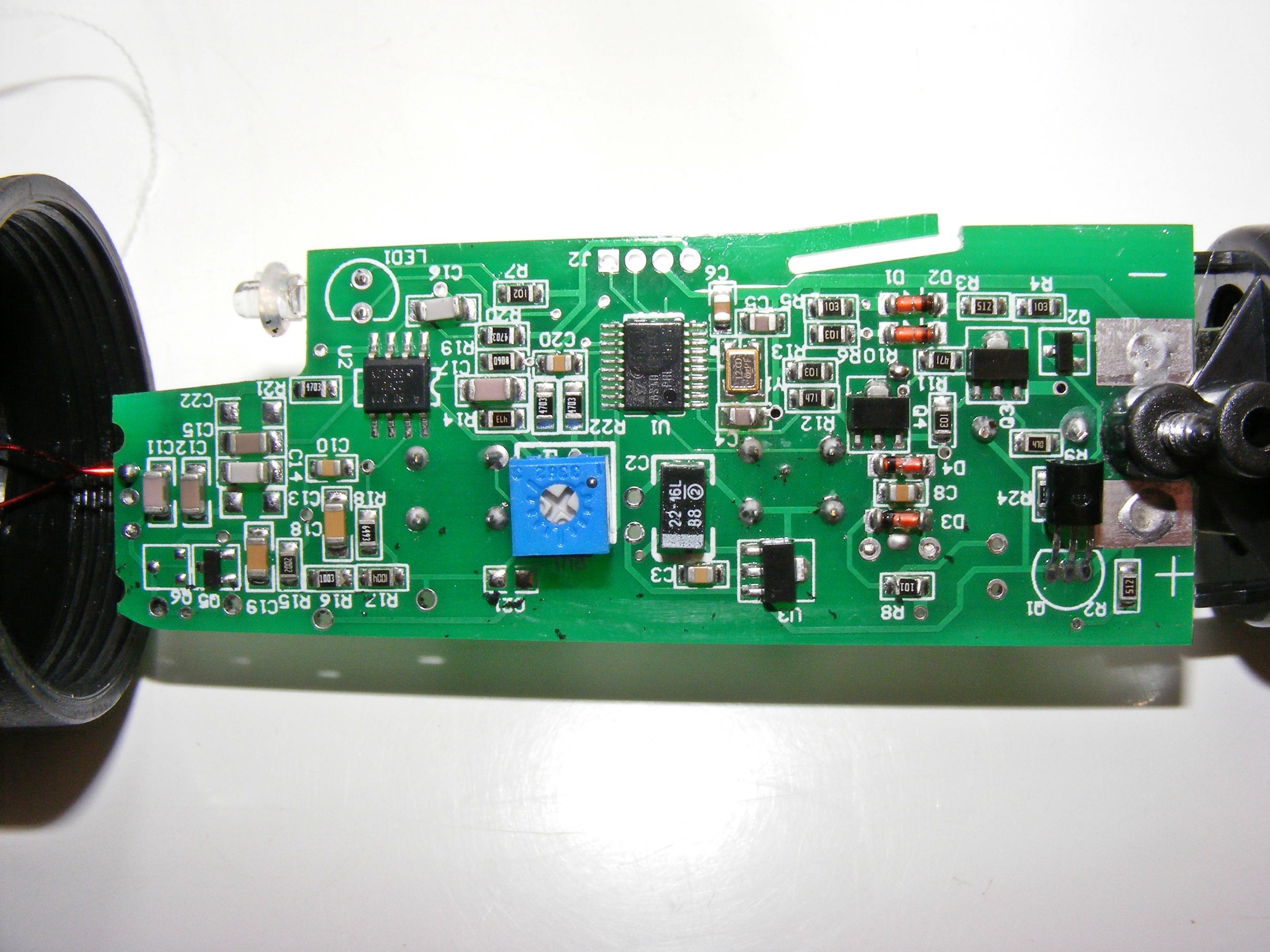

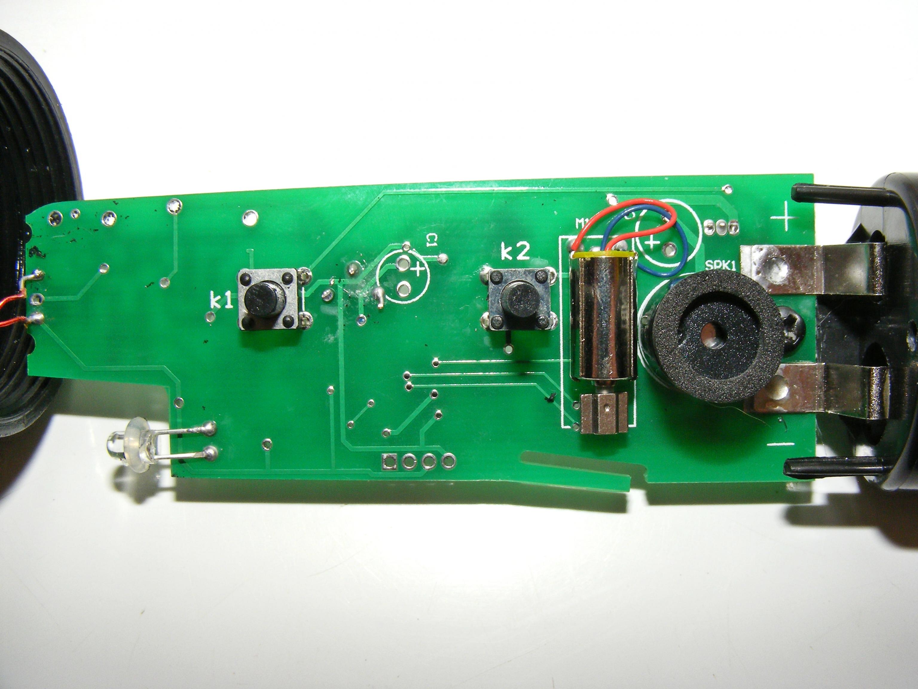

            you need to carefully take the pointer apart and take some photo's of it both sides, inside ,and of the coil maybe we can help, it may be a fault with a switch(like kt315 said), the coil or a connection somewhere, which is why proper photos are a must.

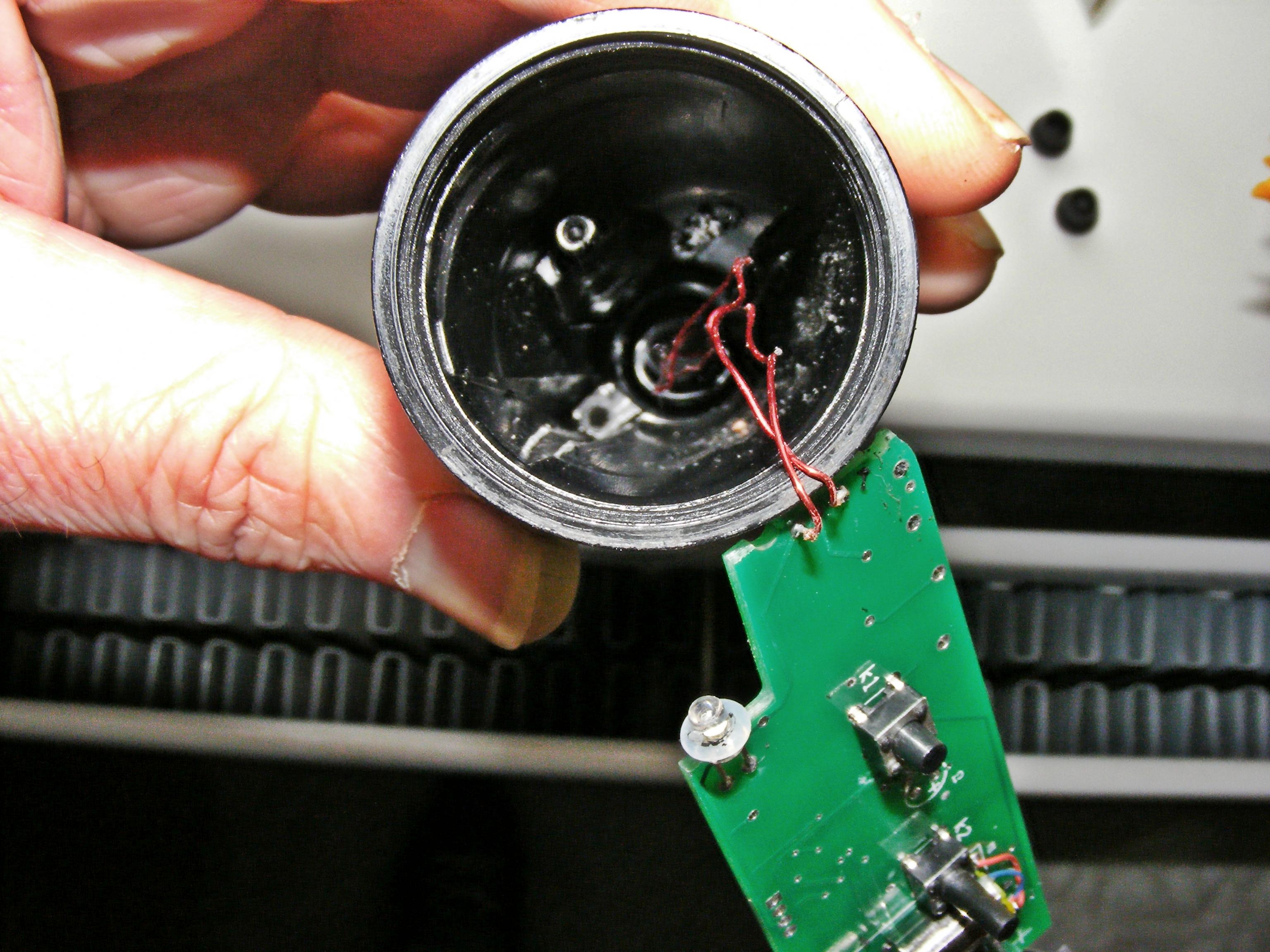

              when i looked down inside it looked as though the coil was resined down in to the bottom of the tip.
              taking it apart was very easy. putting it back together was the hard part as you kept getting the 2 wires that lead down to the coil trapped pushing the board in, which was stopping the board from going all the way back in.
              i will take the board out again tomorrow and take some pics and put up.

                  here is them pics that i promised of the inner's of the xpointer. sorry for putting them up so late.
                    Is it possible to remove? The coil out
                    I personally think that the ferrite rod can be broken. Watching what the others say.
                      reminder me the garrett pro pointer. also I see the micro like stayed in pro. still it is not the garrett. IMO a generator may be similar to pro one.
                      pro has a problem in generator, frequently discussed in russian forums that I observe...
