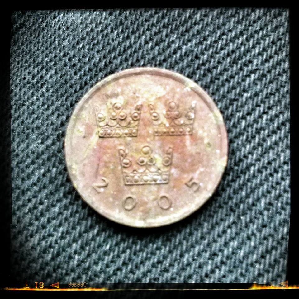

          So, wnet out for the first fieldtest, and after 3 minutes i found this, around 3cm deep:
          a worthless swedish 50-öring, but what the heck, it's my first find !!
