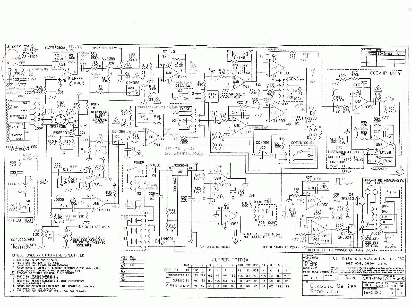

    A little help needed in getting a Classic SL up to snuff.
    I have the IMD book and am referring to instructions on page 103. I also have a schematic located here: http://www.hobby-hour.com/electronic...tesclassic.php
    The schematic doesn't exactly match my detector though. I have no VR6. I have VR3,1, and 2.
    I see what appears to be 230 degrees offset of the TX/RX waveforms at idle.
    The unit I have has some random or repetitive beeping that can be somewhat minimized by adjustment of VR3.
    VR3 goes to R43 - but my R43 is 3.3K not 6.8K, so who knows how much of this schematic matches my board.

    If the White's Classic I is motorboating, then you'll need a scope to debug the problem. Have a look at the outputs (which are wired together) of the two comparators (U4A and U4B). I suspect you'll see some oscillations there. If so, then probe the input pins 3 and 5. From there you should be able to isolate which channel is the culprit, and trace back from there.
    Also, try this schematic.

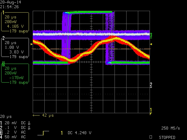

        Man, this is making me feel stupid. The TX is solid along with the sample control pulses but pin 14 of the LF444 has the variability causing the audio pulsing.
        Pin 8 is relatively stable. The pinouts in my original schematic and the one above have some pin numbering issues. The original doesn't list U3D. The one above has input to U2B as pin one and it is really pin 4. Anyway, there are little switching glitches at the switching points that jump around with the variability of the preamp output signal. Is this where the amplitude variation is coming from? Is it a 4066 going flakey? I attach two scope shots - one with the input and another with the output side of this switch.

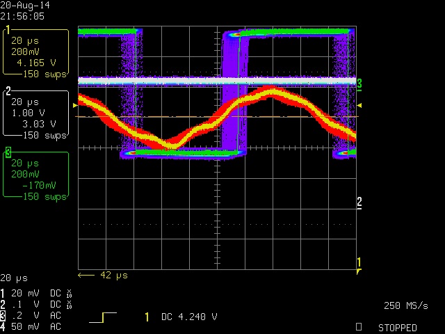

          Here are two photos: one is U2B sample pulse pin 5 and U3A pin8, other is U2C sample pulse pin 13 and U3C-14.
          Persistence shows the range of the trimpots. Does this look correct?
          You can see the ripple on the preamp output.

                Thanks goldfnut, good to know that this can be common. From my photos you can see the preamp output ripple (red persistance). This variation seems to be what is causing the motorboating. It probably is at the 8hz frequency or so that you mention so does sound like this unit's problem. I'm thinking of trying another coil to see if it remains. The SL has a hardwired coil so I'd have to kludge one in or modify the box for the traditional connector.

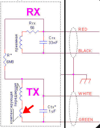

                  The coil with the SL has some capacitors in parallel with the coils. I am suspecting it is the cause of my troubles but measuring it ends up with bogus data.
                  With my LC102 the tx is -(!)2.48uH and rx is 12.77mh. With a bk 875B the tx is 1.66mh and rx is 12.5mh.
                  Doesn't help much eh?
                  I've also come to realize that the spectrum xlt coil has a different connector than what I had intended to use (one like on gp extreme).
                  Anyone know the pinout?
                    Here is a typical White's coil schematic;
                      Thanks very much - never seen that detailed before.
                      What method is used to check such a coil? Frequency sweep?
                      Another problem I'm running into is obtaining the 5 pin xlr connector sets at a good price. Unique pinout for these Whites machines.
