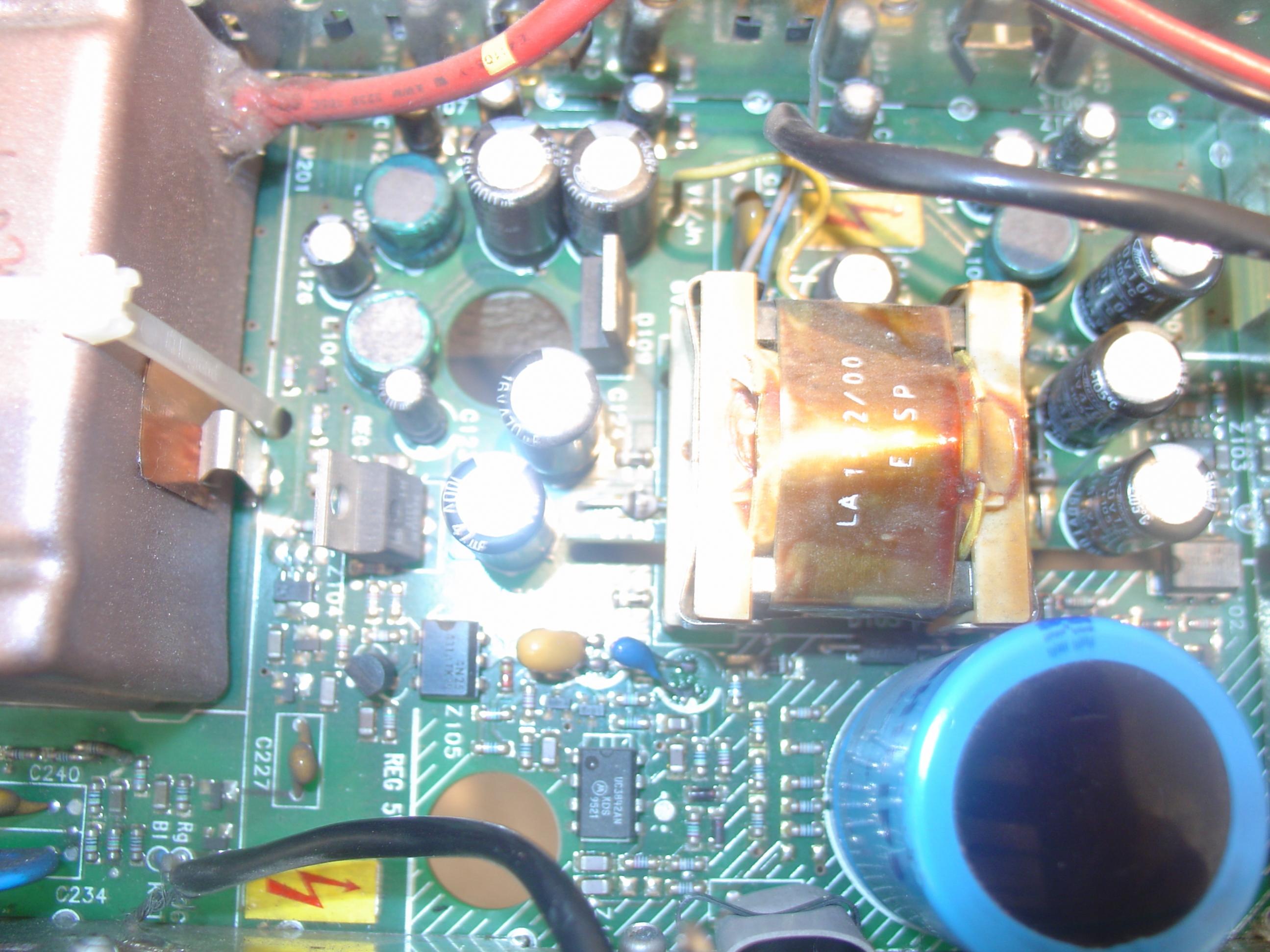

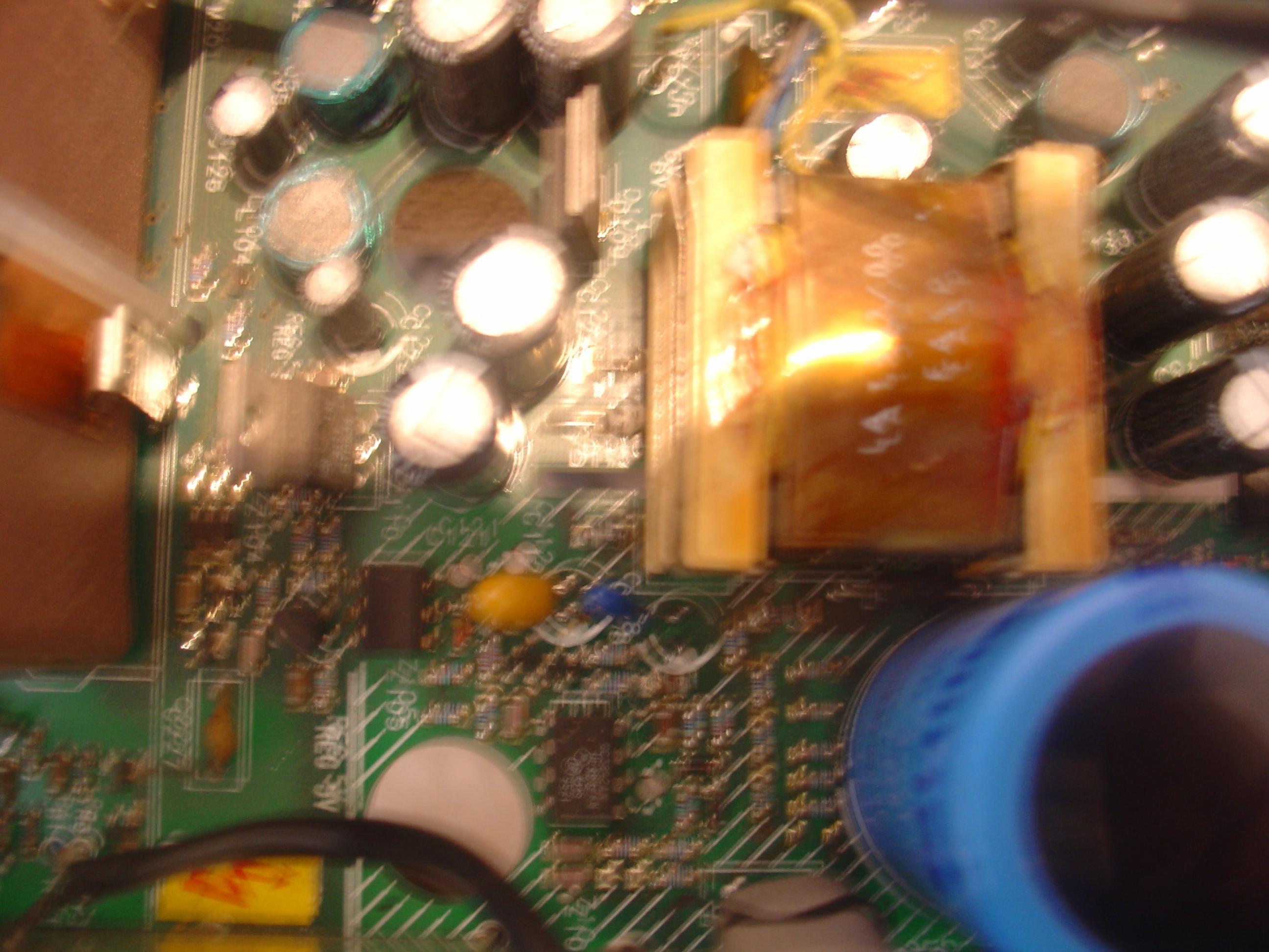

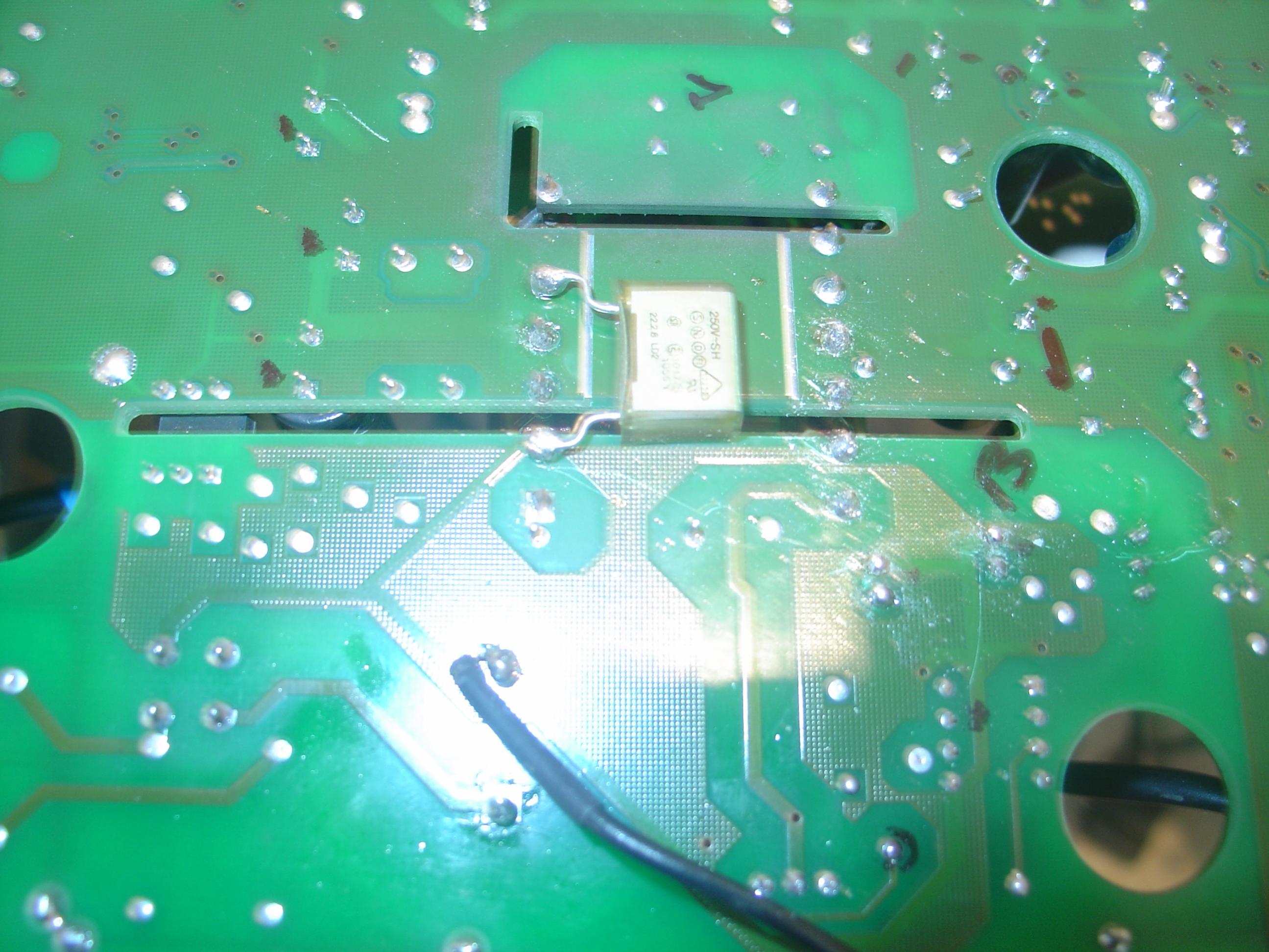

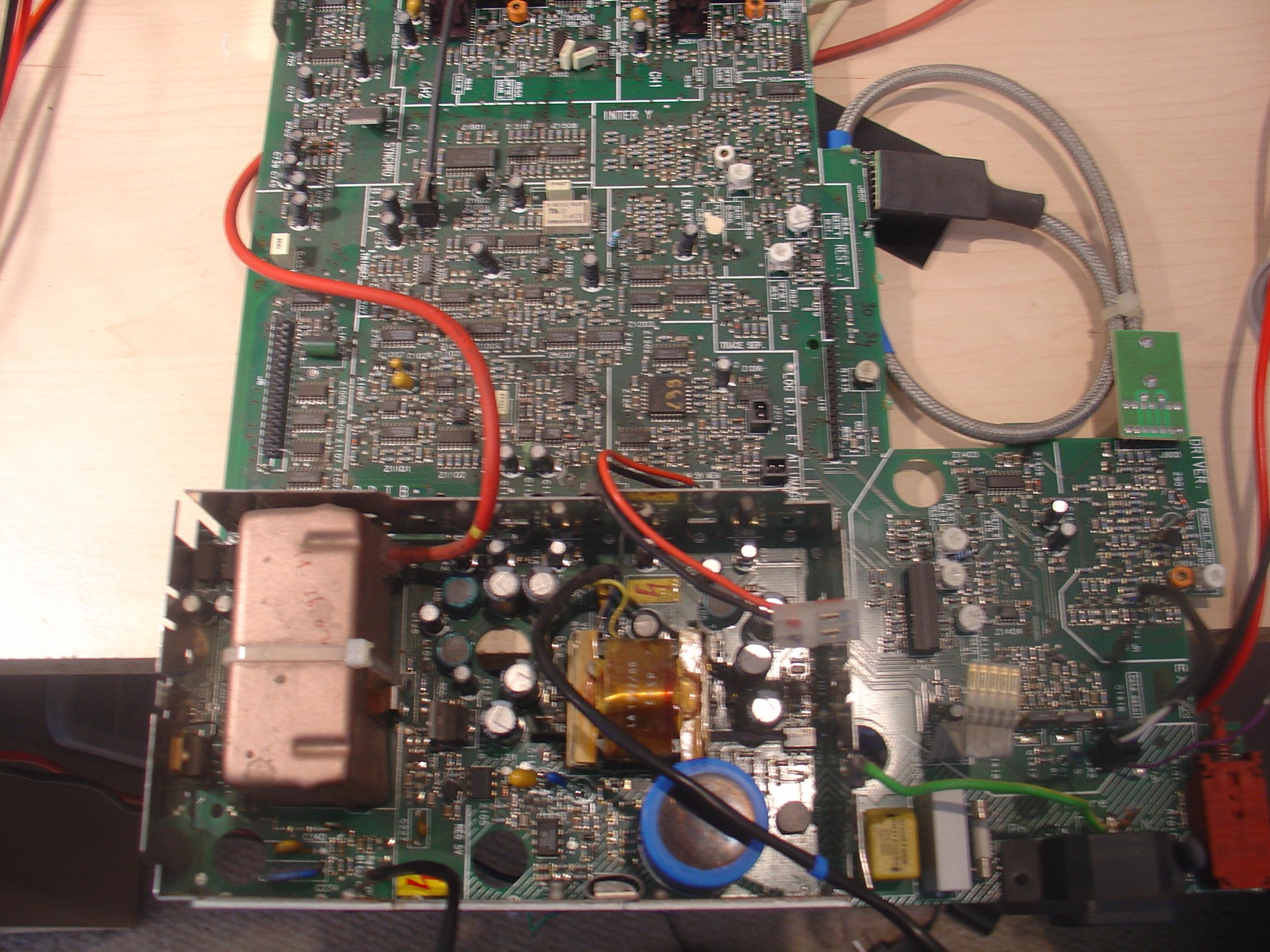

ID:	341534 before i dismantled the scope when i pushed the power button the led's on the front panel would light for about 1 second then nothing...there is no squeal when powered up !!!! i must admit in the area where the chopper transformer is soldered the fiberglass board is not level !!!! i have not replaced any electrolytics as they read ok on a esr meter and i cannot see any fractures...the tantalums i replaced !!! i did notice the ref voltage on the UC 3842 AN is only 1.2v and documents say it should be 5v so im not sure about this !!!!!!!!

              Because you have said that the leds come on for a second before it turns off, I would probably be looking for a fault in the secondary side of the power supply. If, when the supply fires up, the voltages dont come up to spec, the primary side will switch off. Check for shorted diodes in the secondary stage or faulty electros. If this was a job I had on my bench for a customer, I would just change all the electros (in primary and secondary) and double check all diodes. Caps are cheap and easy to replace and this would eliminate all the easy things. If it was still faulty then I would start looking for more complicated faults. Dont always trust your esr meter. I have had plenty of caps that read ok on a meter but were still faulty.
                what worries me is that about 2 months ago we had a water leak upstairs that came into my workshop and went over the scope and bench...later i took the top casing off the scope to check for any water inside scope but could not find any dampness inside or on the pcb !!! the scope has been working ok since this happened until now !!! maybe a coinsidence but not sure ?????????????? i will go through the electrolytics again...some of them are like 120v type which i havent got so would have to order them....do you think its a waste of time changing the oscillator chip cause my gut feeling is that the chip is not the cause ???

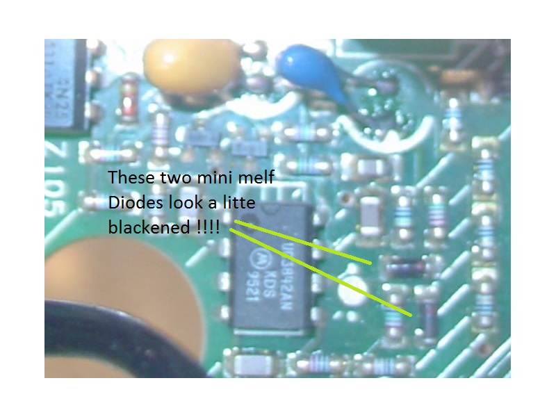

                  The only thing that looks like an issue visually is the attached.Click image for larger version
                    i checked the diodes with meter and seem to be ok !!! i will check the solder joints on the surface mounted components...not sure what else to do ???

                                most of the resistors are low wattage surface mounted type with small surface mounted brown capacitors...im really getting frustrated trying to repair this power supply....i thought maybe the chopper mosfet might be faulty but there are no shorts....what i cannot understand is that the oscillator chip only has a 2 volt reference on one of its pins when i read somewhere it should be 5 volts ???? but the supply voltage to the chip is correct at 12 volts.
