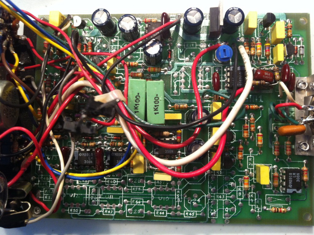

    is there a technique for setting notch width with a on the board trimmer. what i mean is like ground balance using ferrite and silver. is there a way of knowing if you set the notch width to the optimal setting.

                which notch and where? in King Cobra the notch does not knock out the metal. it changes only sound, from hight pitch to low if there is a foil or ferrous.
                a notch in ML GT or Elite, for example, works in another fashion, like Carl wrote.
                  Actually the King Cobra should go silent on objects within the notch in notch Reject mode. The notch width is adjustable internally. Objects above the notch give a high tone, objects below the notch give a low tone. If you turn the notch off, you still get two-tone audio above and below the notch setting with zero notch width.

                      notch width is some kinda a sector on one phase scale of the discrimination. it lows the sound pitch on unwanted metal targets. that wrote Merc is wrong, there is no silent, this is not modern technology more advanced that really silent, that is old analog tech. set the pot in middle position, go trip, then 45 grad at left from the middle, go trip, then 45 at right, etc... it is fully intuitive tuning, you have to be observe reaction at a foil, pul tab etc. - those have to give low tone or edge of low-to-high-to-low.
                        Perhaps there is a misunderstanding. I made a video to demonstrate.

                          merc thanks its good to see what it should be doing and at what setting. kt i see what your saying on how to set the width i just have to try different placements of the trimmer till i get the best one at high and low notch on the out side pot right?
                            Merc, if you are now so activizated up in forum... I ask you to help and give me a data on additional components above IC soldered at right corner of pic. this is pic of GMT1650 you shared.
                            I see resistors 100K, maybe... caps 50pF, maybe, and points of the soldering.
