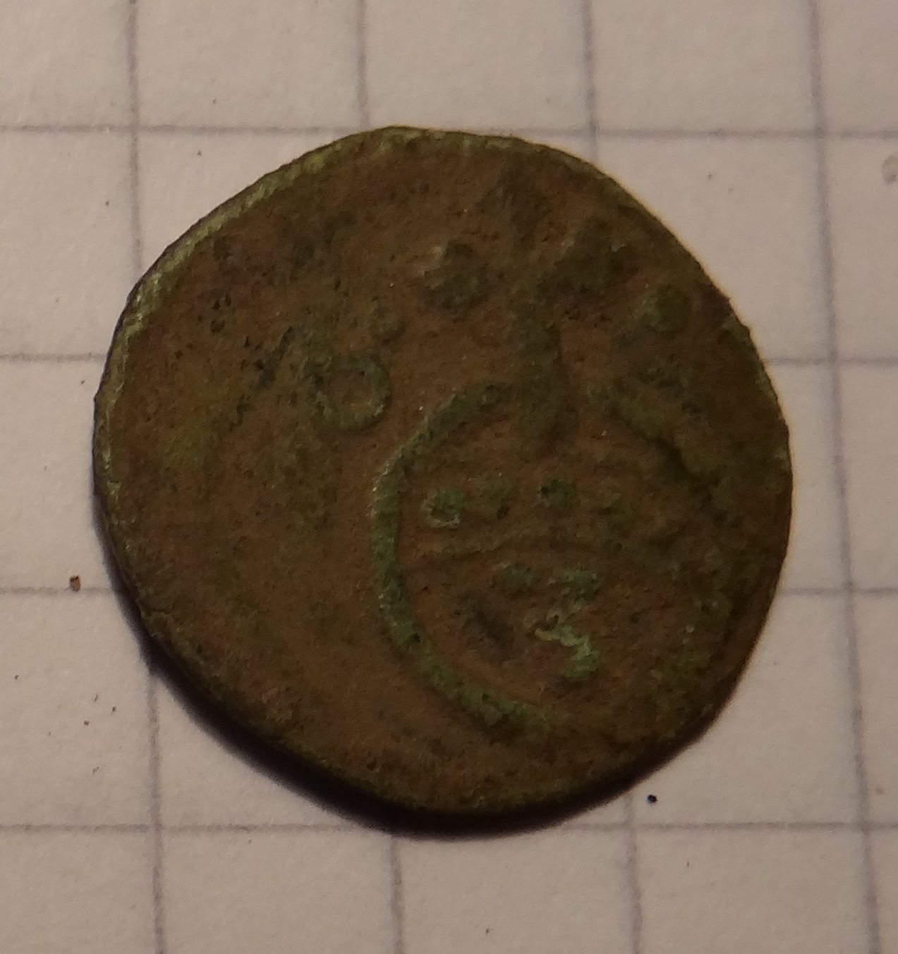

                    Today a very little coin (3Pfennig 16..), around 1.5 cm diameter came to me. I found it with the nexus and double 9" coil. My settings were:
                    Disc full clockwise (accept iron also), GB half between 12 and 1 oclock, VCO between 8 and 9 oclock, Treshold 12 ocklock, Sensitivity 1 oclock and Volumen 12 oclock. Searching were done in allmetal, dig only high tones.
                    The nexus was stable and does not give false tones.
