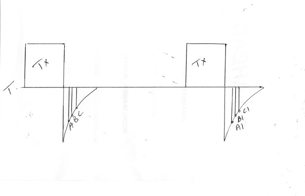

          I dont think I explained my idea very well. I have done a rough sketch to show you what I am doing

          I record for example 3 data points A, B, C then on next sample record A1, B1, C1 - I then compare A to A1, B to B1 etc and use the result to see if there are any changes. The EMF and GB in each sample ie A vs A1 should be roughly the same.
            That makes it a lot clearer.
            Your idea is based on the assumption that only a real target will produce a change between associated data points (i.e. A-A1, B-B1, and C-C1), whereas the ground and EF signals will be eliminated since they remain constant.
            I suspect (in reality) that this will not be the case. Firstly, the ground signal will only remain constant if the ground is homogeneous, and the coil remains parallel to the surface of the ground. In highly mineralized ground, the soil matrix is constantly changing, and there will be little difference between the ground signal and a real target. However, this approach might help to weaken the Earth Field response, even if it does not completely eliminate it.
            You can get perfect EF elimination using bipolar pulsing, which can even ignore a large whiteboard magnet. That's leaves only the GB signal to deal with. You could try a combination of taking the difference (which would need to be an addition with bipolar pulsing) between successive samples, plus use the second sample for ground balancing. In that case, you might only need to take two samples per cycle.
            As you seem to be testing this with real hardware ... how is your idea working in practice?

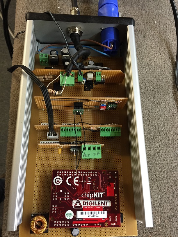

              Its all coming together nicely. At the moment I am only using a Chipkit UNO as my controller as its quick and easy to program but am going to change that soon to something along the lines of a Nucleo board combined with a 24bit ADC. I have made the whole test rig modular so I can change bits that dont work as expected.

              As for the GB not remaining exactly constant, I am incorporating an adjustable 'error' factor that can be used to compensate for things like that. I am hoping to have a full working prototype to take out to the property in Bendigo (lots of hot rocks etc) at Easter.
                I was just thinking its a pretty simple thing to take later GB samples and subtract them from their corresponding data points before I do the data point comparisons. Its just another few lines of code.
                The other thing this design incorporates is a variable constant coil current. The circuit all works but not sure of the real world applications yet but will be interesting to see what effect it has in the field.
                While I use LTSpice and lots of other calculations to develop ideas, I much prefer to do physical real world testing where there a few more variables in play.
                  The combination of modular construction and software provides great flexibility for your idea.
                  As you say, LTSpice is extremely useful for developing ideas. It also has the advantage that you can "blow up" the circuit as many times as you like, without costing any money.
