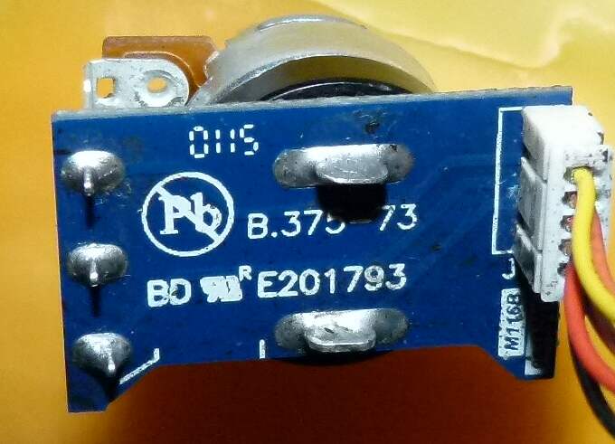

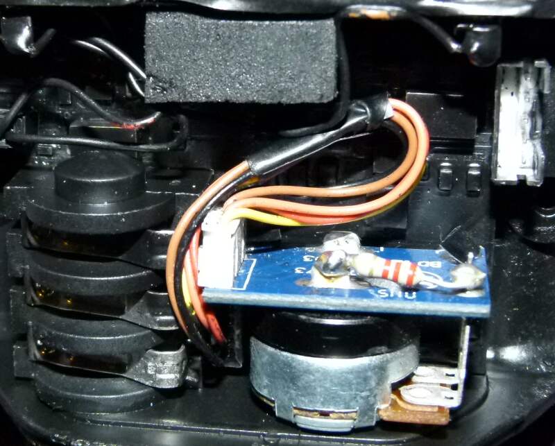

    moisture volume failure repair solution (solved)

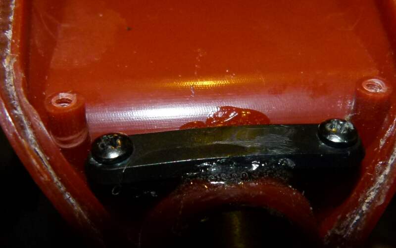

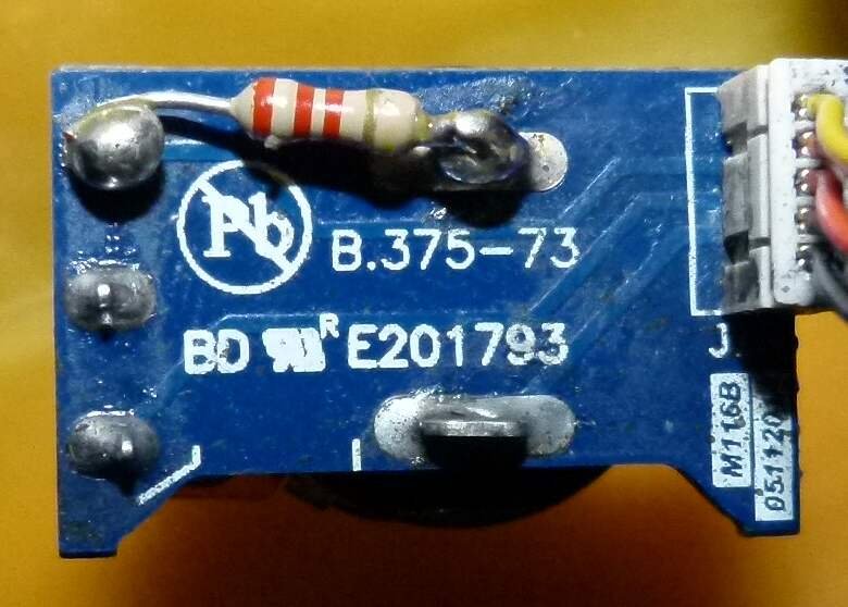

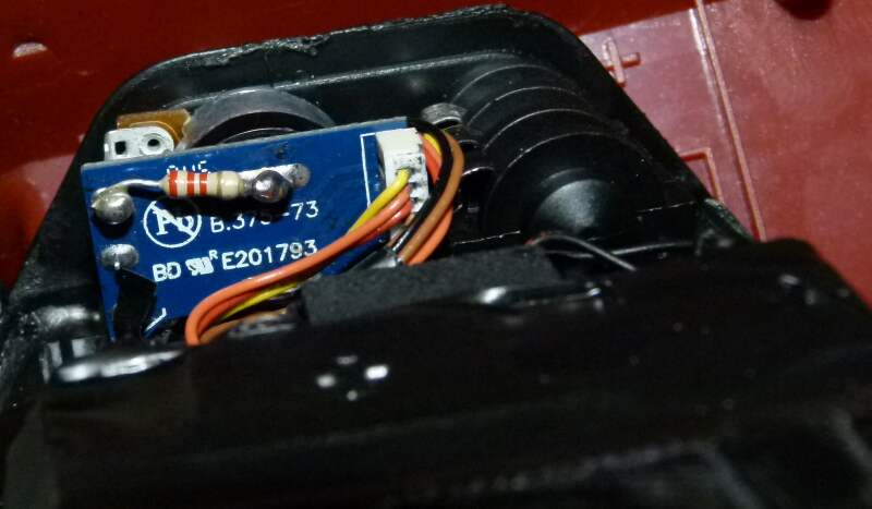

    Thx for your help, Skippy. This was real tricky, because sometimes the volume started to get
    loud again out of nowhere and then it went back to quiet again.
    Some sort of electronic-lose-contact, but not by cable or oxidated contacts! Crazy stuff.
    After some tests with the potentiometer I found out by chance that the volume gets back
    to normal - all the time! - after some 1-5k resistor was added! 2,2k Ohm was the optimal value.
    In the beginning I thought that water created some rusty contact inside of the poti,
    but this wasn't the case. The poti acts now with the 2,2k resistor complete normal -
    from quiet volume to pretty loud and both channels - speaker and headphone.

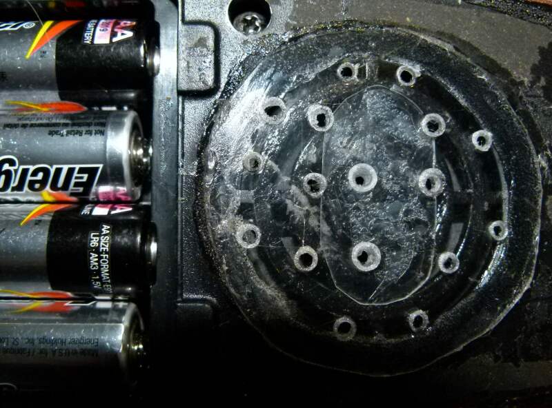

    But the speaker will get real quiet if some thicker plastic-sheet was glued over it.
    So some air-holes are a must and are also better to save battery-power,
    cause that way the volume just has to be turned up a little bit.
    2-3 stripes of duct-tape over it and it should be water-proofed enough.

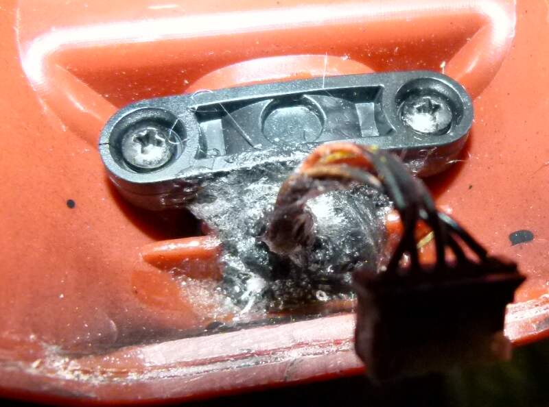

    And I found another 2 holes where water could come in (see pix below).
    This is where the pole gets attached to the plastic.
    Water-resistant but not too strong glue is the solution!
    Not too strong so everything is still openable if it should be needed.
    So don't use super-glue to make this housing water-proofed.
    btw. I have covered now the complete PCB with black color-spray - both sides!
    Creates no electrionical-problems but helps to keep the moisture away!

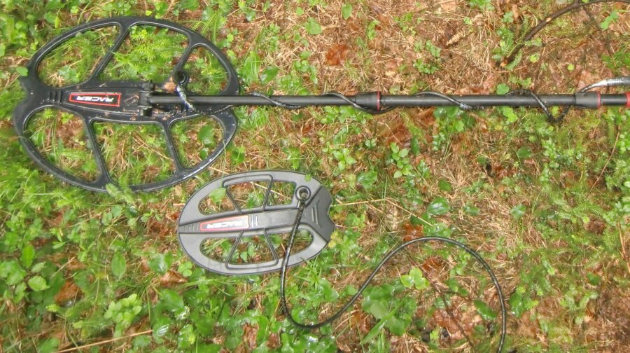

    What's now is still missing is a 66cm (2ft) coil, ultra-light-weight!
    Because those real deep 1m coils are not that easy to handle
    and for most treasure-hunters too expensive.
    Some 55-60cm coil also would be already a very good step forward.
    Per instance 2 days ago I found a 1 pound cannon-ball 300 meters
    further away of an already very far away know find-region!
    Without a real large coil someone simply can't handle such huge distances and areas!
    Especially those far too many and stressing sweepings with small coils (25-30cm)
    can became very annoying after a short time - much more than the coils weight.
    But for the moment I'm really happy with the Makro Racer and that there is
    a 40cm coil available! Compared to the also very deep CoinFinder CF77 it's now
    much easier and better adjustable with its LCD-screen and all the additional features.

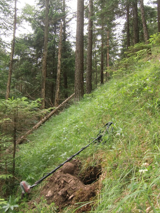

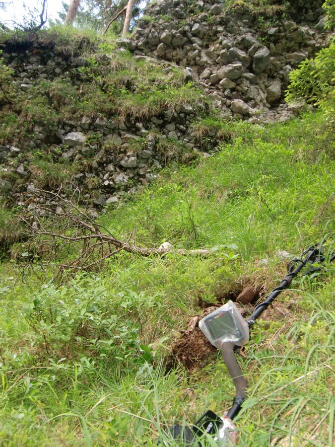

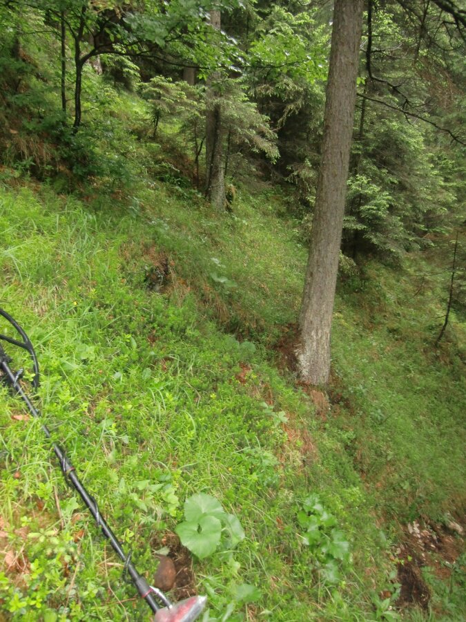

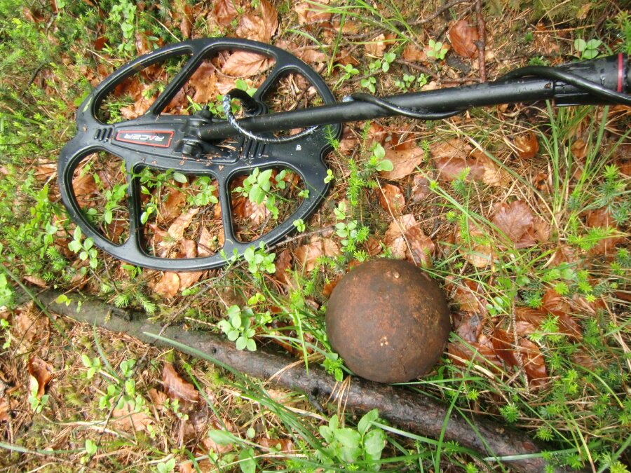

      Within a few days I found already a second cannonball with the Makro Racer,
      but this time by vibration.
      I was hunting at a very steep forest-region where it's already without
      detector problematic not falling down.
      But with the 40cm coil I searched through ten-thousands of square-meters
      in a pretty short time thats why its possible to make such finds!
      A 66cm coil even would be better.
      The sensitivity (gain) was set to just 37 because of nearby big electricity-lines
      but it was still powerful enough to sweep very fast 10cm over the floor.

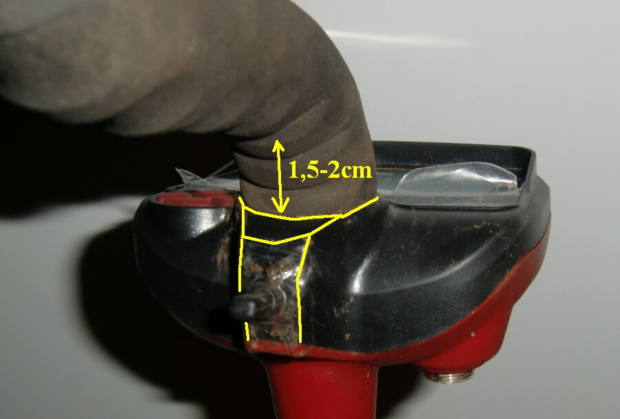

      The grip is to in-ergonomical. The forefinger gets pressed into that
      space where the pinpoint-switch-plastic directly is nearby.
      This is a little bit uncomfortable and should be improved.
      And the plastic of the battery-unit also should be made broader so the
      detector will stand more secure on the floor and doesn't falls to the side.

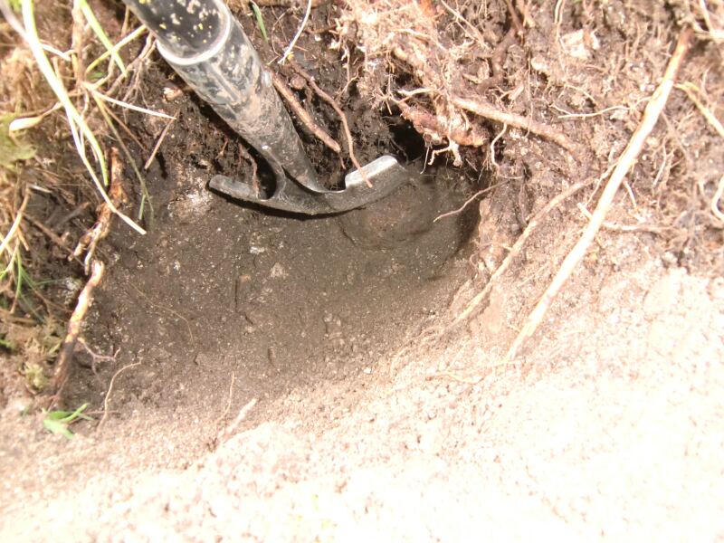

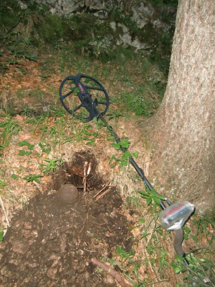

          And exactly the next search day (with 1 day rest inbetween) after the above find I got
          already the 3rd cannonball with the Racer!
          Again at the same steep forest region and by vibration while have some drinks and listening
          to loud rock music! The center of the ball was 60cm deep while the signal still was very strong.

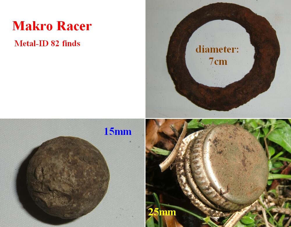

          btw. the Metal ID of such larger cannonballs is around 60.
          Of course if somebody uses the vibration in All-Metal Mode there is still the
          possibility of discrimination - because here the Metal ID works well and a
          fast look to it will decide if a target is interesting enough to dig it or not.
          Per instance stuff from Metal ID 15-25 is iron and depending on the size of
          the signal it can be ignored while hunting for all the more better stuff, first.
          Rusty empty rounds from 2nd Worldwar show up with ID 19 and you won't find them all.

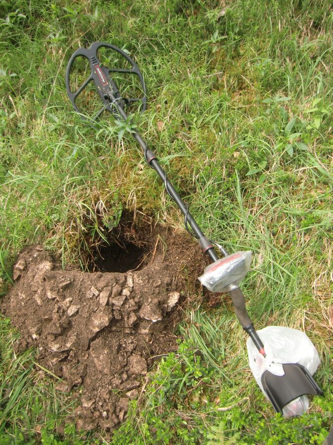

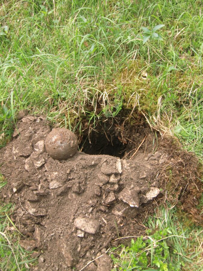

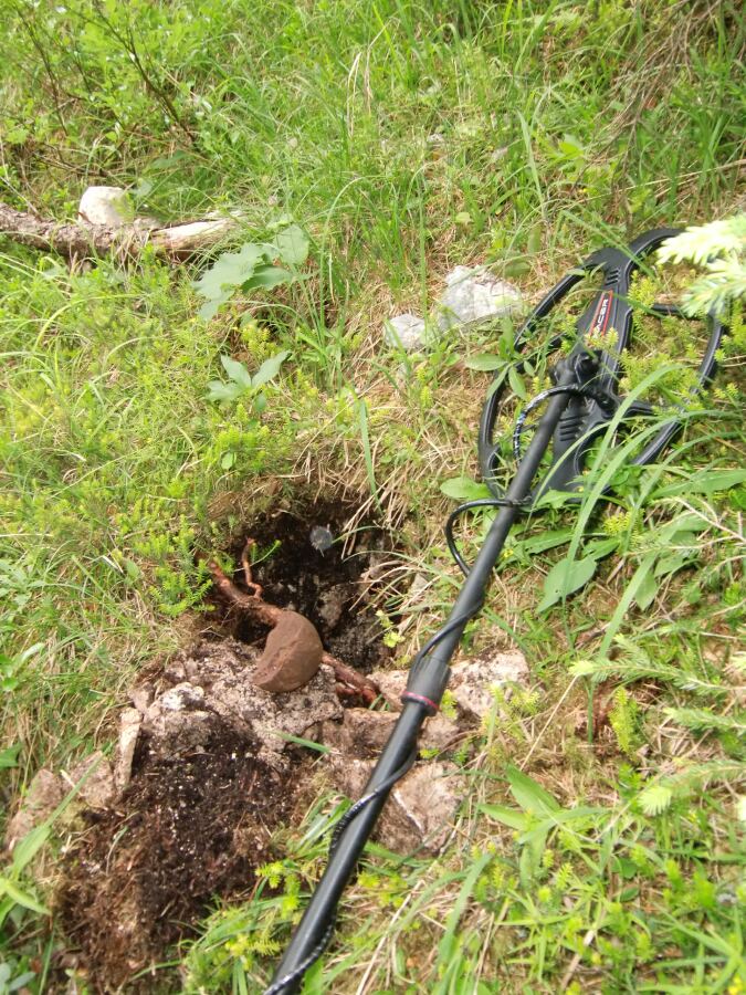

            Today I hit the jackpot - found 1,5 cannonballs and the half one
            is exactly half - and broken by stonewall-impact.
            btw. the new cannonball represents a cool celebration number - which is higher than 10.
            This was only possible because of the lightweight Makro Racer because
            I'm hunting for this stuff at some very steep mountain region.

                  Of course detection-work not always is just a walk in the park:
                  After digging a deep hole at high mineralized ground for nothing
                  I found out that the very high standard GEB value of 90 especially
                  at loamy and hot-rock-regions really has to be changed to alot lower!
                  Otherwise it is even possible that the mineralized ground creates
                  repeatable signals incl. metal ID at ca. 40 - perfect fake-finds!
                  Of course its also my fault because sometimes listening to very
                  weak signals could be everything and is not simple to pinpoint!
                  It could be an 1m deep 10cm thing or it can be a nail at the side
                  of the hole that is 20cm deep but because of its direction it
                  get's detected 15cm offset!
                  However - the solution is simple:
                  Manually change the Ground-Setting to zero and if the signal no
                  longer exists, it was just the special ground-formation itself.
                  So please don't get scared off the Racer just because I'm writing
                  about digging some empty hole, this can happen with every good
                  and sensitive detector if the coil is bigger and the ground contains
                  high mineralized pockets of loam or hot rocks etc.
                  Picking up very deep signals also sometimes needs alot experience.
                  It is no failure of the Racer, because it even can detect mineralized stones
                  if used correct - even very small meteorites pretty deep if the soil is ok.
                  Of course this way the GEB should be set to ca. 20 or something.
                  If the GEB is set as default to 90 this is the optimal setting for silver
                  and valuable metal at very low mineralized locations.
                  No wonder it will create failure signals if used at very high mineralized soil.
                  But if someone searches for very deep iron or steel artefacts or relics
                  he will get the best depth everywhere if the ground-balance will be just
                  at around 35-50.
