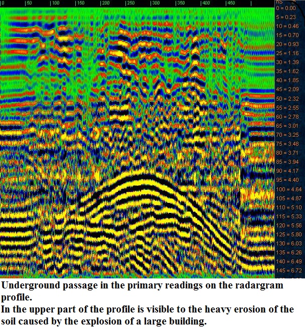

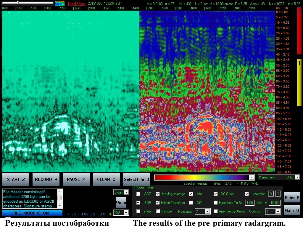

              2. The visual output of ground radars (30-300 MHz wave reflectors)
              is far away from 90% reliable! I would give them a 40-60% rating.
              They output all kind of crazy wave-lines on the screen and if those have
              been caused by different-soil-layers or rocks and you interpret them
              wrong you may end up digging 5m deep holes for nothing!

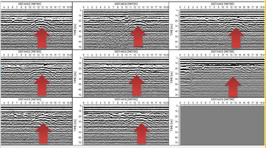

                      the test-reports here:
                      http://easyrad.de/pages/produkte/testberichte.php
                      show those usual GPR zig-zag curves and grey wobbles (also see attached pix)

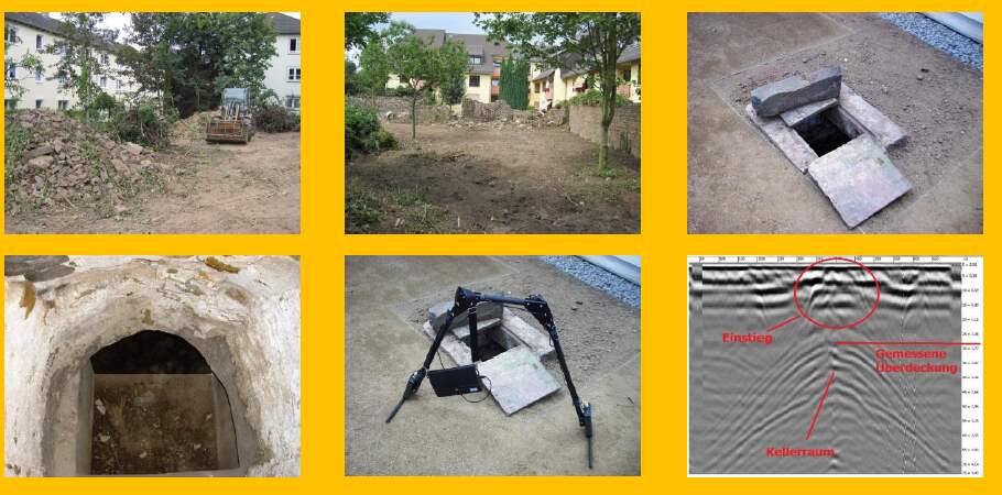

                      If someone already is pretty shure that there are massive structures under ground its ok and working.
                      But out in the untouched fields or woods or at larger areas?
                      And I can't find the info if its possible to look directly at the output-info-monitor while searching.
                      Even that massive cellar just gives a pretty weak signal distortion impression.
                      I'm shure that already different layers of soil or humus will cause special patterns which
                      easily can be misinterpreted.

                      A little bit problematic is that cavity does not shows up as black or white space
                      but only the walls create the reflection-distortions.

                      Would be interesting to see what it detects if somebody walks over the
                      streets of a city! The underground cables, the canalisation, roots of trees,
                      cellar-rooms, lines where are pipes etc.
                      Or at old ruins or castles to check out where are the cellars, hidden rooms or bunkers.
                            On YouTube there are several interesting videos on the topic. Unfortunately only in Russian.
                            For example
                            https://www.youtube.com/watch?v=cVIEe-0li40
                            Amber on the poligon GPR copy.
                            3D animation model built based on the result of the ground penetrating radar probing of a water channel:
                            http://easyrad.com.ua/tmp/3D_Olshanka.gif
                            View website
                            http://www.easyrad.com.ua/index.php?r=index_en
