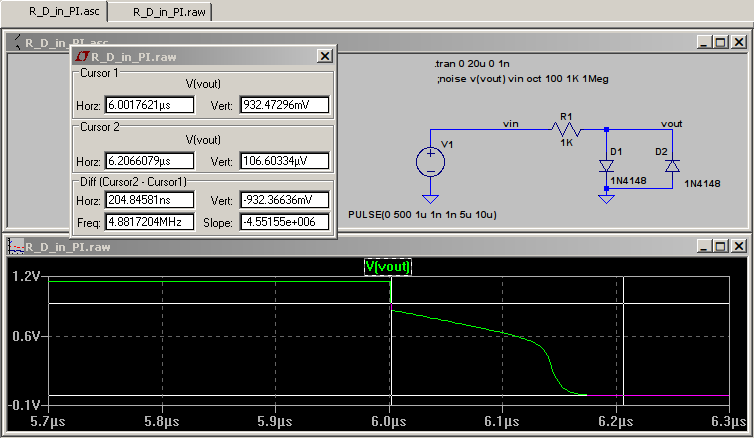

    First, let's talk about the resistor-diode clamp. No, it doesn't play a big role in sampling time; a 1N4148 has a depletion C of about 5pF, so 2 diodes are 10pF; with a 1k resistor this is a 10ns time constant.
    The diode's recovery time is 10 x that when the input signal goes into the millivolts.
    For example, a 500V pulse takes 130ns to reach 0.5V at the diode and 200ns to reach 0.1mV.

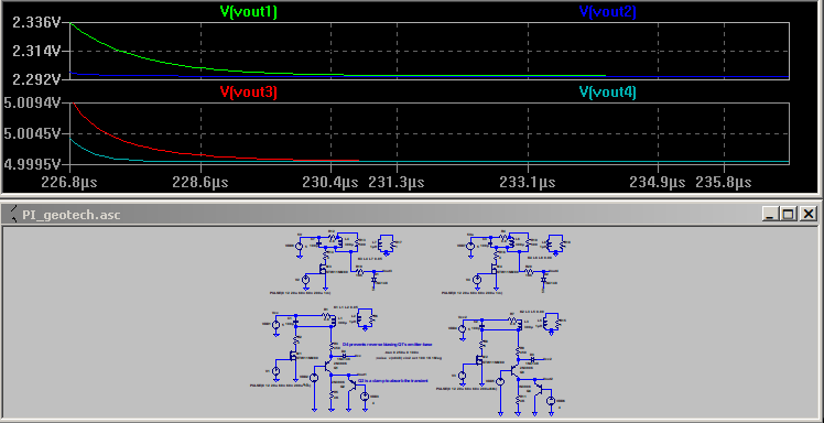

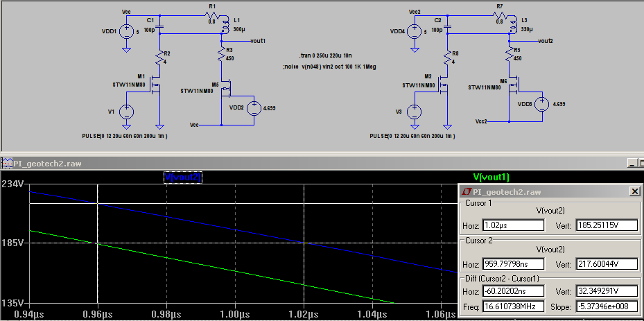

    In the example below the traditional approach (bottom graph) produces 1.7mV while the signal's own current, when transferrred to a 4K resistor, produces 17mV 250ns earlier (top graph) :

      I think you mean increasing the damping resistor to account for the presence of R in parallel. But then when the signal goes below 0.5V the diode is blocked and the circuit goes underdamped (oscillates) .

      Inductance changes over ground, which changes the transient curve. A fixed delay will not work, but a voltage dependent delay can fix this. It's easy to implement using the Id/Vds curve of a MOSFET. For a given Vgs, when Vds > Vp (saturation) the resistance is infinity, for Vds < Vp (ohmic region) the resistance is a fixed value. Vp is low (about 0.2-5V) and the transition is abrupt.
      Wth this technque, a variation of 10% in the inductance causes a mere 60ns difference in the delay.

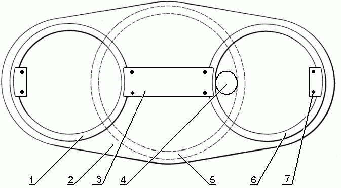

              In the attached patent address the DOD receiver coils are in series instead of opposing polarities as in MikeBG’s proposed arrangement. It would be interesting to compare the two forms. The MikeBG method might require more turns in the receiver coils.
