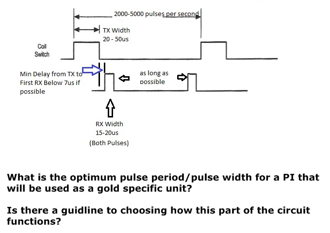

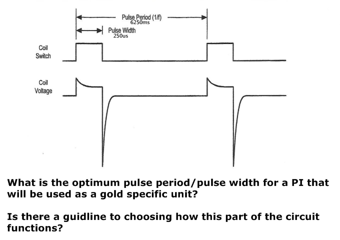

    A question that may have been answered before or in a book somewhere but I'm unable to come up with a definitive answer to get a better idea of a starting place. I have been experimenting and have been wondering about this and wanted to get others opinions or from an experienced engineer in this particular matter.
    See image for clarity of question. And thanks in advance.

    That depends on your intended purpose.
    The coil charging period should ideally be of equal duration as all the samples in case you are up to ground balanced PI. Otherwise it may be shorter.
    If you wish to implement EF sample the period becomes long. But with bipolar pulsing you don't need EF.
    etc.
    The bottom line is that you get the most out of a PI if you can pack a total period tightly. It improves S/N

      Pulse period for PI:
      The shorter the pulse period, the more samples you can integrate for better S/N.
      The pulse OFF time should not be much shorter than 1TC of your longest TC target.
        Hmm these answers don't really answer anything. I believe we wish to find a sweet spot for
        pulse width and rep rate.
        The pulse width will affect the size target you can see. If your looking for 1 pound of gold a long
        period would be good (1US?). For small gold a smaller period would be best (50 us?).
        A fast rep rate will allow you to see those tiny traces from the small gold (a chain looks like one
        link!). 1 khz to 5 khz will see those smaller targets better than lower rep rates.
        So if you are looking for small gold try 2.5khz rep rate with 50 us TX width.
        For those 2 pound bars try 500 hz rep rate with 250us TX width.
          Here's my take.
          1. Use current-mode drive, separate Tx and Rx coils.
          2. On-period: 50us, off-period: 950 us, repetition rate: 1 KHz.
          3. Sampling after the rising edge sees all targets with taus from 0 to 950 us.
          4. Sampling after the falling edge sees taus from 0 to 50us.

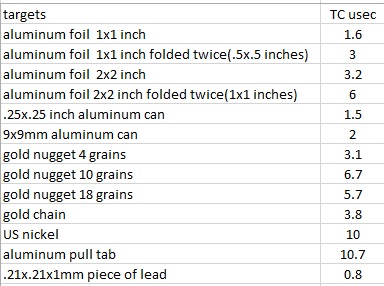

            Time constant (t) in engineering generally means a time when a variable changes 63% to final value; generally 5 time constants are expected for a full change (rise, or fall). For non-ferrous metal targets this is inductive-resistive time constant, t=L/R .
            Highly conductive targets such as copper, aluminium, silver have a longer time constant and poorly conductive targets such as gold have shorter time constants. For ferrous targets the time constant is aided by stronger eddy current formation.
            Rings and other "easy" shapes have longer t even if the material is difficult because of relatively large resistance.

                I've done a little reading and found out some info.
                For small gold use 50us TX width. For best on all objects use 100us.
                For gold the shortest delay you can get. Small gold is in the 5 - 7 us range.
                For the beach 15us works good.
                The RX pulses are usually 20 - 30us. And delay from 1st to 2nd 100 - 200us.
                The Rep rate affects response speed, current consumption and noise. I'm not
                sure on this one but faster seems better as long as you have the battery power for it.

                    Well the TX pulse width chooses the size of the target somewhat. A 1000us pulse is good to find cannon sized targets.
                    Large object Deep detectors use long and slow. 100pps rep rate 500 - 1000us TX.
                    A longer pulse will allow the coil current to get to max and stay there for some time so available power is a concern
                    and wire size to handle the peak power. Most wire companies have a chart of current to wire size. AWG 16 can do 22 amps.
                    http://www.powerstream.com/Wire_Size.htm
                    A problem to consider is that a PI can see the wire once it gets to a certain diameter
                    (though may ignore it if your delay is longer to see large deep stuff).

                          For small gold everything should be short and fast. 20 - 50us TX
                          2000 - 5000 rep rate and 15 - 20us RX pulses. The first to second
                          spacing should be as much as you can do.
                          Here's a picture of good settings for small gold;
Name:	pulse period2.jpg
                          Here's some target time constants;
Name:	target time constants.jpg
