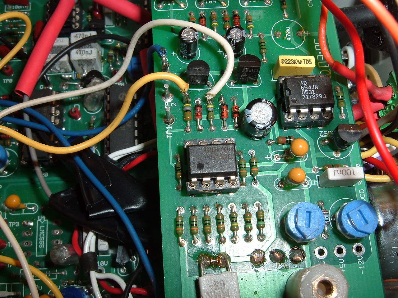

    Has anyone got a schematic of the audio section of the gold scan 5....also i noticed there is a mod for a switch for high & low or all tones...how is this mod done ????

          how are you doing ??? is the GS 4 audio the same as GS 5....can the GS 4 be converted to have the high & low switch with two different tones ????
            If you want to add a simplified hi/low conductor switch that acts much like the one on the TDI, you can do what I did on the original GS 5 and that is, add a 2 position switch, center off type. Center leg will connect to the GND connector on the audio board (blue wire on the pic). The two ends of the switch will have a wire that will also go to the audio board and connect as shown in the attached pic. The two wires are a white and a yellow and each will connect to a resistor being careful there is no shorting to other parts.

              for change of tone of VCO you can change ANY value of R and C, it is rule.
              but GS5 sound is not same like GS4. GS4 sound is fully similar to Delta Pulse sound (how i see in youtube).

                        Thanks for posting, Reg. The image shows an AD654. A quick look at the datasheet states its a voltage to frequency converter that outputs a square wave at up to 500kHz.
                        http://www.analog.com/media/en/techn...eets/AD654.pdf
                          image shows deleted NE555 from the main board. probably it was VCO. VCO is done at subboard, yes.

                            Thanks for the picture which makes things somewhat clearer...i wonder has anyone made a GS5 as a project...i think they are so expensive to buy second hand and rare to buy...i would love a GS 5 or TDI but at present cannot afford one....
