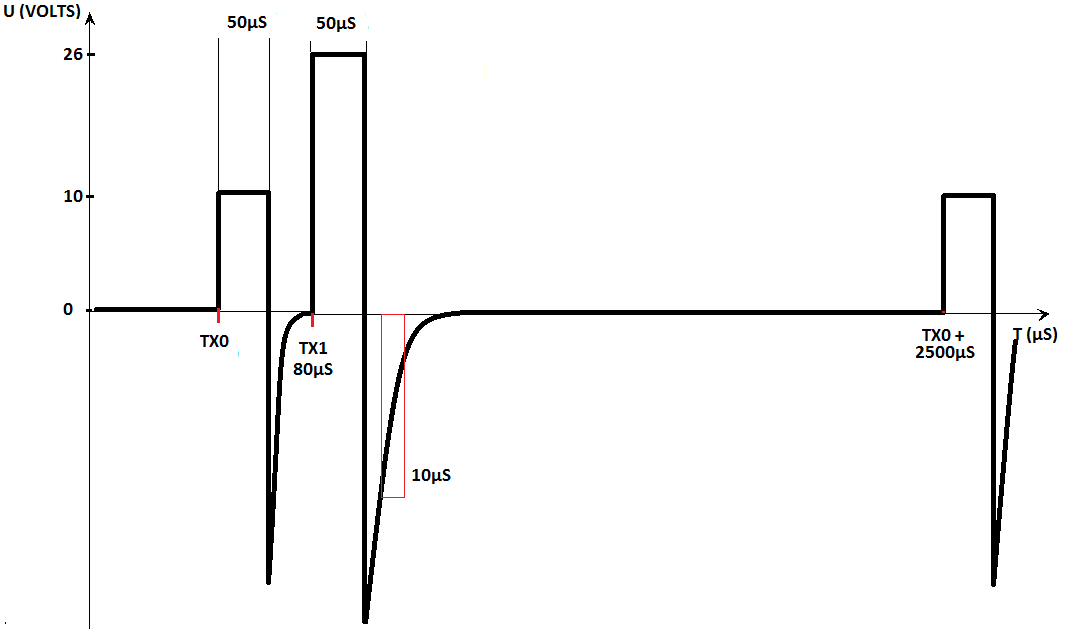

    I would like to have your opinion about my idea :
    I want to build a double pulse PI MD. The second pulse would be few microseconds after the first one.
    I don't know what would be the effect but i hope it would increase the eddy current of the target and maybe help for ferous/non-ferous detection ?
    What do you think ?
Name:	Double impulsion PI.png
    Hate to say, it would probably weaken the target response.
