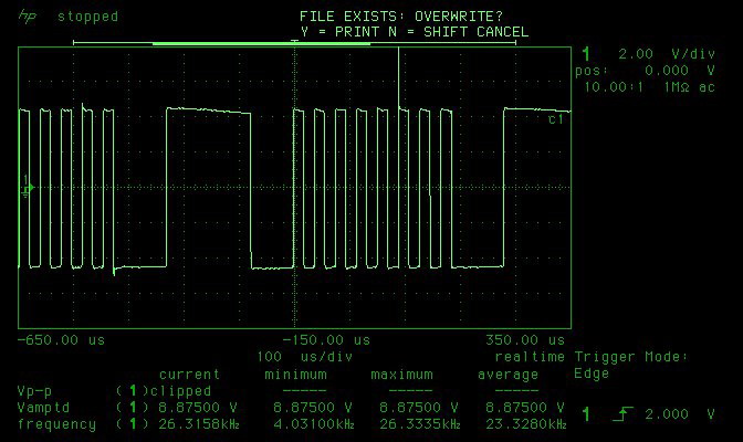

    this pic line 'a' is OK for you? has BBS coil current another form?
    • What you show is for a traditional PI. BBS/FBS is entirely different.
      • are these pics OK for you? (voltage, NOT current)
        Как мы видим подводимый к ТХ катухе сигнал представляет собой дискретную бинарную посылку.
        Обратите внимание на картинку ниже, пачка начинается длинным импульсом затем идут 7 коротких с частотой 25 кгц которые заканчиваются опять же длинным импульсом, далее пауза и опять посылка.
        Парамметры:
        Размах сигнала- 10 вольт (+-)
        Общая длительность бинарной посылки 470 мкск
        Начальный импульс длительностью- 88 мкск
        Далее подряд идут 7 иипульсов длительностью по 20 мкск, пауза 20 мкск = 25кгц
        Длинный оконечный импульс 88 мкск.
        Пауза перед следующей посылкой 176 мкск.
        Несколько пачек подряд.
        Одна пачка.

        • and this
          • As we can see katuhe supplied to the TX signal is a discrete binary package.
            Note the picture below, the pack begins long pulse followed by 7 short at a frequency of 25 kHz which end again a long pulse, followed by a pause, and again posting.
            Parammetry:
            Swipe SIGNAL- 10 volts (+ -)
            The total duration of the binary packages 470 mksk
            The initial pulse dlitelnostyu- 88 mksk
            Then go straight 7 iipulsov duration of 20 mksk, pause 20 = 25kHz mksk
            Long terminal 88 mksk momentum.
            Pause before sending the next 176 mksk.
            ...it says voltage in the translation.
                Yes, those are BBS/FBS TX voltage waveforms. Now, what does the TX current look like?
                I beg to differ. As the Rx is a voltage sensor, it is voltage that is mostly relevant. You could try a transimpedance preamplifier to get into the current ballpark, but let's not promote confusion.
                Transmitted magnetic field is directly proportional to the TX coil current. Everything else follows from that.

                      Looking at the TX current instead of the voltage better reveals what the heck is going. Just look at the confusion over BBS, and how many people think that just because the drive voltage is a kind of square wave that it must be a type of PI. When looking at the current, it is obviously not. Yet in another design, a similar kind of voltage waveform might produce an obvious PI-style current.
                      Another good example is the GPZ, which a lot of people call a VLF. Yet the TX current suggests is it way closer to a PI.
                      • For those still interested in what BBS/FBS is, here is the voltage & current waveforms:
                        I've posted this a few times in the past but it doesn't seem to make much of a lasting impression. Look closely at the current waveform... see any 'off' time? Pretty continuous-looking, eh? This is why I posted that 2-frequency sinusoid and asked what is it? and how would you process it?
                        P.S. -- if you think my Visio art might not be an accurate representation, I've also measured the waveform with a current probe on an oscope. Same thing.
