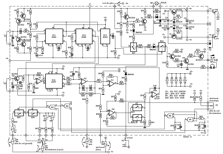

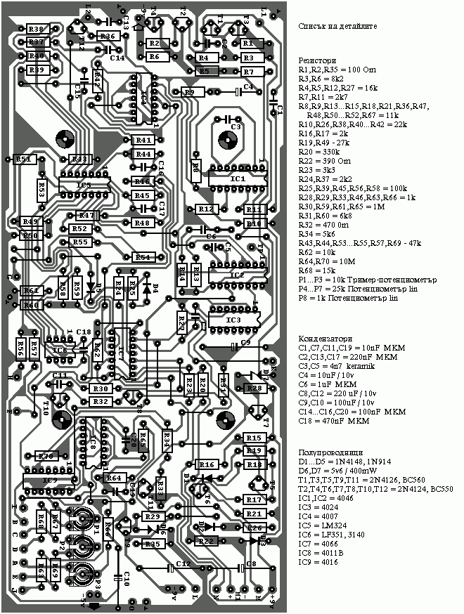

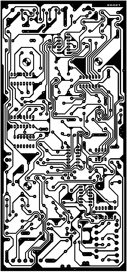

Good Circuit and PCB for MD Elector
  • Good Circuit and PCB for MD Elector

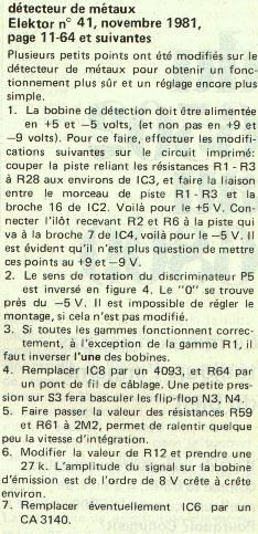

      And the corrections...
