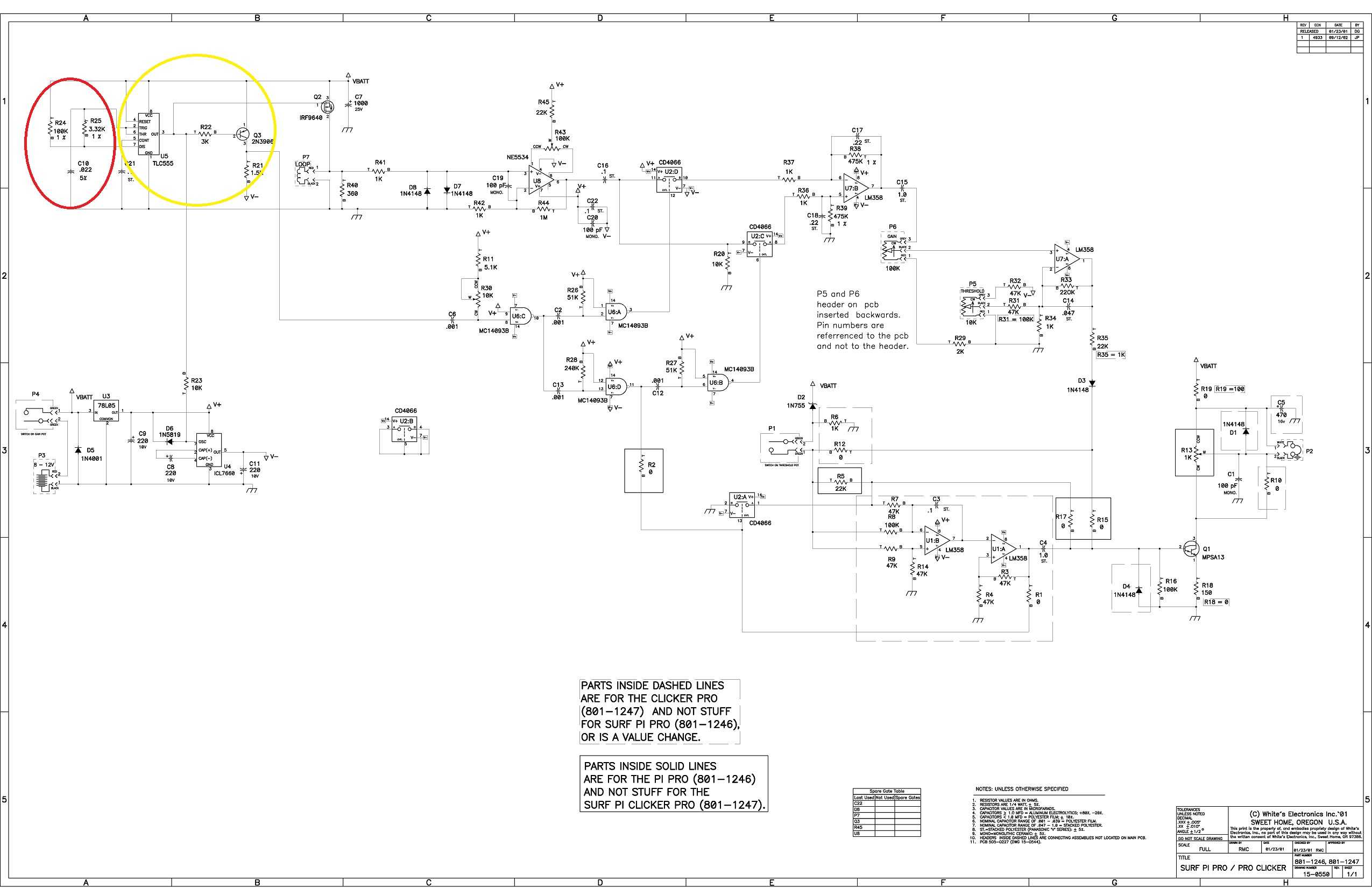

    Hello everyone.
    I just finished surfing the PI kit from silverdog and I have a problem . I have set the offset to zero, but it sounds continuously and irf9640 transistor is very hot.
    Do you have the solution to this problem?
    could I forget something?
    Thank you in advance.
    PS : Sorry for my poor english, i'm french
    A hot FET means the frequency or duty cycle are incorrect. Check the components in the red circle.
    If they are OK look at the ones in the yellow circle;

      Hello and thank you for your response.
      Curiously, in the Partlist I did not R24 , so probably an oversight on my part and R25 and R22 do not have the same values ​​that the scheme .
      Small question , the surf PI 1.2 and the surf PI Pro are there the same ?
      For my part , I will look more ready and keeps you informed of the progress .
      Big thanks.
      Regards.
        Hello everyone.
        I think I found the problem, and it is huge !
        After examination of welds on the circuit, I found that both legs of coil were soldered together !
        I think I had to burn anything around !
        I recovered all that and you want to know.
        Thank you.
          Problem solved, that was it !
          Although check your welds in the hope that it may serve to others who have encountered the same problem
