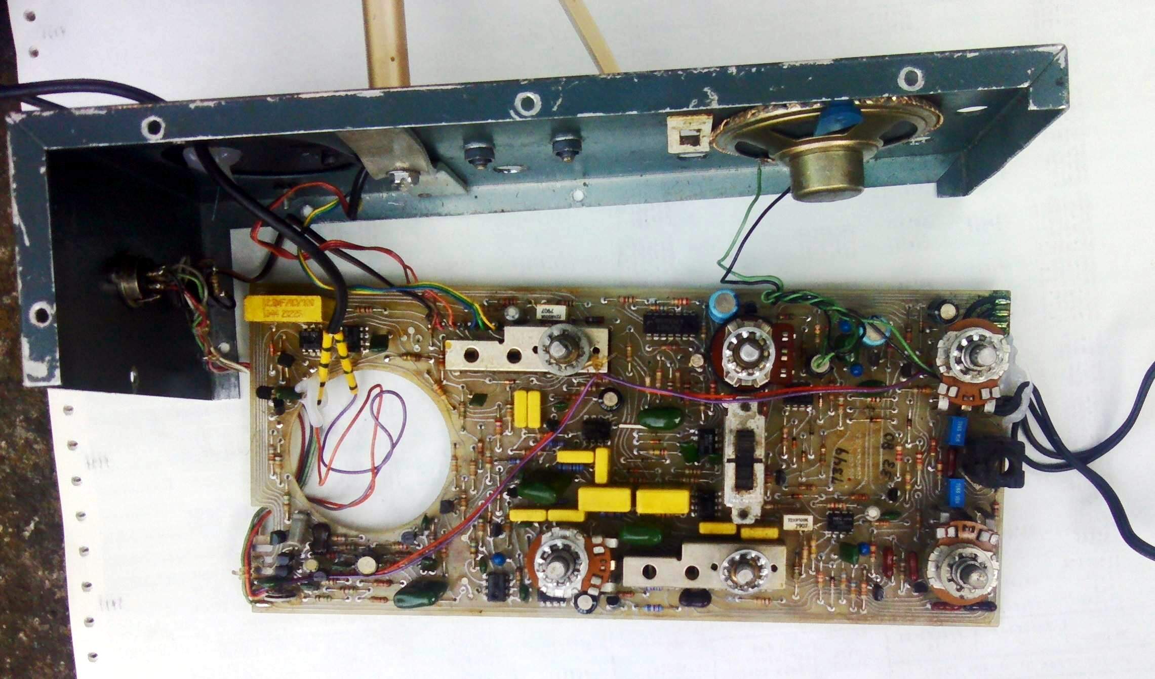

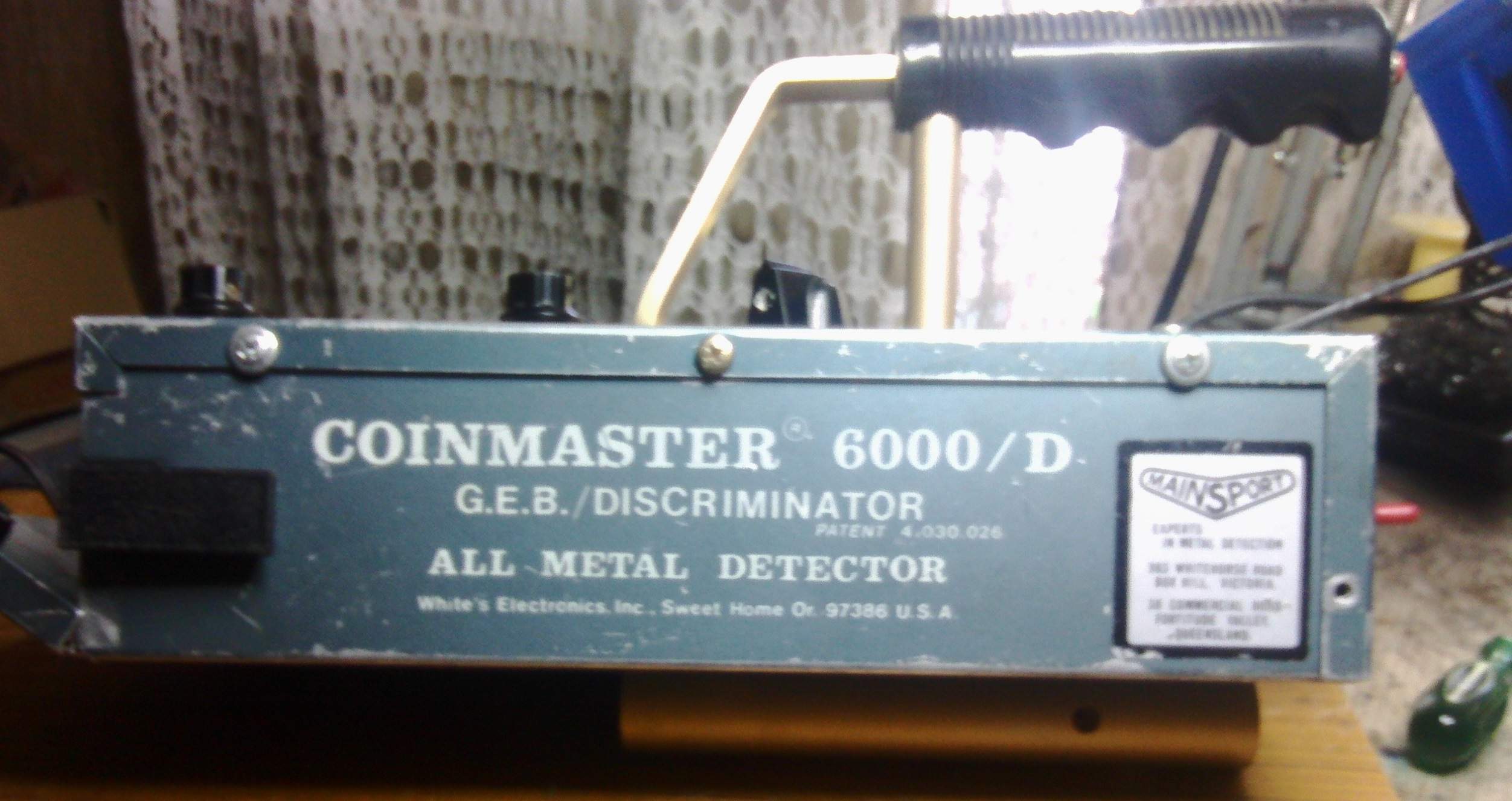

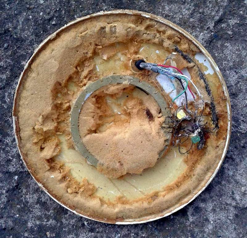

    I need help here. I need coil specs for this one.
    Its schematic was posted already on these forums.
    Coil is somewhat specific and differs much from common White's coils.
    This oldie needs a coil since original one is completely destroyed.
    Any info about original coil will help, inductance, resistance...

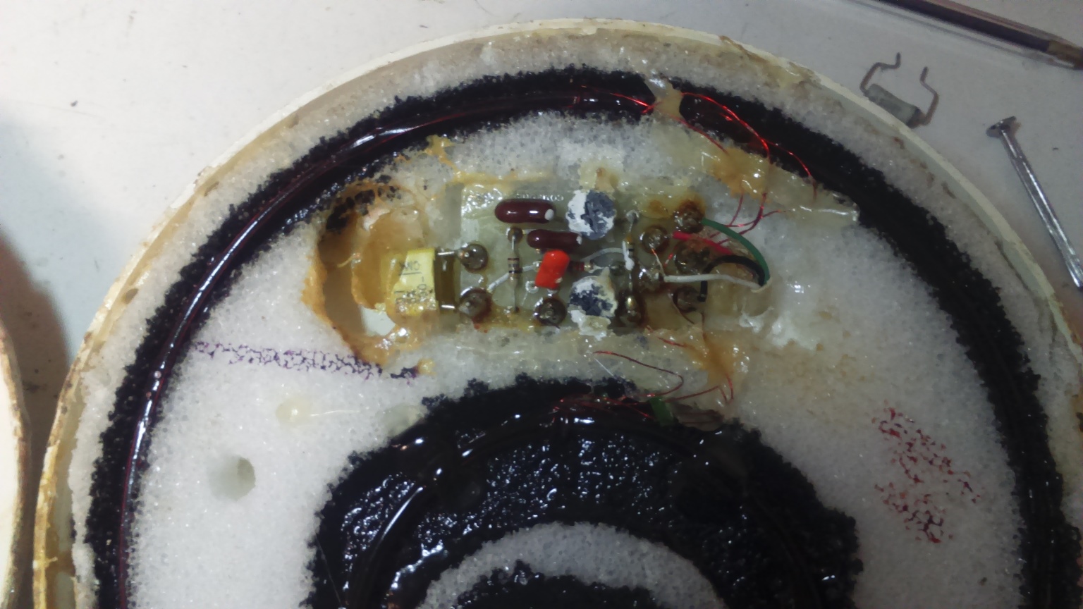

            If i remember good it is a Omega coil
              I"ll post photos at afternoom.

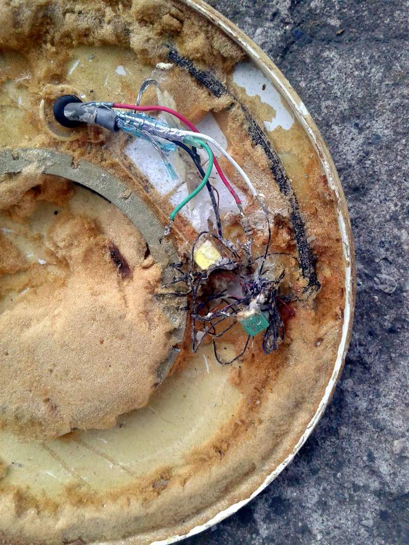

              It should be the Omega coil.
              But from the photos guy sent me it rather looks like concentric coplanar coil, though is hard to tell.
              Original coil is destroyed, now is impossible to distinguish it.
              I hope there are available data for this because it is very old design and obsolete.

                Idea is to make larger coil for it.

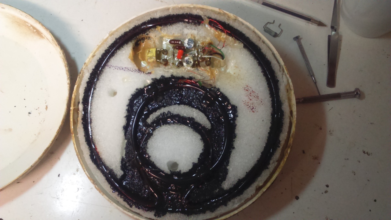

                    Take some photos for the time.....

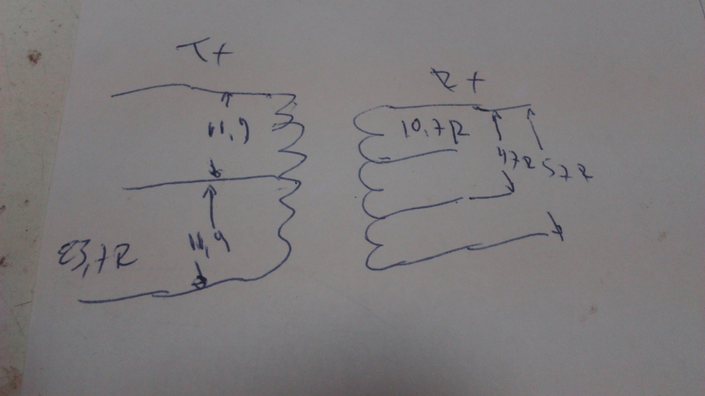

                    Also the resistance of windings.
                    Sorry but i had not enought time to desoldering the wires from pcb and measure the inductance. Maybe at afternoom ot tommorow.

                        Isn't it the same as the standard Classic I/II/III which is different to the IDX and Plus.
                          Ivica read....
                          Because i forgot the page that i have draw down to lab i say you only the inductance.
                          So... for Receiving coil L1 = 1.34mH and L2 = 1.34mH. Rx coil is two simple coils in series (2x1.34mH).
                          Tx coil.... L3 = 1.9mH and L4 = 1.9mH. Tx coil also is a omega coil with a center tap (2x1.9 mH).
                          If you need the diameter of coils i can measure them tommorow.

                            Ivica read....
                            When i"ll visit your city you owe me a beer .....
