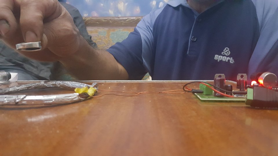

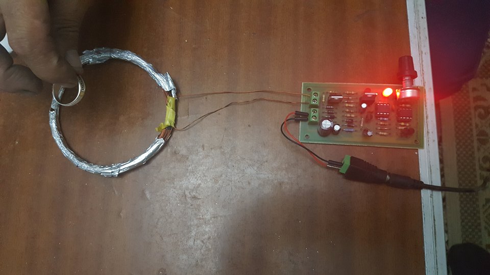

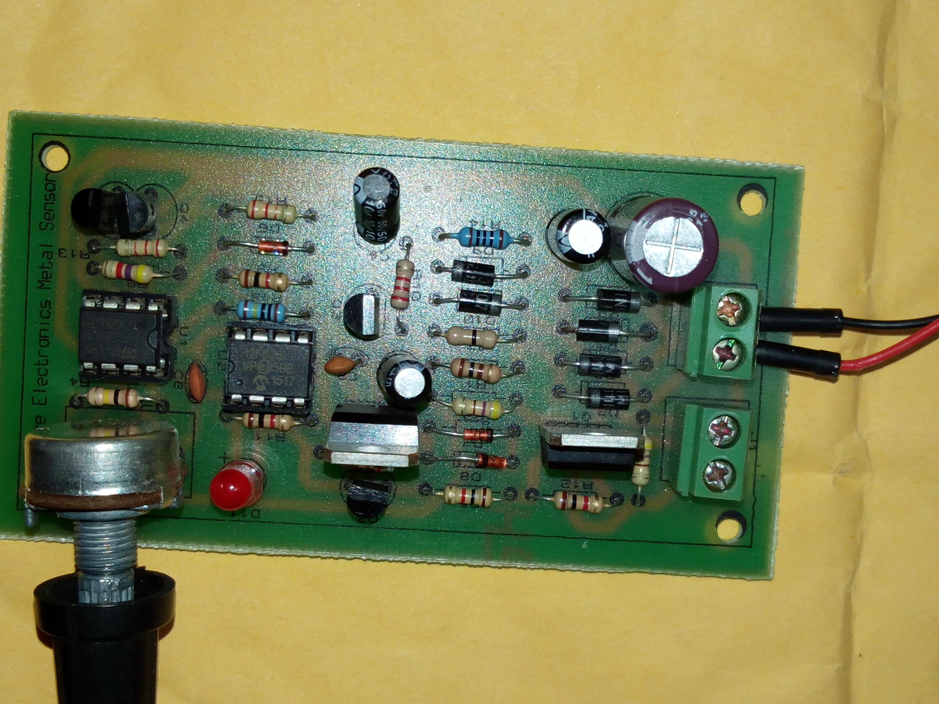

    Is it possible to installation phone instead of Lod and how PleaseClick image for larger version

    Probably you mean LED not Lod?
    Try with active piezo summer according this schematic:
    https://wiki.forth-ev.de/doku.php/pr...pietzo_speaker
    You can retain LED diode and take signal to connecting point PB5 from hot side of LED diode
    or make LED protection resistor as voltage divider (trim potentiometer) and take signal from it..
    Transistor could be BC547 too.

      Thank you Yes I mean led
        You are using too much alu foil coil shielding, Hammerhead.
        This can reduce depth alot.
        And you also can attach a vibration motor like used in cell phones
        instead of the LED because the voltage is pretty the same.

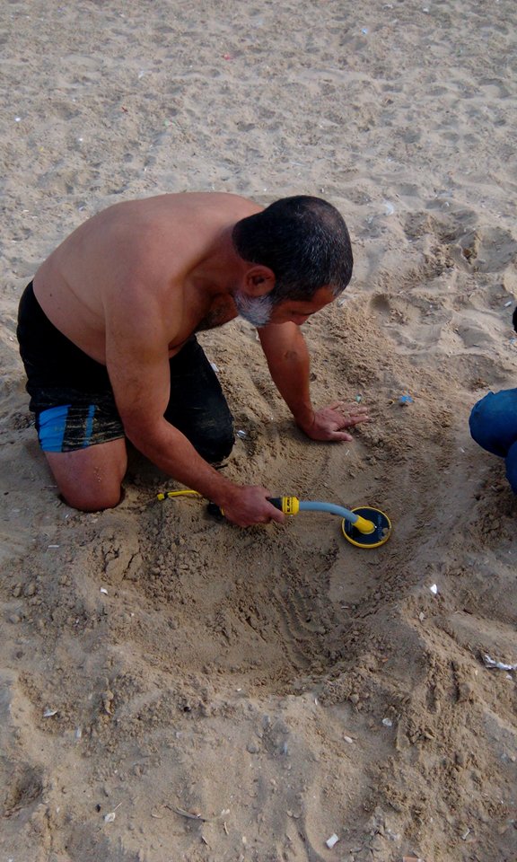

            Thank you for the compliment, Hammerhead!
            You have it pretty warm in November in Alexandria when I look at this picture!
            Just joking!
            btw. funny coincidence - I'm writing about Omar Sharif and now I found out that it was born in Alexandria.
            I saw one of his movies a week ago: https://en.wikipedia.org/wiki/Monsieur_Ibrahim
            A beautiful movie with heart and wisdom located in Paris in the 1960s.
            Is this your P.I. pinpointer on the picture? Perhaps the coil can be made larger for more depth.
