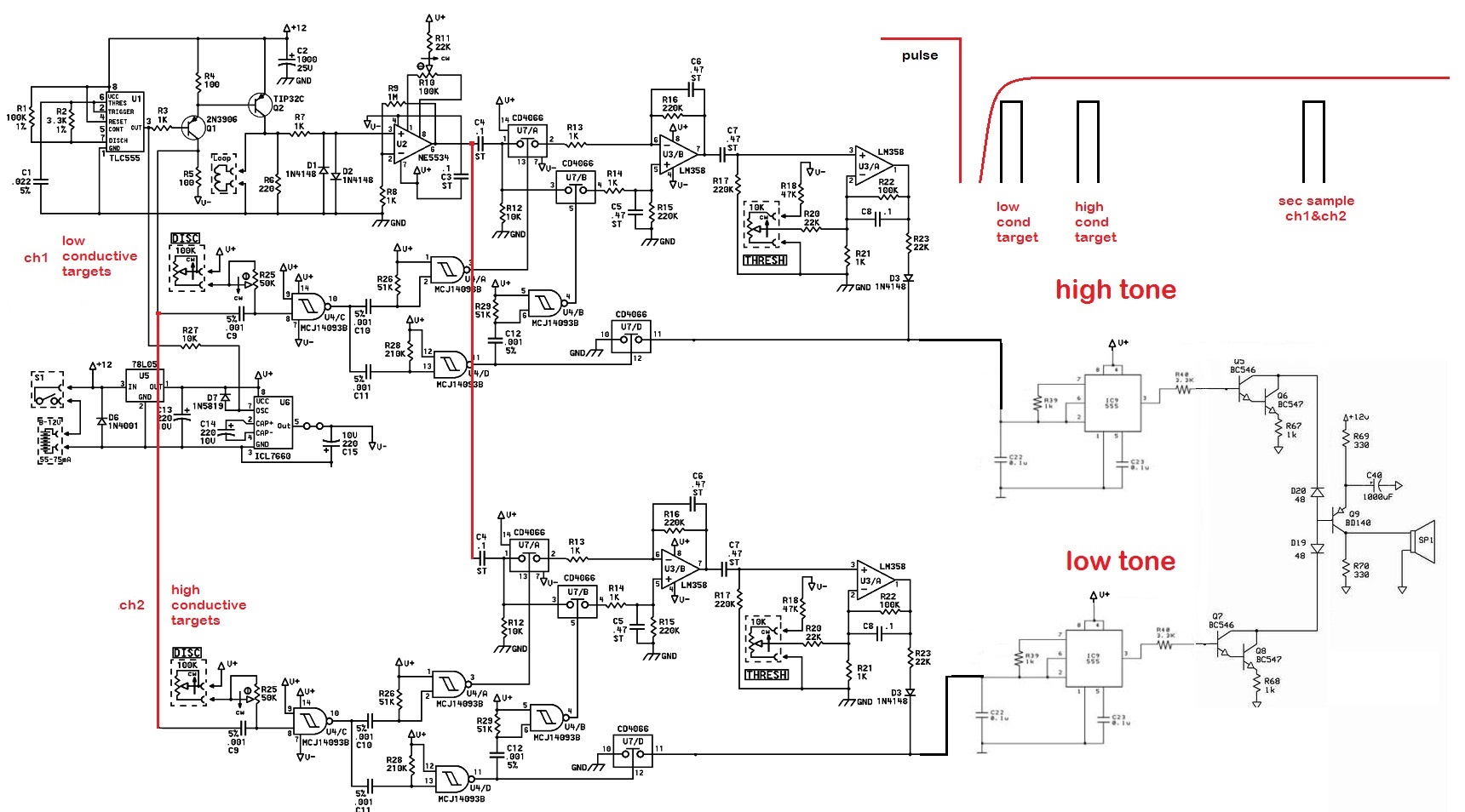

            I was thinking to make a pi same like you said, with another two samples to identify high conductivity targets or large targets, by using another chanel and at the output to use 555 for diferent tone. If target is low conductive you will get one tone, if is high conductive the second chanel will change the tone in the speaker. And you will decide if want to dig the high cond targets. Of course deep high conductive or large targets at first will give as low conductive, but if you start digging and get closer to it the audio will change to high cond.

                i came up with this example of surf pi, what do you think? i'm not so good with theory in electronics, my brain does not support to much information )
                ch1 will be actualy allmetal and when big metal will come as a target the output audio will be mixed.

                  Have you done any experimenting with this circuit ???? my brain the same cannot process too much information...i just do things by trial and error...i did once modify a hammer head circuit so the vco worked at much higher frequency ins tead of click click and i included also amplitude as well than pitch...i supprised myself at the time cause it worked.....but that project ive shelved for now and i tended to concentrate on the surf pi.....to be honest the only audio i really like the sound of is that on the whites tdi series...which i would have no idea how to implement....so for me the surf pi has gone as far that i can do with just the lcd meter.

                    no, i did not experiment nothing. now that good weather came up, i want to spend more time detecting and doing other hobbies of mine. I did build an surf pi and a baracuda pi but still need to finish coils for them (enclose). I found this interested thread but, same, did not tried. maybe in the near future.
