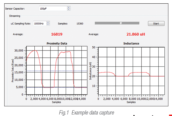

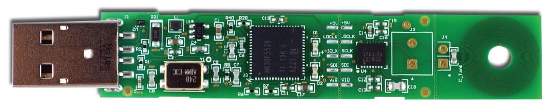

    I have just received the Texas Instruments LDC1000EVM. It includes a PCB with the LDC1000 inductance measuring chip, a printed coil, a USB interface and a GUI. It costs around €33.
    Quick Start Guide
    The LDC1000 drives a resonant circuit and digitizes its inductance (L) and its equivalent parallel resistance (Rp).

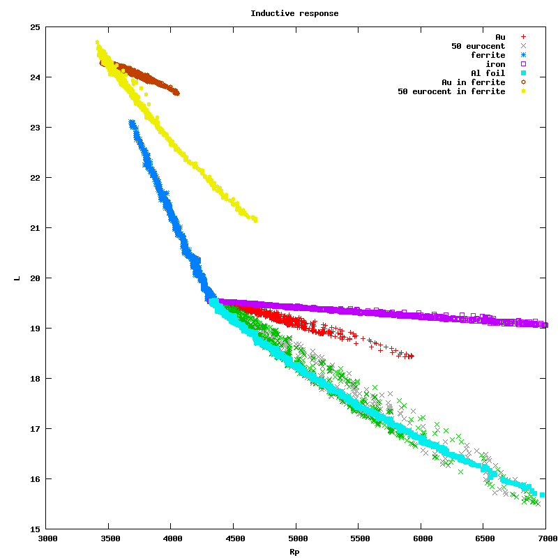

    I've been experimenting with a gold nugget and an iron nail. dRp/dL was much larger for iron than for gold. Experiments with ferrite provided the smallest dRp/dL, sort of a baseline to tell mineralisation from metal.

        The slope as you move the target is very good at discriminating metals and these from ground.

              Look at the brown and yellow lines in the graph, they prove it' s possible to discriminate even in highly mineralized conditions. Which present oscillator-based pinpointer does this?

                  No, I use the comma-separated capture from the GUI in a log file, extract the (Rp, L) pairs from the file and then pass them to gnuplot for display.
                  I move the targets above the coil up and down and sideways to acquire the points.
                  My goal is too see if it will be able to differentiate between a gold ring and a pull tab that share the same ID on my CTX.
                  The pull tab yould be the light-blue line, the gold ring the red line. Their angles relative to the center point (where lines converge) differ by a whopping 20 degrees.

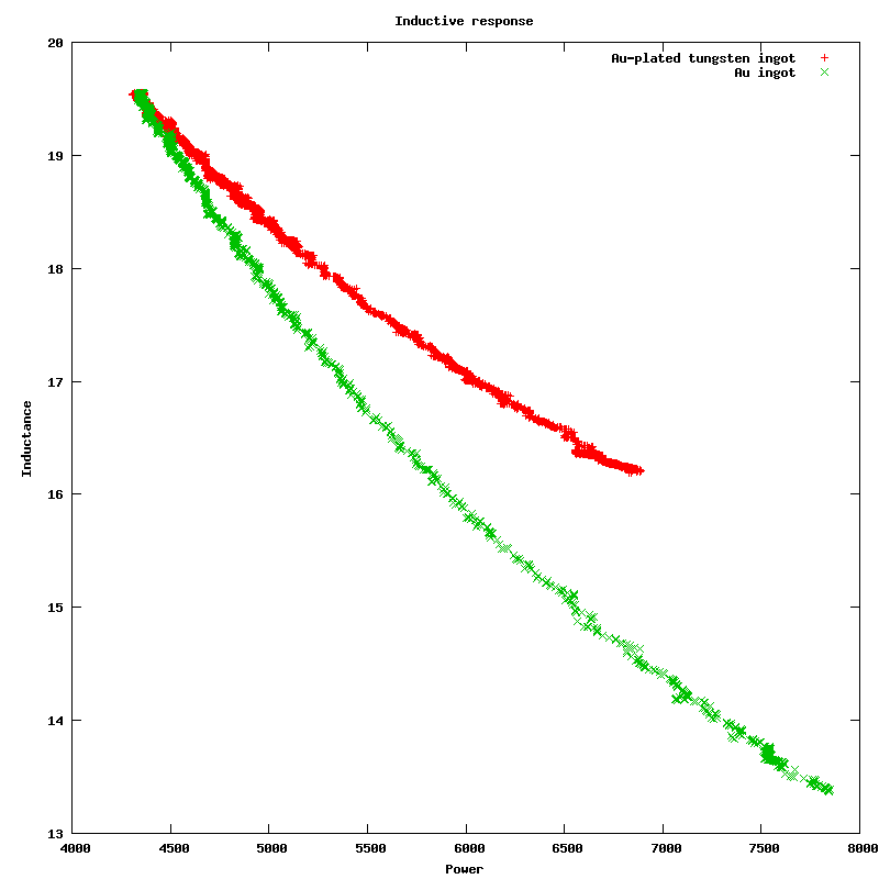

                    Discrimination between Au and Tungsten. True 24kt gold ingot vs. gold-plated tungsten ingot.
