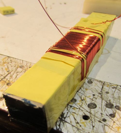

    Just for Curiosity I was experimenting with Nupi's Pin Pointer and I wound a coil on a bundle of Silicon Steel Laminates.
    It Works, However with STRANGE RESULTS.
    Setting it to the Normal setting of Detection (as Used with the Ferrite Core), it Only Detects Ferrous Metals.
    Setting to the Opposite Setting, it only Detects Non-Ferrous Metals.

    Cool Beans. You may be onto a special purpose detector. What is this Silicon Steel ?

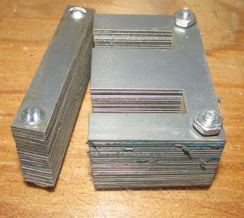

      TRANSFORMER CORE LAMINATES
      The Ones I used are the I's from E & I transformer cores.
      These were out of a Power Transformer, But Smaller I's from a Smaller Audio Transformer are probably More suitable.
      I Don't have any to try at this time.

        Got it. Yea, some are Buggers to get apart.
