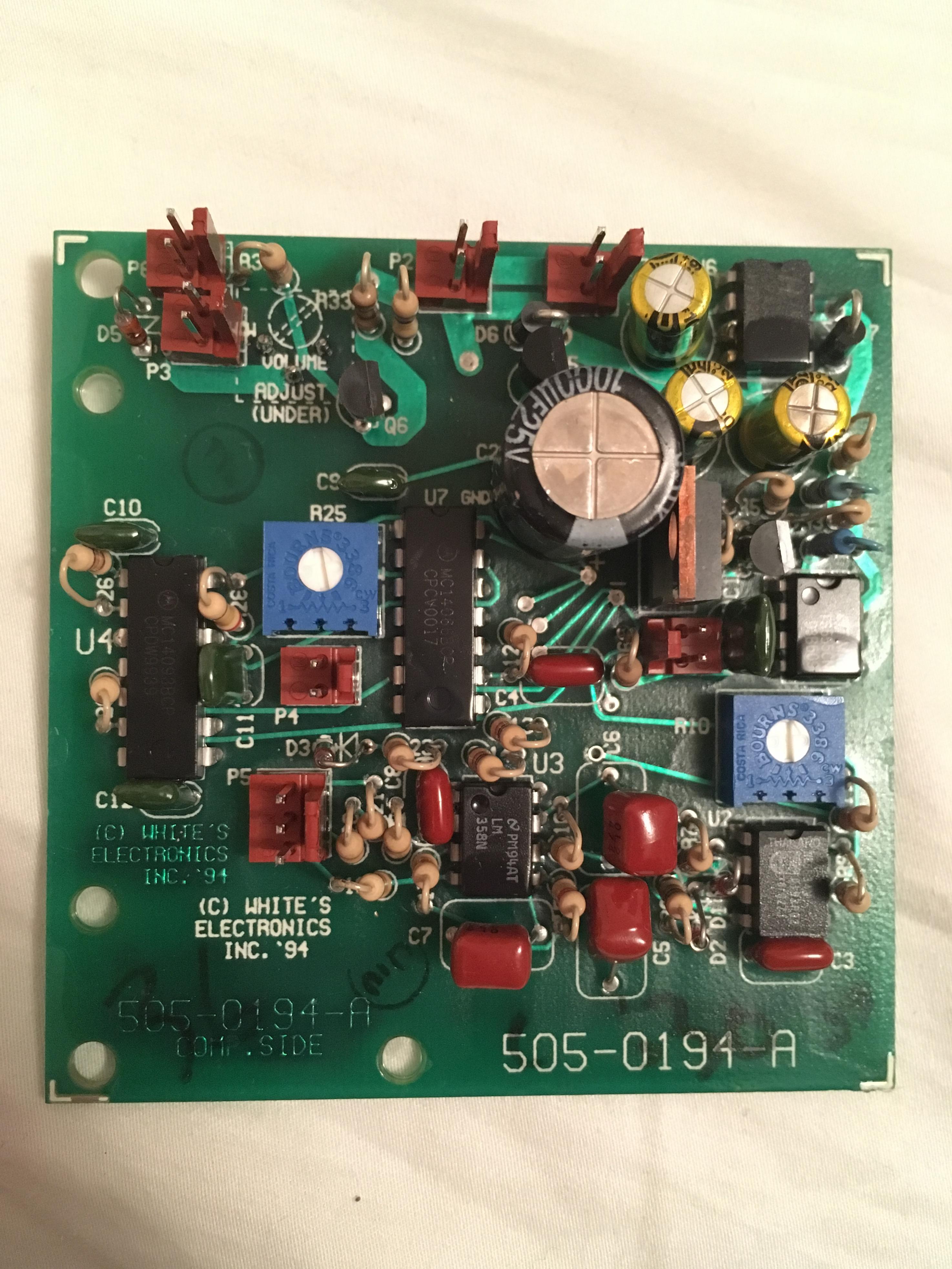

    I have some questions regarding this detector.

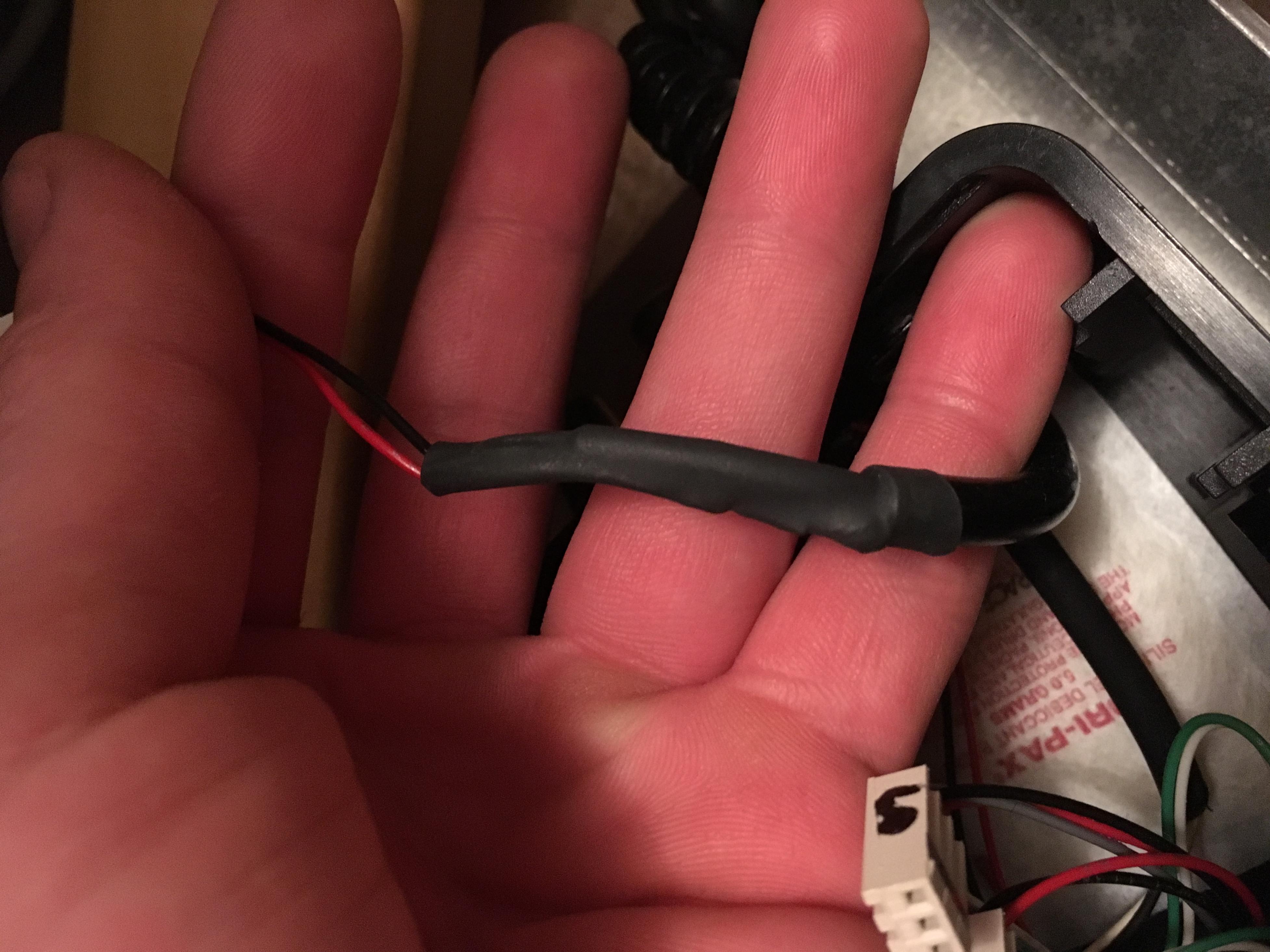

    - where is dumping resistor for the coil? It does not seem to be inside the shrink tube. Coil inductance (pulse diver 950) measure 0.224mh (hi reading) and 292uh(low)- which one is the real value? (i don't have multimeter with me to check the resistance).
    - can i use instead of 8AA battery's 3x18650? what it will be the drawback?

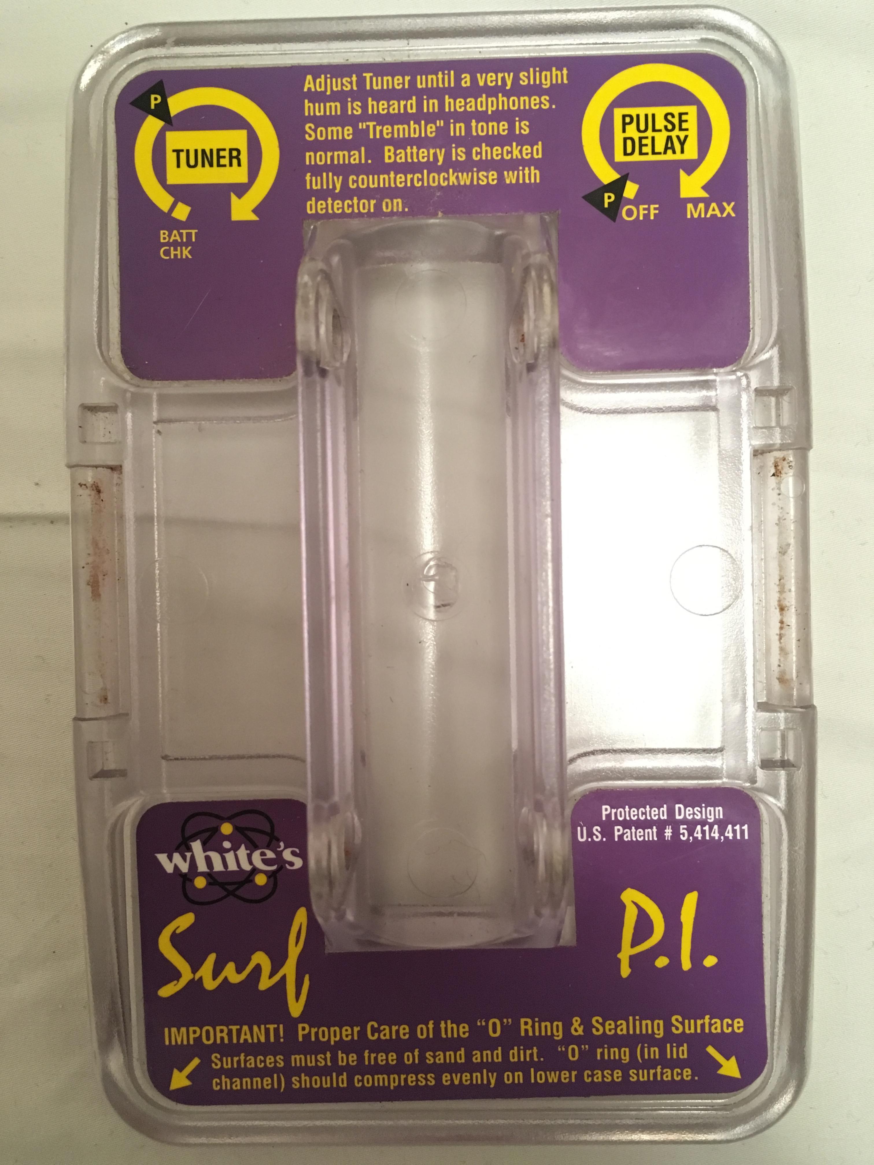

    - i have the black o-ring for the case, i've heard that is notorious for leakage. Where can i get the orange one in Eu.

    - disconnect the coil and measure R on a board coil socket
    - write us the value

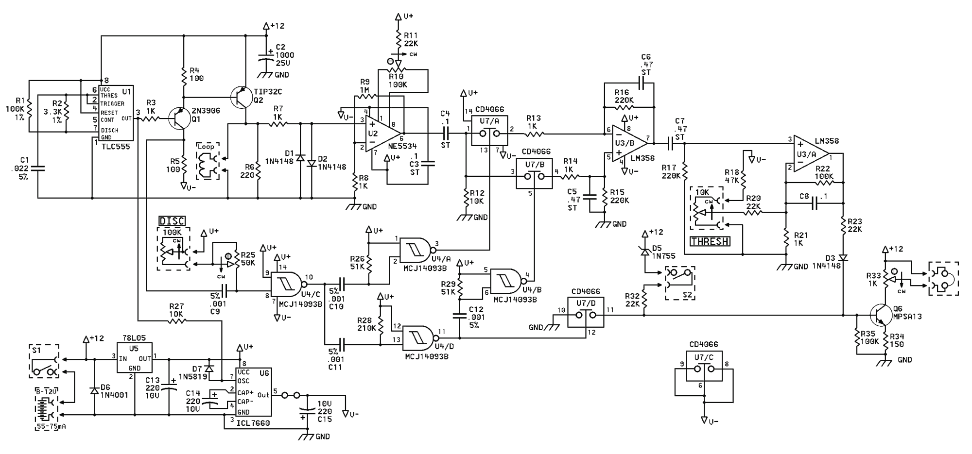

    schematic clearly shows - dumping R is on the board.
      How about a few side view pictures, so we can verify some of the resistor values?.

        I found the dumping resistor, is 220ohm but looks like is only 0.5w. why?

            The detector is fully functional KT. And there is a schematic on the forum with it.

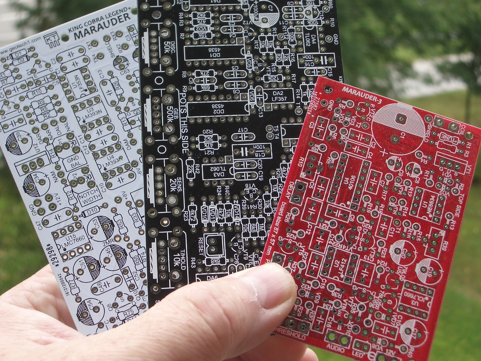

              its OK. i need the board (layout). can you desolder it and share both side scanned? also Part List.

                I don't have time for such a thing. Part list you can take it from this schematic, is exactly the same.

                  with your pcb back i send you a pcb or on delta pulse, either King Cobra, either Barracuda. on your choice.
                  you will get your pcb tested and resoldered back.
