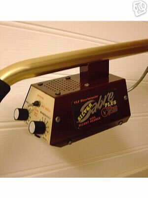

    is there anyone which have a photo of Silver Sabre+ operating panel?

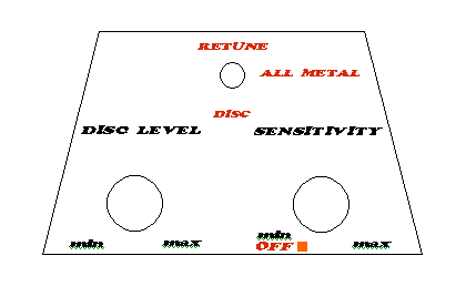

    Side panel as graphic ( attached) NEXT thread is FP (word .DOC) but not very good I'm afraid.
    If you lay out another using AutoCAD or something like that, thne you could send it to me please as I want to make one too but am too busy.
    Print the Side panel on "Adhesive Silver Paper for Inkjets" comes out AWESOME, then coat with clear laquer or transparent plastic, and seal edges. Looks better than original!!

      Front Panel. Sorry it's a home made one.
      I asked Tesoro what font they used, and as usual, they sucked. Kindly suggested I could find an equivalent on the web!! YEAH, How many lifetimes do they think I got??
      Anyways, I got lucky. Try "Charlemagne" as a font, looks identical (almost) to the one they used on the SS.
      Have Fun!

        Many thanks Sean, the side label is nice.

        I'll send you the PCB layout soon. Somebody sent me this picture, now I know what I'm building :-)
