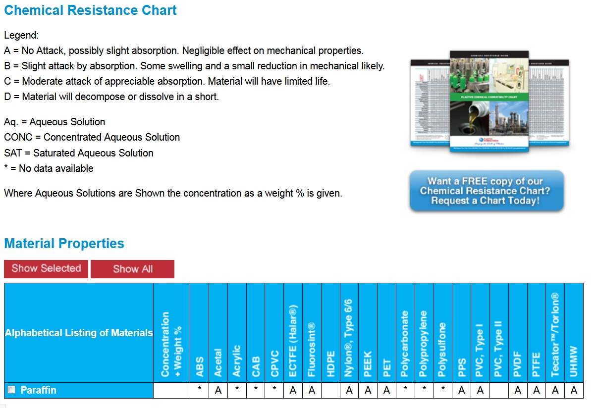

                Your thoughts on liquid paraffin have also crossed my mind, so I'm taking this opportunity to finally look this up ... search ... search ... search
                It looks like that stuff is quite benign at a quick glance. Click image for larger version
Name:	Chemical resistance_paraffin.jpg
                I couldn't explicitly find liquid paraffin though, so not too sure, will have to dig deeper.
                I might look up glycerine as well, just popped up in my mind.
                It's interesting that beeswax is more flexible than paraffin ... didn't know that.
                The dielectric values in charts for Beeswax range from 2.4-2.8
                and 2-3 for paraffin. So not much difference from my perspective, unless aiming for super fast coils.

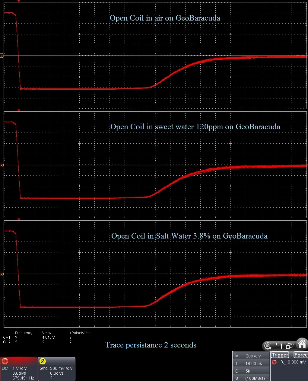

                        Hello Davor,
                        Wouldn't putting the coil windings directly in water change the winding capacitance considerably,
                        because of greatly increased dielectric value between windings, making a slower coil?
                        I will measure this myself one of these days, because answers on internet vary wildly ...

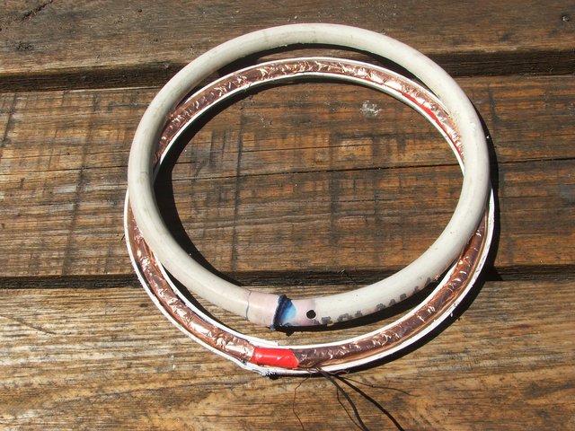

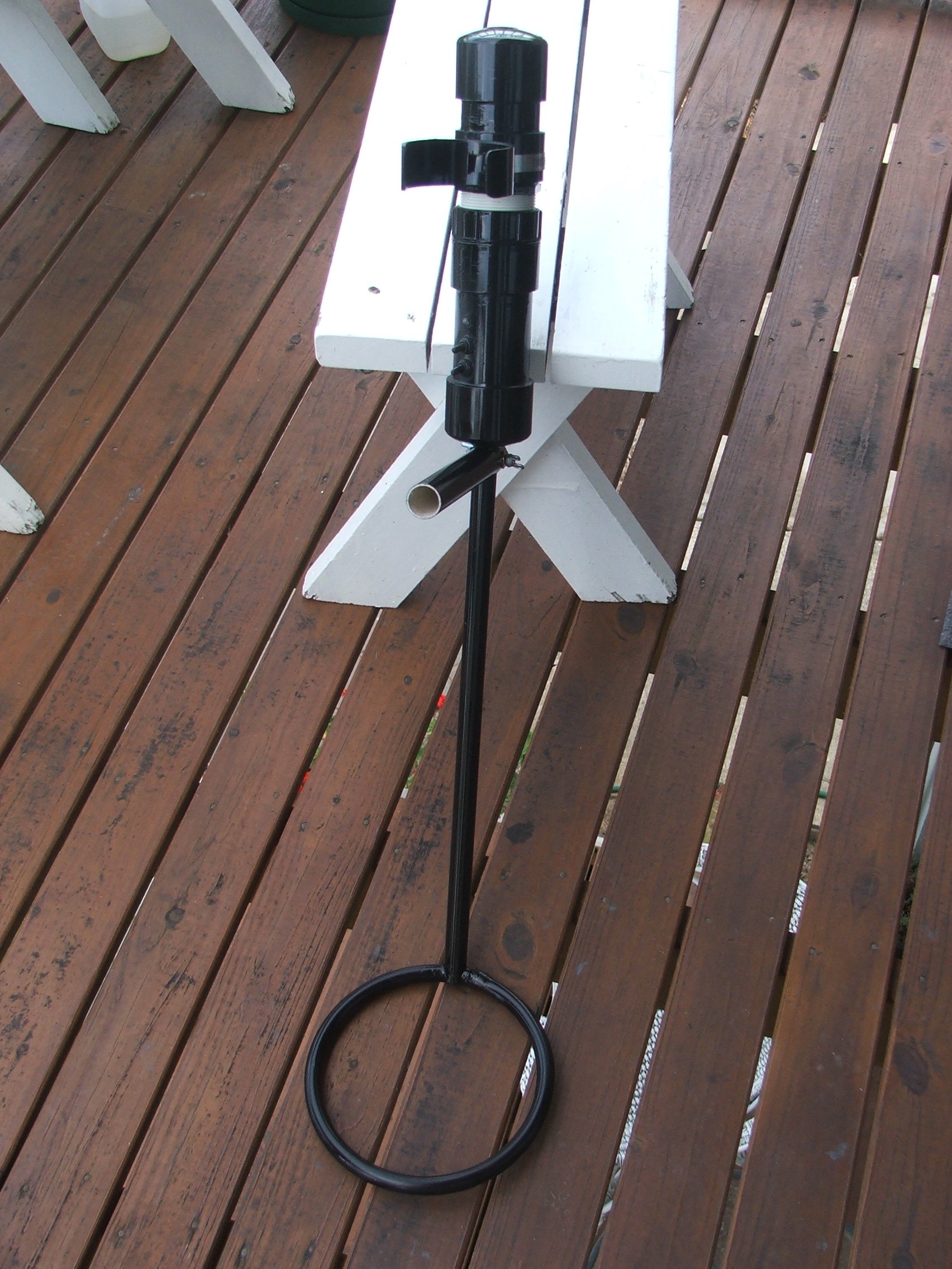

                          Well, I have finished my snorkelling housing for the Pickini and given it a couple of tests in the water and all seems good.
                          I re-designed the original housing as some initial tests revealed that the 0-ring seals were not effective and went for a two-piece threaded one with the electronics in the front section and the batteries at the back. This seams to seal with no leaks and makes for easy access to the batteries and electronics.
                          Because the Pickini is self calibrating I have only needed switches for on/off and pinpoint through the case. I used modified rubber boots over the toggle switches and have used a high brightness white LED for indicating. I have left the sensitivity pot floating on leads inside the case so I can adjust it if necessary.
                          The split pvc tubing coil housing seems to be effective and , being quite thin, swings easily under water.
                          I have made the handle and armrest adjustable and removable courtesy of a wing nut clamp and a stainless hose clamp - looks a bit 'agricultural' but seems to work OK.
                          The whole thing was spray painted with black acrylic lacquer to tidy it up and cover all of the pvc solvent cement on the joins.
                          Here is the pvc coil housing with the shielded coil epoxied into the bottom half -

                          And here is the finished detector-

                          I have since moved the arm rest forward to reduce flexing on the seal when swinging the detector under water.
                          All in all, am pretty happy with the way it turned out.
                          So far, I have managed to find a USB memory stick (very corroded!) and a 5c coin in the local saltwater lake and can't wait for a calm day swell-wise to try it in the sea.
                          Down the track I hope to try adding a piezo as the LED indicator takes a bit of getting used to.
                            I don't think it would make any difference under water, only a complication. Because you'll have a coil on a short distance from a Surf, it makes no sense making any interconnections - just wind a number of flexible insulated wire turns and terminate the wire ends in your Surf. You'll have to make the coil rigid, but if you take care wires of a coil are intact, the very coil may as well be soaked in water - It would make no difference.
                            I'll make sure my Surf goes under water in the summer. I had other things to do, but now I'll be available for more detectors stuff.
                            It looks like you are right. At least this is so with the measurements I made with a relatively slow & open coil (just a bundle of windings)
                            immersed in air, sweet water and salt water.
                            The much higher dielectric value of water between coil windings does not change the settle time as much as I imagined.
                            Actually in this case it's neglegible as far as I can see. Here the three scope pictures: Click image for larger version
                                [ATTACH]42203[/ATTACH]
