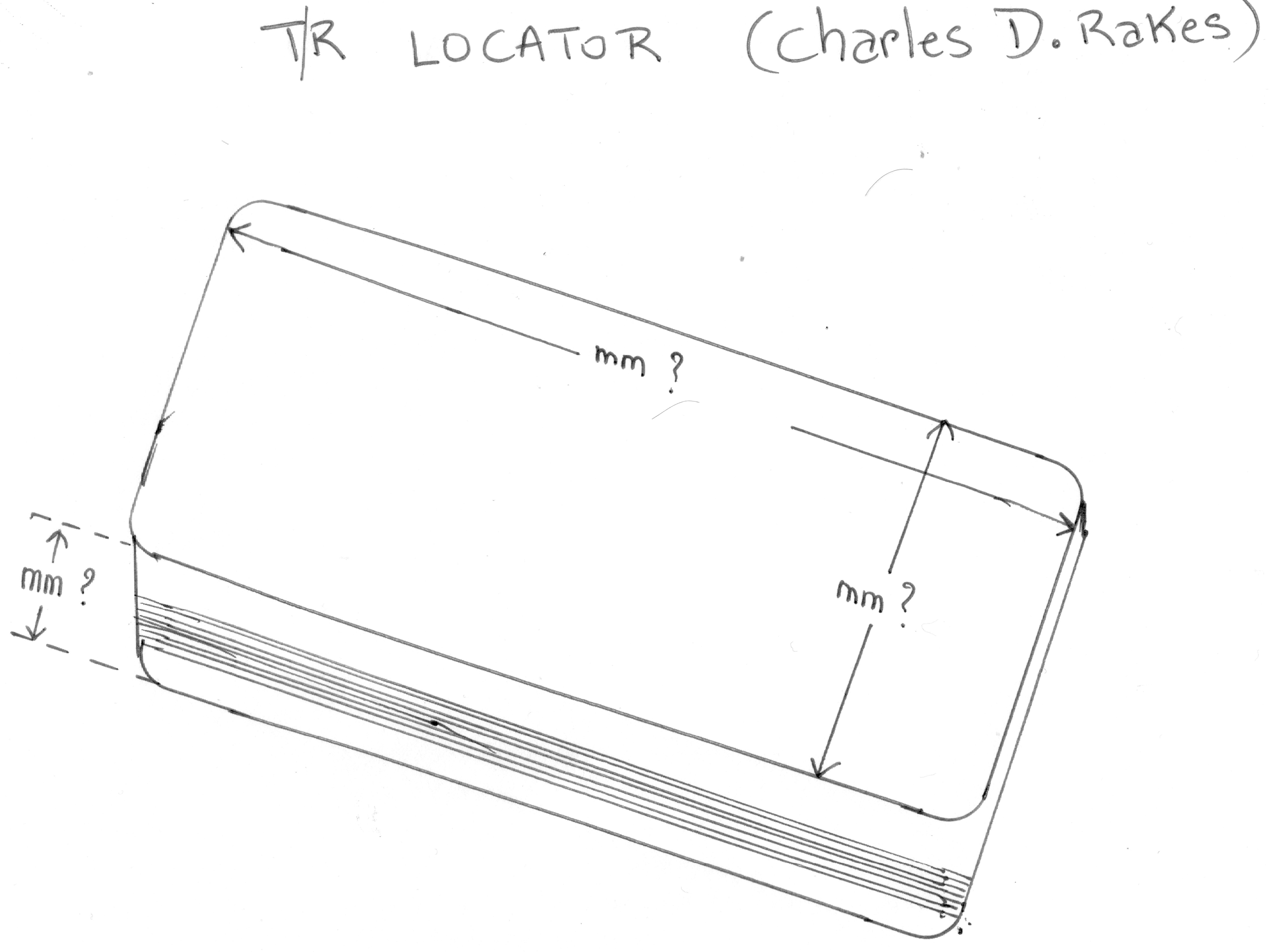

    hello ! i'm building a twobox locator ( see pdf from géotech1 ) but i don't understand the dimensions of the two case in inch , can someone draw me schematic in millimeters pleaseClick image for larger version
    It's not at all critical, but for a starting point 200mm x 250mm x 25mm.
      thank you very much carl , you're a nice man
