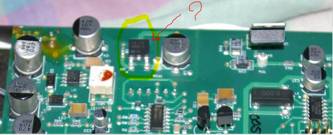

    hello
    who can tell me what is this component and where to find the reference?
    THANK YOU
    Seems to be a voltage regulator.
    A better picture could be helpful.
      Low drop 5v regulator.

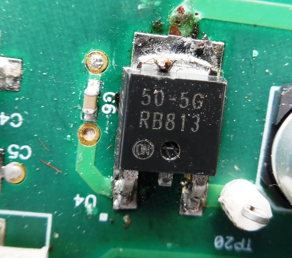

        Hello
        Thank you for your answers.
        I made a better picture, I can not find the model.
          Attempt to draw a how it is bound I still think it's a regulator .
          https://www.circuitsonline.net/forum...ery=00&mode=or

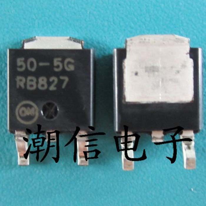

            ON Semiconductor LP2950CDT-5.0G, LDO Regulator, 100mA, 5 V, ±1% 3-Pin, DPAK
            https://docs-emea.rs-online.com/webd...6b813857fa.pdf
            it is 50_5g regulator
            Product Details
            Low Dropout (LDO) Linear Voltage Regulators, Up to 120mA, ON Semiconductor
            LDO (Low Dropout) Linear Voltage Regulators, ON Semiconductor
            The Low dropout or LDO is a linear voltage regulator. We have a wide range of linear regulators. The LDO regulator can operate with a small input–output differential voltage. LDO voltage regulators may offer fast transient response, wide input voltage range, low quiescent current and low noise with high PSRR.
            Specifications
            Output Voltage 5 V
            Output Type Fixed
            Package Type DPAK
            Maximum Output Current 100mA
            Mounting Type Surface Mount
            Maximum Input Voltage 30 V
            Pin Count 3
            Polarity Positive
            Number of Outputs 1
            Quiescent Current 0.075mA
            Accuracy ±1%
            Minimum Operating Temperature -40 °C
            Maximum Operating Temperature +125 °C
            Height 2.38mm
            Load Regulation 0.2 %
            Dimensions 6.73 x 6.22 x 2.38mm
            Length 6.73mm
            Line Regulation 0.2 %
            Width 6.22mm
              oh, thank you very much!
                no prob here are more the second set of numbers letters is manufactory specific but they are the same device.
