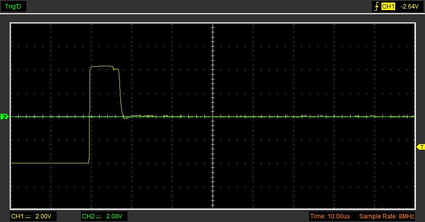

[HELP] asymmetric output op amp

        i have test swap IC-2 NE5534 with OPA134, LME49710, AD847, same result,
        I suspect it has something to do with 4066, later I will not use 4066, I will report the results again

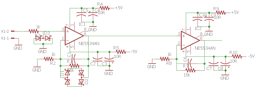

          do you have + and - power connected to the 4066's? You don't show it.

            Also try removing the 4066 then measure 5534 output.
              Have a look at the goldscan 5 schematic. Pretty straightforward. Like I said, input bias and slew go hand in hand.

                this is my mistake, I don't use +5V and -5V on cd4066 ,
                Thank for rickb, waltr, dbanner, green, moodz and KT315
                SOLVE
                Regard,
                Wahyu
                  schematic
                  Different supply 4093 and 4066, swing clipping,
                  After 4093 and 4066 supply with +5V / -5V
                  SOLVED,
                  Thanks All,
                  Regard,
                  Wahyu
