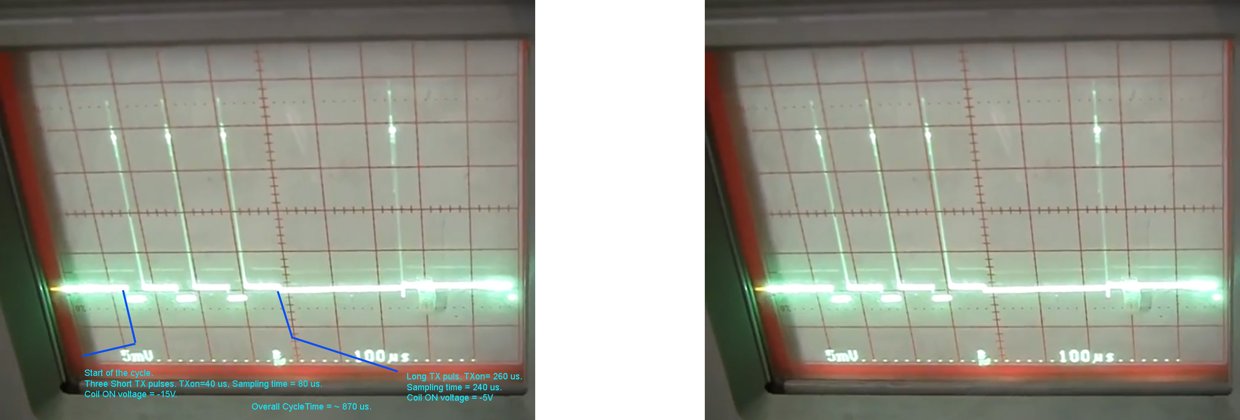

    Could you please draw on paper timings of two modes of GPX-4500 - Enhanced and Standard? It is a confusion in my understanding of enhanced mode timings you explained above.
    Below are my waveforms.
    [ATTACH]44796[/ATTACH]
    From the left to the right: Coil TX current, Flyback voltage, magnified bottom part of a flyback voltage. Ground contact of oscilloscope attached to Coil_VCC=15.5 V.
    (R_d_coil=415 ohms. Coil current was measure across 0.3/4=0.075 ohm resistor. Coil voltage - along part of R_d_coil which is 84 ohms (415/84=4.95) )

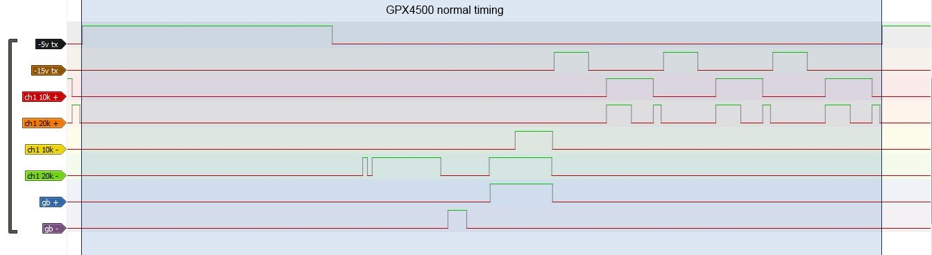

      Ok these are the timnigs I mentioned before.
      Machine GPX-4500. Mode: Standard timing. Source: Woody DetectorMods.
      All my comments on the picture and comments below need to be verified.
      My guess: During three short samples GPX takes only target integration samples. During long TX pulse GPX takes only ground integration sample. It uses some kind of weighting coefficients to subtract Long_pulse_ground from Short_pulse_target.
      Ground balance switch works as follows: Turn on the switch. You pump the coil up and down - GPX changes weighting coefficients until GPX sees no change in the signal. After that you switch off GB switch and start your prospecting.

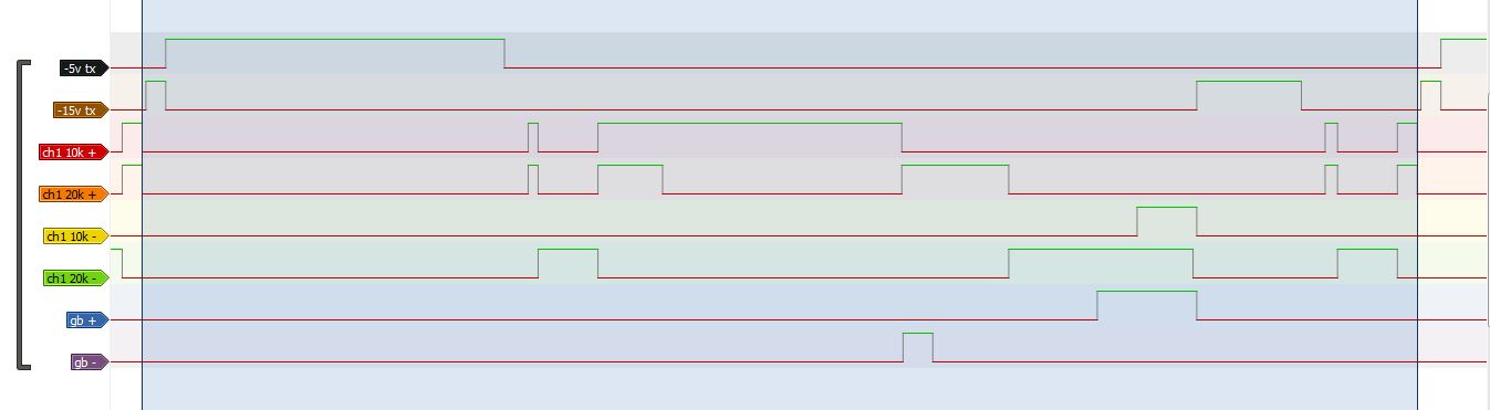

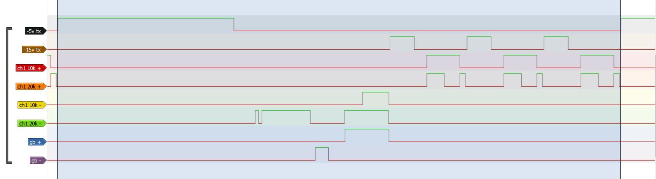

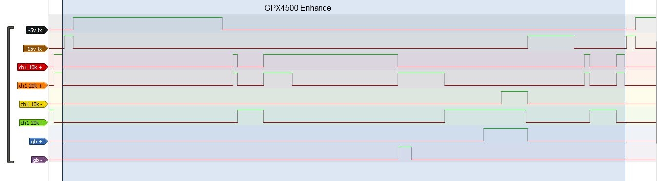

        • #49
          So for each channel, unlike the sd2000 where the signal goes through the 10k resistor on its input to the integrator, there is 10k and 20k path to provide different levels of gain for the samples depending if the 10k or 20k or both are on together.
          The cycle time is about 775us.
          I will post scope shots of the tx voltage and current next week.
Name:	Normal tx ch1 gb.JPG
Name:	Enhance tx ch1 gb.JPG

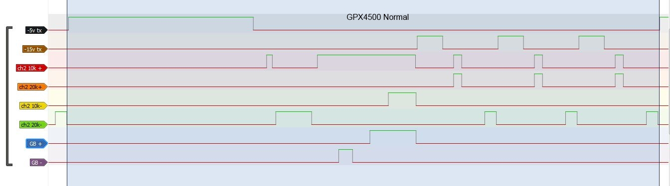

          • #50

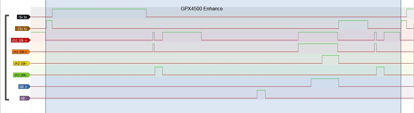

            And ch2 for Normal and enhance.
            I didn't bother with the SETA channel or Discrimination as it is not really relevant.
Name:	Normal tx ch2 gb.JPG
Name:	Enhance tx ch2 gb.JPG
            Cheers Mick

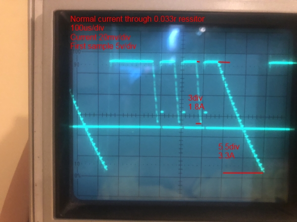

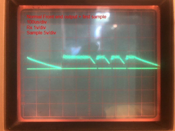

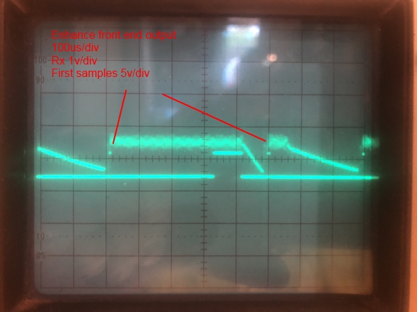

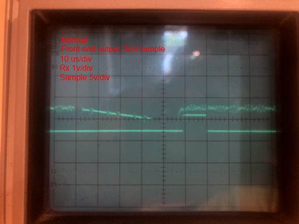

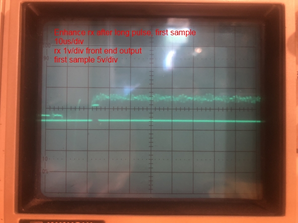

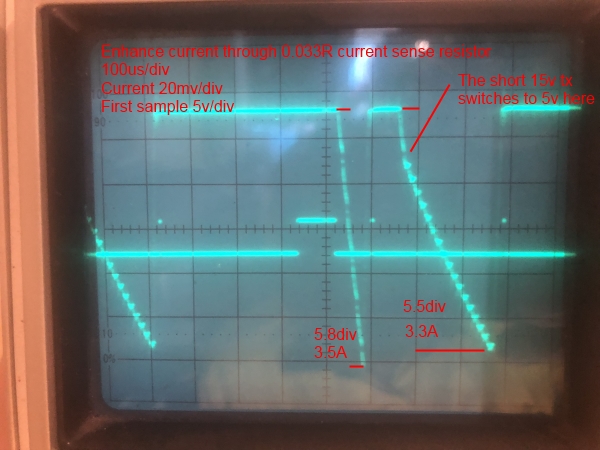

                      Rx pictures taken from front end output.
                      Current was measured from the 0.033r current sense resistor in the coil cct.
                      I have included the earliest sample in the trace for reference.
                      I didn't take direct coil voltage shots. Flyback is clamped at 180v.

Name:	Normal Current.jpg
Name:	Enhance first sample.jpg
Name:	Enhance current.jpg
                      Cheers Mick
                      • #56
                        Thanks Mick.
                        At the end of long TX pulse of Normal mode I have expected to see more flat part of a current curve.
                        Thank you again.
                        I am still working on replicating these patterns you provided for us.
