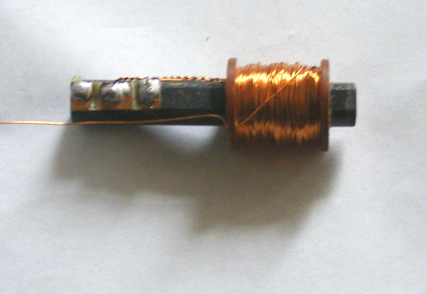

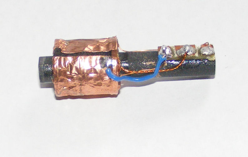

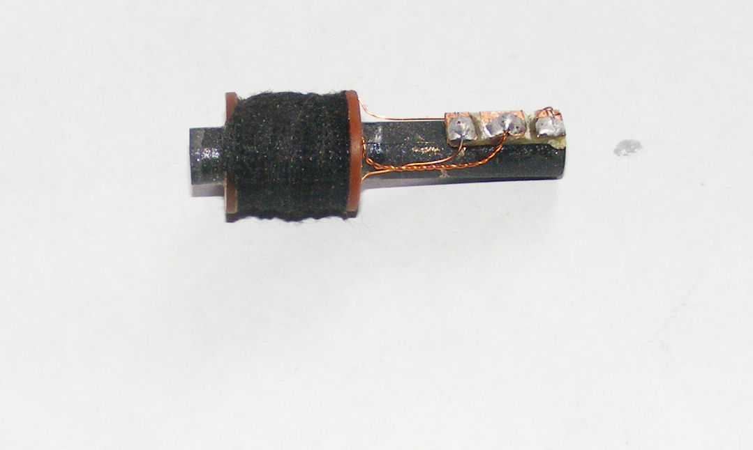

              Would you explain how you are doing a screen of the coil that is built on a ferrite rod. Can you post photos on the shielded coil so that the screen interruption can be seen.
              I'm aware of how to make an ordinary coil screen, but I've never shielded a coil wound ferrite rod and the technology is not clear to me.
              Thank you!
                Hi DOM44,,,I watched the video and downloaded it for my collection,,really interesting video and I just love older technology. If you ever decide to have a go at bulding one I'd be interested in having a go too,,,,As someone before has asked, could you post some pics and a description on how you, personally, shield the ferrite coil you made for your FM2 please? It would be a great help to us all. Regards. Marty,,,P.S:-Just seen a page on Ebay where one was just recently sold for £560.00 and £30.00 P&P.

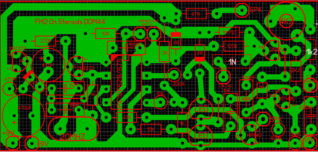

                    Hiya again Dom44,,,I traced the BW PCB Image you posted,,,wondering if you could just check it for me before I start to build,,,Hope you didn't mind me tracing it. Thanks. Marty
                      Toros - this is how i made my coil, I used super Glue to stick the board and washers down. and i solder the resonance capacitors to the little board.
                        Nice find Marty not much available on the gold spear, I checked the board it is right but two part values needed fixing this is correct now.

                          Hi DOM44,,,Thanks for taking the time to check my PCB Layout and thanks for the coil shielding pics you posted. I've corrected my PCB so I can get it printed off and etched. I'll let you know how it goes and post some pics. Roughly, what value is the resonant capacitor that is placed across the coil please? Let us know if you decide to have a go at the Goldspear,,,sounds interesting! Thanks again,,,,Marty
                            no problem the capacitor value for the coil depends on your coil inductance i just use the scope measure the frequency add or subtract capacitors till you get the right frequency around 20Khz when it is right the detector will come to life the chip wont respond unless the frequency is right, trying to fix some stability problems with it right now, i know the R19 value is critical to operation so you have to play with it.

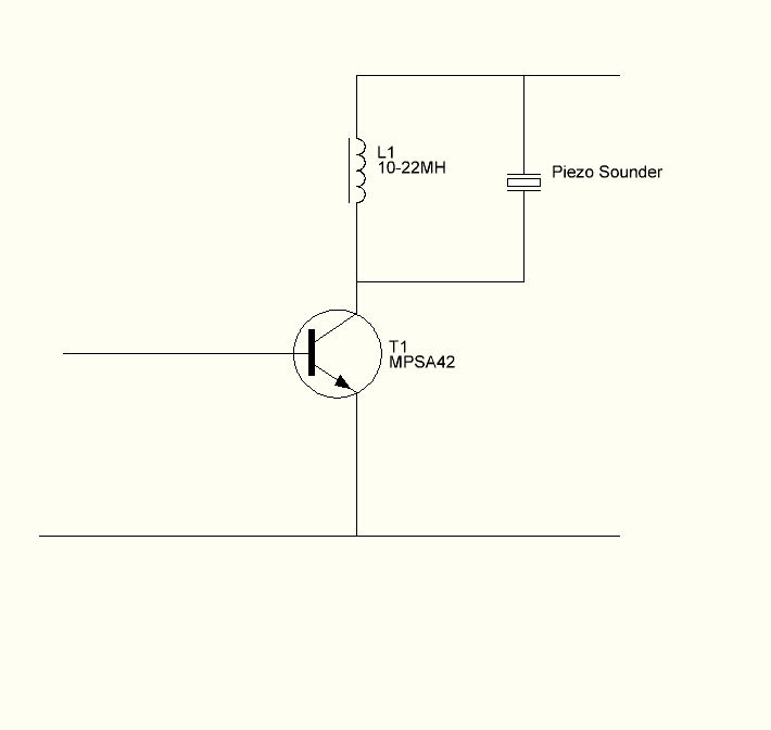

                              Hi Dom,,,,I just printed my PCB out but haven't the time to etch it tonight. I ordered some 3v6 Diodes,,BC549C,,,MPSA42 and 20 more pieces of 70mm x 100mm copper clad board (for various other projects). I thought I may as well use exactly the same components as you,,then if you you change things later (as you mentioned in an earlier post) I'll not have that much to alter then. I'll look around and gather what I can regarding the Goldspear. Thanks again for all the help with this project,,just awaiting my parts now. Cheers,,,Marty
                                If you use the MPSA42 then you are going to need a 10-22mh choke as well to place across the piezo sounder like this.
