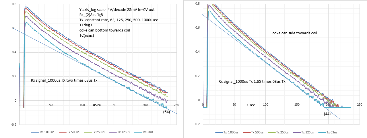

      Coke can signal decay with different Tx times. Don't know why 500us and 1000us Tx aren't the same. Tx times greater than 5 times the target TC shouldn't increase the signal. Two times the signal doesn't increase detection depth very much.

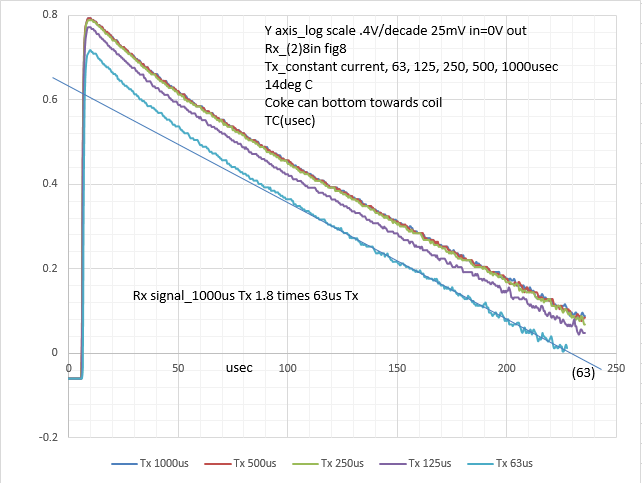

          Found why, Constant rate Tx not constant current Tx. Chart(TRT_54)with constant current Tx. Above(TRT_53) was constant rate Tx.
            TX has to be 5 times greater than the higher of the target tau and the coil tau to see no more pulse width effect.
              Thanks, that explains constant rate(infinite coil tau). I charted it because the coke can has a tau lot less than 500us. Wasn't thinking about coil tau. My error, been using constant current(.5A peak)and constant rate(1A peak)at lower peak currents. Wasn't thinking about needing long Tx time for higher Tx current. The 500us is needed to charge the coil to a high current with Delta Pulse? If I had kept rate at each step constant the Rx signal difference between Tx times would have been a lot greater, Rx signal >times 2 for each Tx time step.
