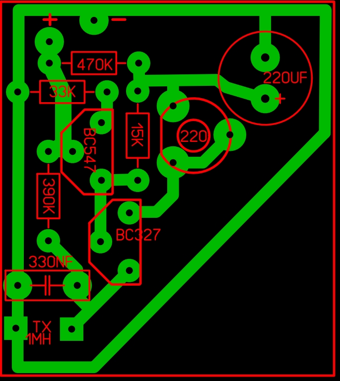

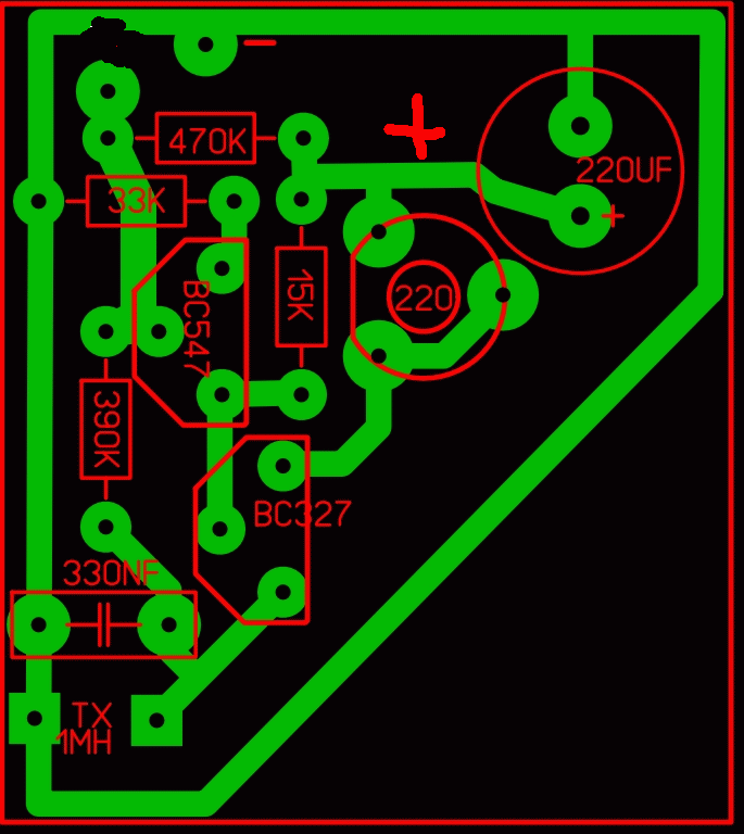

    Hi all,,,,,I've been struggling to learn how to null 'DD' and 'CC' coils these past couple of months and I saw a post by Hyena (Tomas) saying that a lot of Inductance meters weren't to be trusted when solely relying on their readings in regards to tuning a certan Inductance to a specific frequency. I have several different Inductance meters and they all give totally different inductances when measuring the same coil so I understand what he's saying!,,Anyway,,Tomas suggests to build an Oscillator to connect the coil to, to find the frequency of the coil under test, and then calculate the inductance from that etc,,,,I have drawn the IGSL Musk oscillator in order to try this method as it is the IGSL Musk coil I'm struggling to null,,,As I've still got a lot to learn about electronics I'm wondering if some kind person would check my drawing for me to see if I have drawn it correctly,,,and also what power would apply to the circuit? I would be immensely grateful. Thanks,,,Marty

      Hiya Chemelec,,,,I hope you enjoyed your holidays!,,,and I'm really sorry to hear about your health,,I really do hope things start getting better for you and send you my best wishes. Thanks for the reply to my post. More than anything, I really wanted to know if I had drawn the Oscillator correctly, and what power I had to apply to it for it to operate. I have 3 different inductance meters and they all give different inductance readings for the same coil. I have a Hantek DSO 5102P scope but I'm still learning to use it as I only bought it last August. The coil I'm trying to tune is a 'DD' for the IGSL Musk version. The TX=1MH and the RX=14.7MH. One of my meters says the coils measure near enough correctly (within a few UH) but the other 2 meters says I'm miles out!,,lol. I'd like to build this oscillator to try a known capacitor with it to measure the inductance and see what that tells me. Thanks again. Marty

              Hi all,,,,Can anyone tell me if the IGSL Oscillator I drew is correct please and what voltage I need to apply to it to test a coil on?,,,Thanks in advance,,,Marty

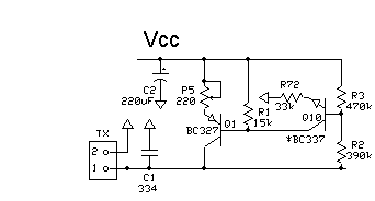

                Musk oscilator
                I think now its corrected... next time please always attach schematics.
                  Its feeded with stabilised 8V in circuit - through 7808, but you can power it even directly from 9V battery.
                    Original oscillator is supplied with stabilised voltage, so all the biases are fixed against it. The only two problems with voltage stabilisers are their ridiculously high noise, and their voltage margin. Both problems should disappear with a slight design change that makes bias independent from rail voltage. When AB->C mod is applied, the bias turns off anyway, and battery supply becomes the ultimate power source. No 1/f noise whatsoever.
