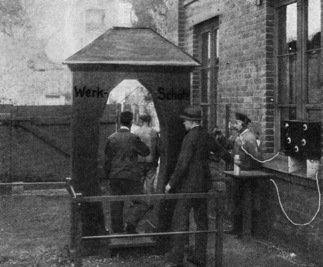

              The oldest walk-thru design I know of is from 1924. It was a single-coil design and you walked through the coil. Used the energy-theft method, same as how the current Garrett pinpointer works.
