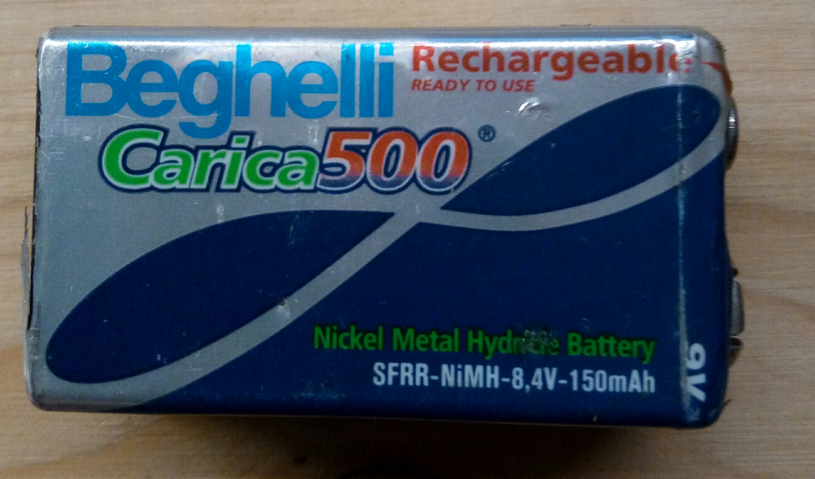

    the battery is not a chinese one but a genuine BEGHELLI italian battery (made in p.r.c. ) but hi have used various batteries and have used this other times...

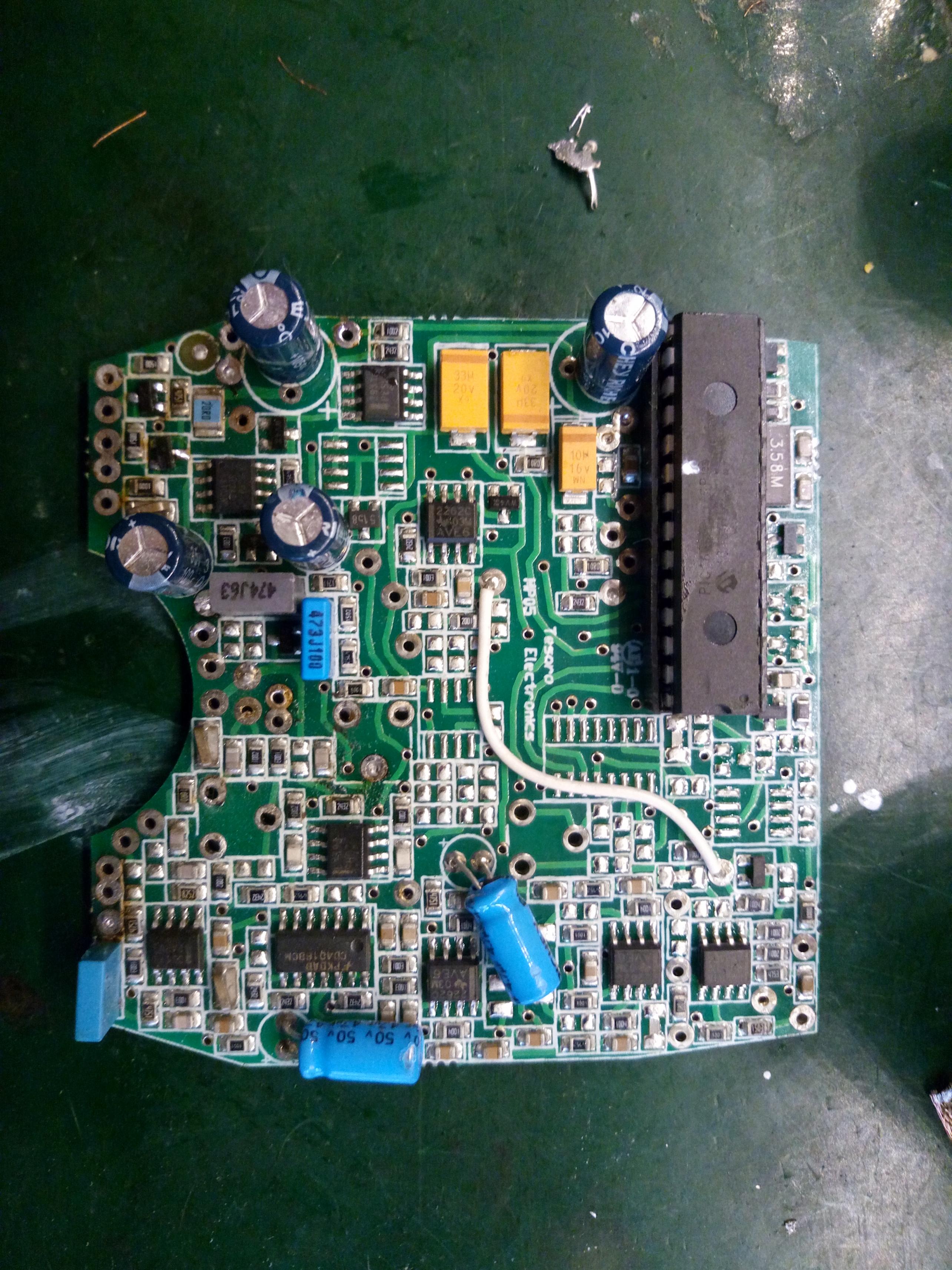

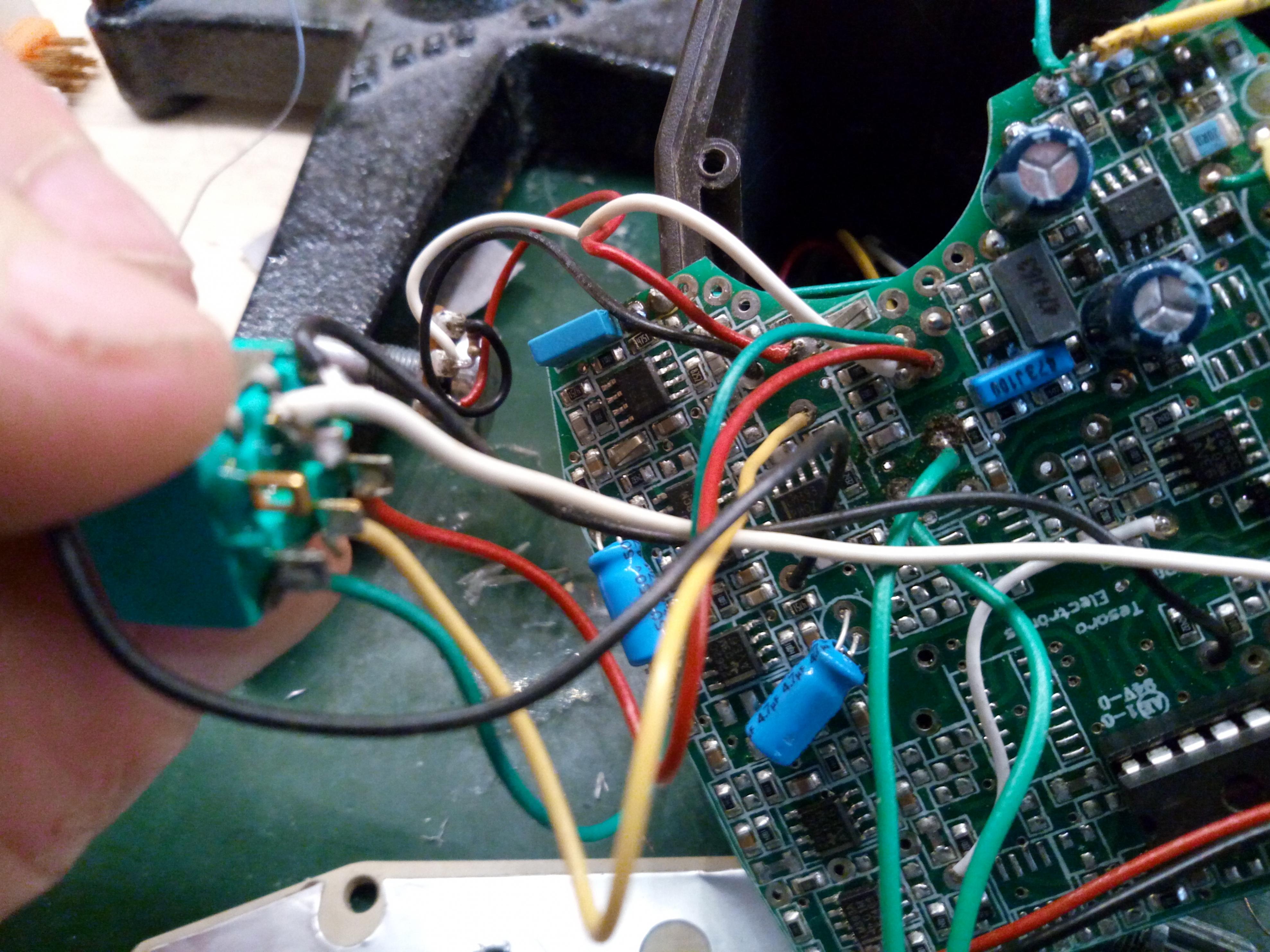

        I have reassembled the pots and switch etc.. now detector is working with an alkaline battery... i feel so stupid
        but a question remain ....
        I have used this battery many times in field !! so it's is the battery life finished after many recharges ... consider this battery is probably from 2012 but other two batteries are new...

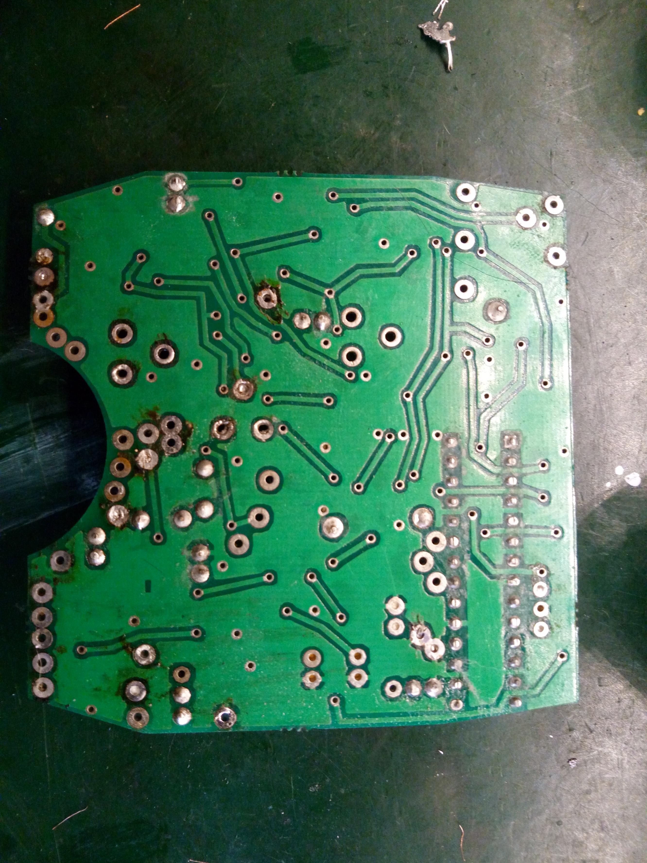

        i have cleaned the PCB too .. ??
        sorry for pictures KT315 i'll collect all the data from this "experience" and post here for future reference ok ?

              his only problem is the inability to estimate the batt capacity.
              http://www.learningaboutelectronics....nal-resistance
              All batteries have some internal resistance to some degree.
              Batteries have internal resistance because the elements that make it up aren't perfect conductors. The electrodes and electrolytes aren't 100% conductive. So they will have some resistance (internal resistance) in them.

                        i was not thinking at battery because i have used for years batteries line this and not problems arise.
                        this Is not an excuse for overlooking simple things at First.
                        i have read the post of kt315 too that states that internal resistente of battery increase with battery consumption.
