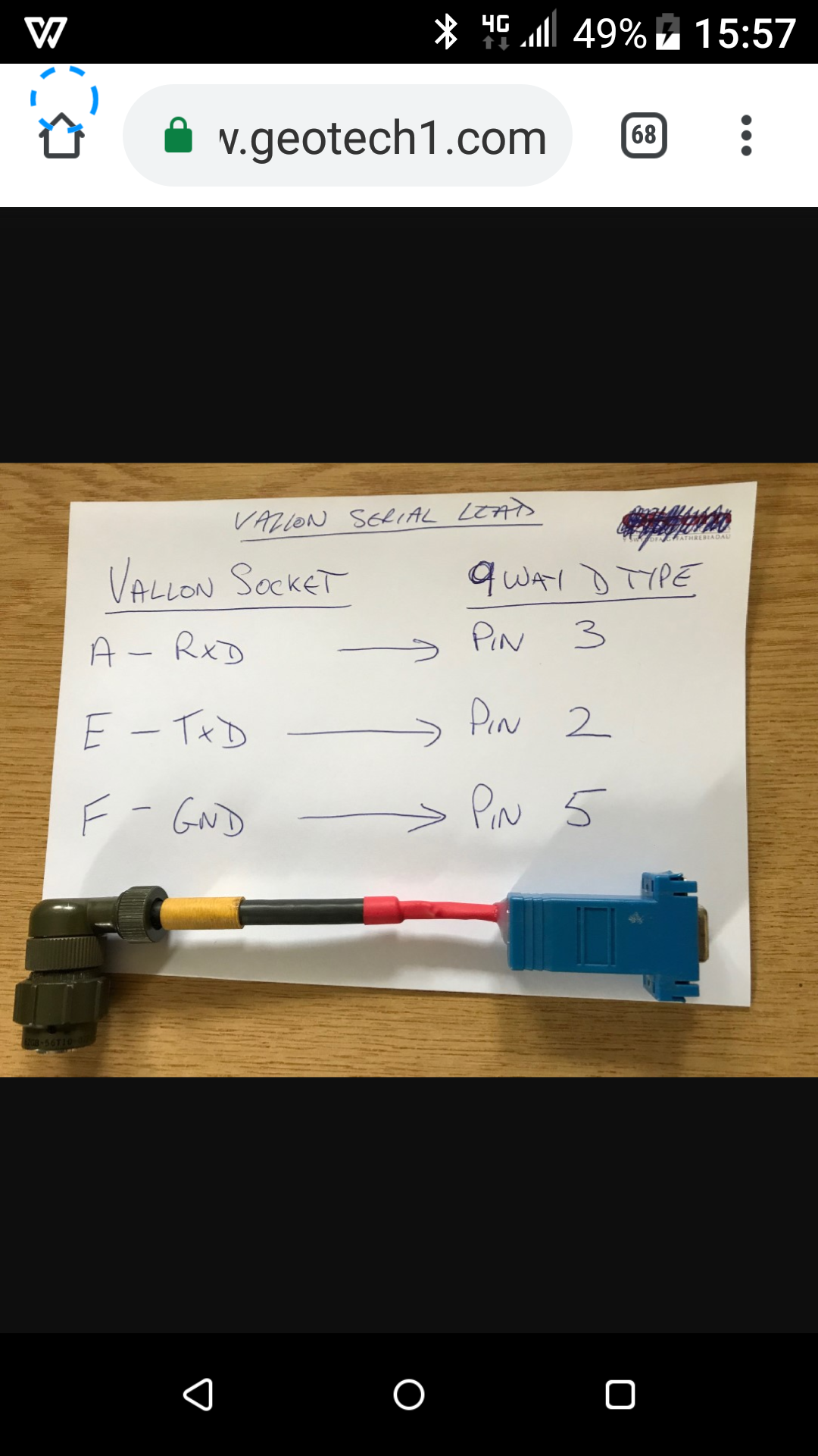

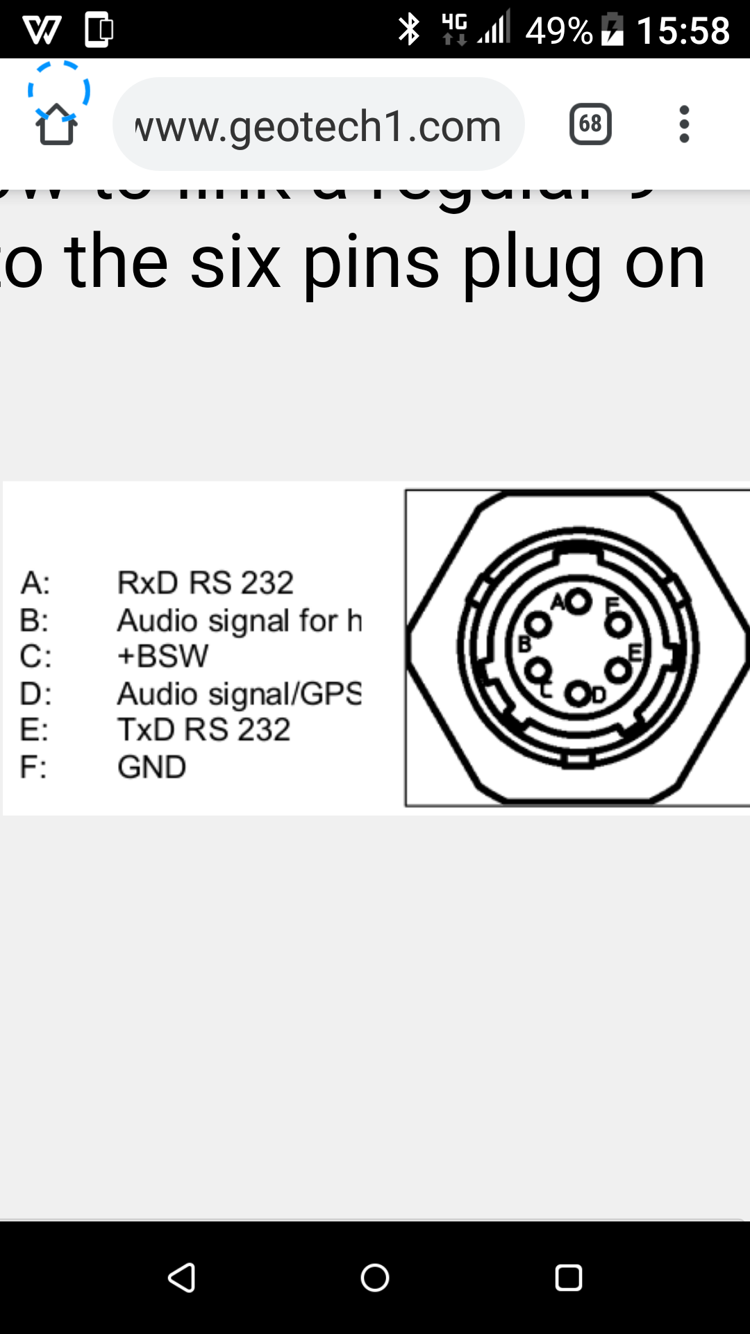

      hey how did you guys make the serial cable to connect to the vallon
      greets

ID:	354574are a couple of pictures that show the plugs and pinout
