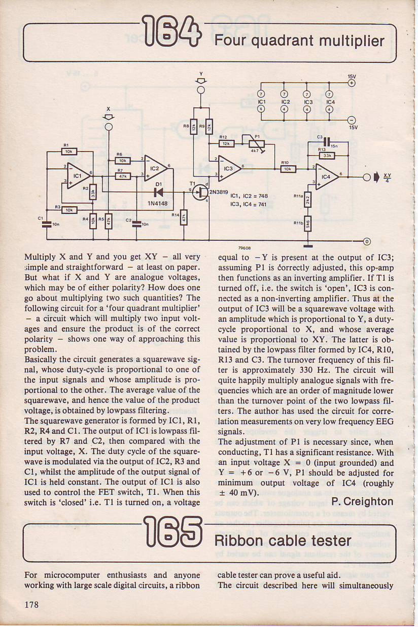

    I see X and Y inputs. I wonder if this circuit can be the basis of some crude and simple VDI. Maybe just to give an indication of Ferrous/Non ferrous when in all metal mode. Like a visual two tone.
    Check electronic music circuits to see more approaches to this.
      If one were to connect x y to the sbg-pid circuit where the discrimination pot connects, for example, then put a comparator on the output of circuit to drive an LED for ferrous Target.
      I wonder if that would work, of course there would need to be some mods to circuit. But as a concept, I wonder.
