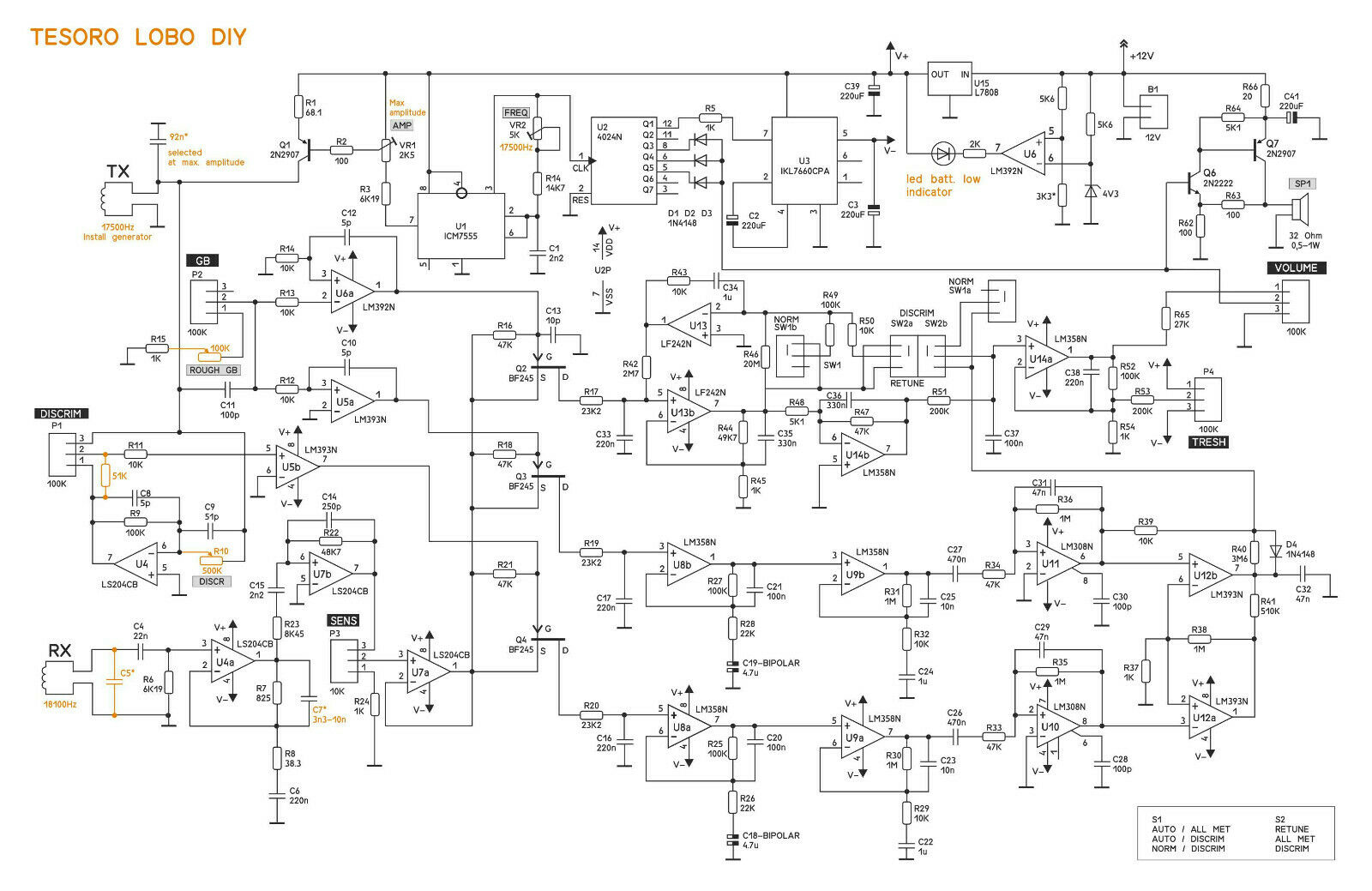

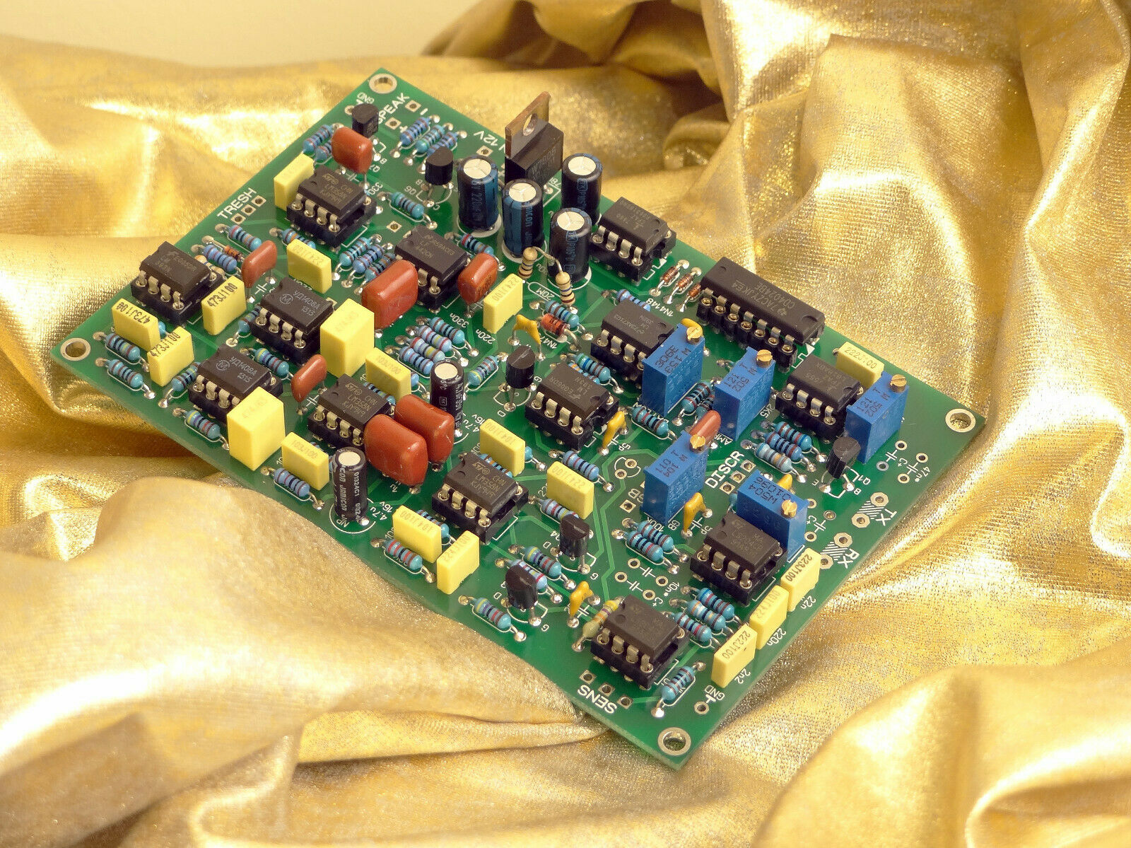

    Hi i bought from ebay Tesoro Lobo DIY kit
    and i found this cheep coil also from ebay
    https://www.ebay.com/itm/NEW-Tesoro-...c/293135744717
    i was wondering what capasitors do i need to add to make this coil grate (agen) ???....
    i think this (Tesoro Lobo) board was originally modded by the members on this forum .

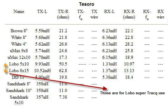

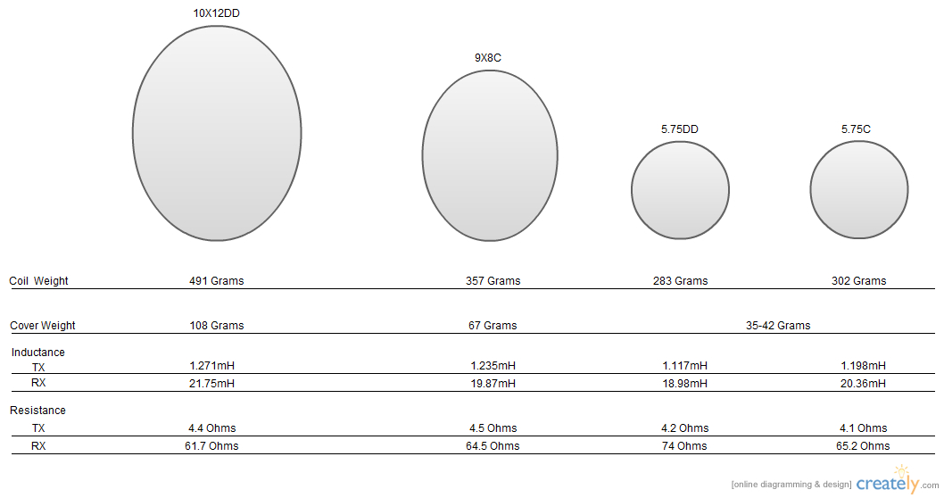

        What you have there is the kit for "older series" Lobo model with specific RX&TX coil specs. Pay attention on inductance more than to focus only on working frequency.
        And Nel advertise the coil which supposedly covers Tejon and Lobo at the same time, just as well... which is highly suspicious claim too.
        You see; Tejon and Lobo Super Traq belongs to "new" series of Tesoro models. Even than; i think that coils for Tejon and Lobo Super Traq differs much in the morphology.
        And you here are having Lobo kit for model from "older" series. With coil specs pretty much different than the "brown" coil you showed on the link.
        Pretty confusing for someone who isn't following the Tesoro history and the timeline of their products.
        So, no, i don't think that you will have any success with Nel coil either.
        What you have to do is to look up for the Lobo coil from older series. The first Lobos.
        Or to make your own coil respecting primarily the specs i gave you on that list.
        Boomer...
          On second thought; Tejon and Lobo Super Traq even may share the same coils, since inductance is pretty close.
          Nel advertisement could be alright.
          But this do no good to you, because you have "older" series Lobo pcb. The "early" Lobo.
          So you have to search for coil with specs:
          Tx = 1.35mH - 12 ohms
          Rx = 9-10mH - 55 ohms
            On third look... maybe Nel coil will be alright.

                Look at the bright side of this; now you have PERFECT coil to make TGSL, IGSL or any other "wannabe Tesoro" from older series.
                This forum is fed up with schematics splendidly and accurately traced by William Lahr.
                You loose nothing. You actually are in winning position.

                      you do not have to be worry. you can use different coil than sure lobo, just tune a cap on your pcb for 'working' frequency, 'in-resonance'.
                      yes i hope so to but is it to big a difference 10 Khz( like most likely the coil is meant for ) to 17.5 Khz (that the pcb bord wants and works best whit)
                        Post #6, the PDF file... read it.
                        Simple tuning with capacitor to desired frequency is not the solution.
                        You'll get poor performances ... if any.
                        Coils are "balanced" to suit and match given frontends.
                        Simple tuning by adding or removing the capacitance is sort of "brute force" and it will dramatically affect the phase relations.
                        What you may freely expect are very poor performances.
                        You have there ~5.7mH TX coil and ~6.2mH RX coil at that "brown" search head.
                        Compare those to wanted 1.35 and 10mH as proper specs for Lobo coil.
                        Even without trying it must be obvious to you that there are slim or none chances to make any success with that coil and that pcb.
                        Enough from me.
                        Sometimes is better to learn on own personal experiences.
                        Cheers!

                            The 8.5 " Tesoro Wide Scan coil came to day i measured it and here is the values
                            pin 1 and 3 = 4.7 Ohm 89 mH
                            pin 2 and 4 = 85.6 Ohm 16.3 mH
