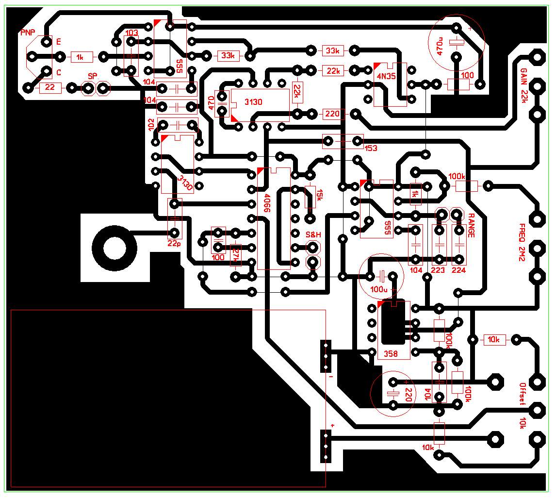

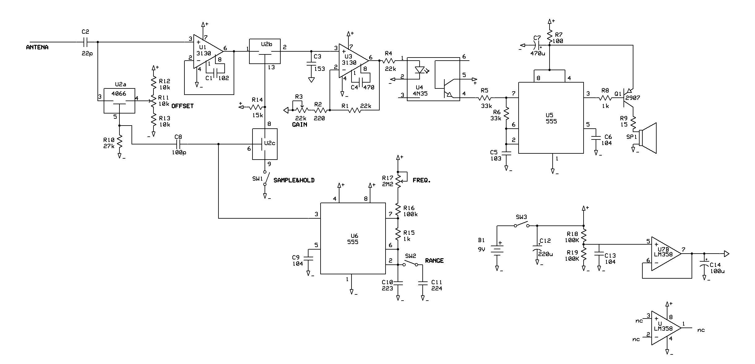

    Hopefully Gyorgy will not warn me on this, because really it has nothing to do with LRL, but the BEST EVER in wall cable locator, that i saw for the whole of my life so far : is my version of Zahori.
    Cable, single wire, live or not; Zahori will kill it. Best ever.
    But; instead of telescopic antenna; you should put small copper plate 2x2cm and mount it suitable for walls "scanning".
    All the details are now on LRL part of the forum.
      2x2, 3x3, 4x4 even 5x5 cm copper plate. Larger the plate; larger the sensitivity and "scanning" area.
      It simply kills when it comes to in wall cable/wire locating.
      Many years ago i tried to make real working LRL and i failed (of course) , instead i made terrific cable/wire locator!
      Real deal would be to make it SMD and pack in small package.
      Don't know (don't believe) if those CA3130 can be obtained in SMD package, tough!
      So it makes sense to look for any modern SMD replacement for those.
      Both NE555 should be "regular" and NOT CMOS (NE555 and not 7555).

          Hopefully George would not mind me to post here the schematic and pcb for Zahori.
          This time aimed as indeed useful in wall cable/wire locator and not nonsense LRL.

            Seems i do not push post button previous time... Thanks everyone. Ivconic i already check my supplier and they have only the CA3130 DIP version(altough the datasheet mention SOIC package), where the opto and the timer are available both dip and smd. Good that you warn me about the CMOS timer as that was what i plan to use;-). My eyesight is not any more suitable for SMD, so i dont think i'll go that way. Let me see if i'll manage to order the parts until my friend is vacation as here they are damn expensive and hard to find.
              Uuups, wrong. Farnel have the SMD MZ verson in stock.
