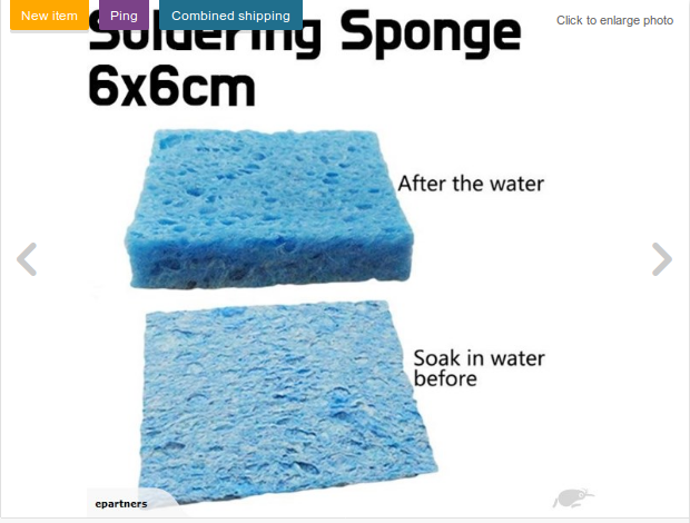

          Also buy some expanding soldering foam pads.
          Cut them to fit inside the lower portions of the box that face downward and in other places water could roll to.
          The foam expands when it gets wet soaking up any water in the box. It could just save your electronics.
          The desiccant packs are also a good thing, I always stick a couple in the box before closing.
