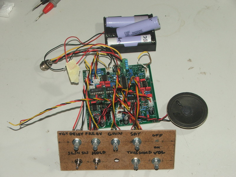

          I have just finished the board for my latest Mirage and am in the process of calibrating it.
          This is my third mirage, having previously made two of Sven's which are both working well.
          A couple of mates wanted to build detectors so I bought 3 boards from Elliot and we get together once a week to assemble them. I previously assisted them in building Pickinis which were great introductory projects.
          PS for testing purposes shorting together pins 2 & 3 of the headphone socket enables a speaker to be used in the speaker socket.
