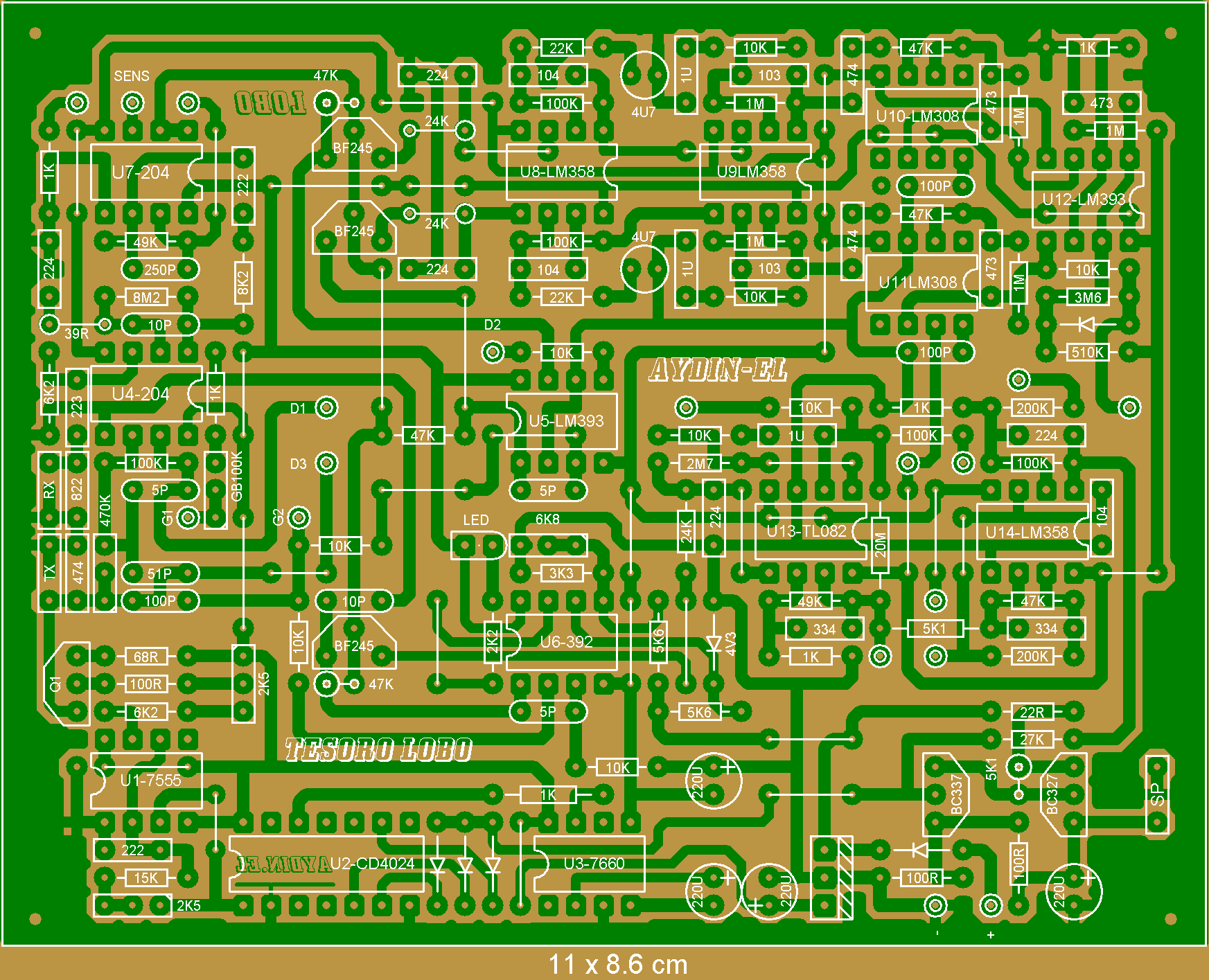

      The Lobo & Goldbug are about equal.

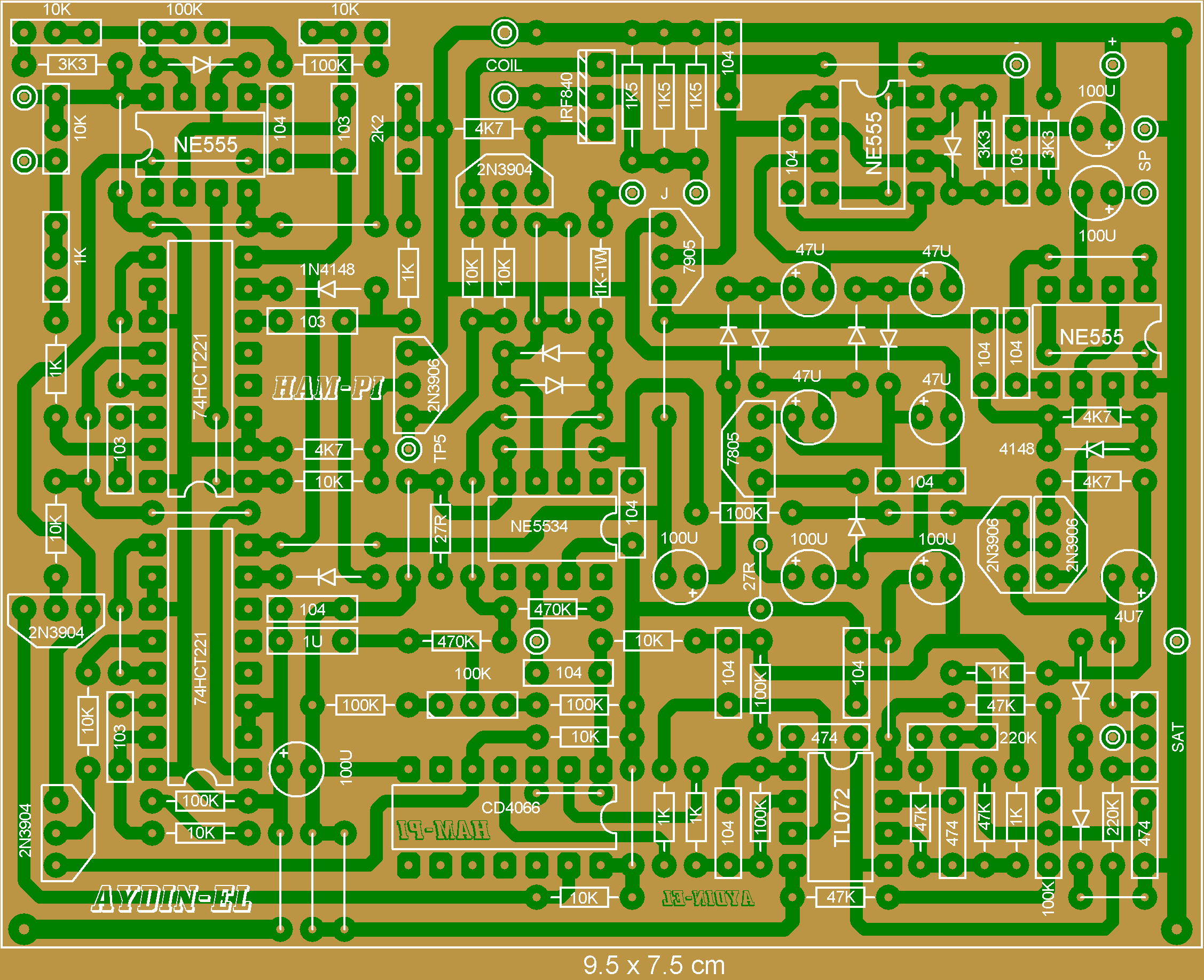

            The SD2000 is a pulse machine. Also very excellent if you can make it. This is advanced build, difficult project for beginners.
            Also there is the Mirage PI. Excellent pulse machine. It is in the same family tree as the Hammerhead.

              I've prepared two circuits but I don't know which one to make

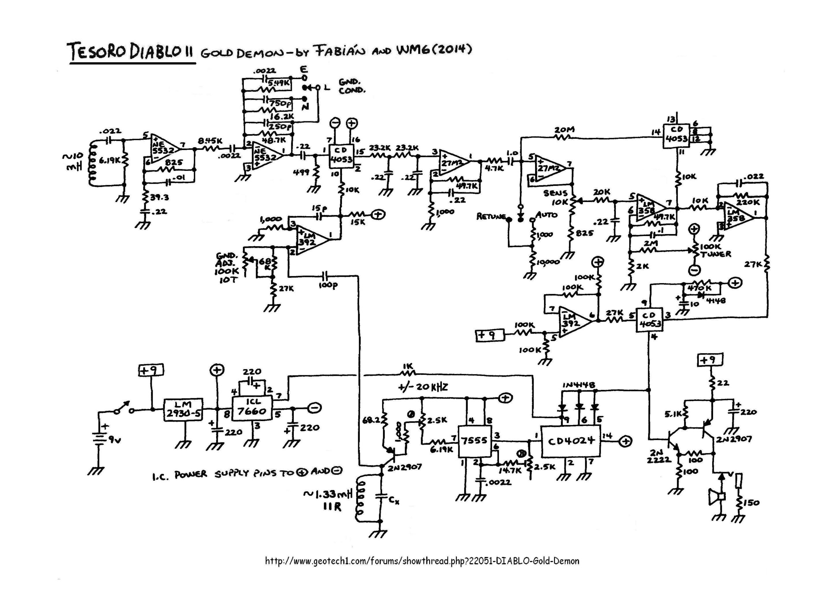

                      hi WM6
                      this circuit is correct or no?
                        Originally posted by sayan1345 View Post
                        thank you for advise
                        hi WM6
                        [ATTACH]49202[/ATTACH]
                        It is correct.
                        Diablo is genuine gold detector (mean: no discrimination, ask for repeated re-tuning),
                        but depth on gold nuggets is competitive to modern prospecting apparatus.

                          I want make Diablo
