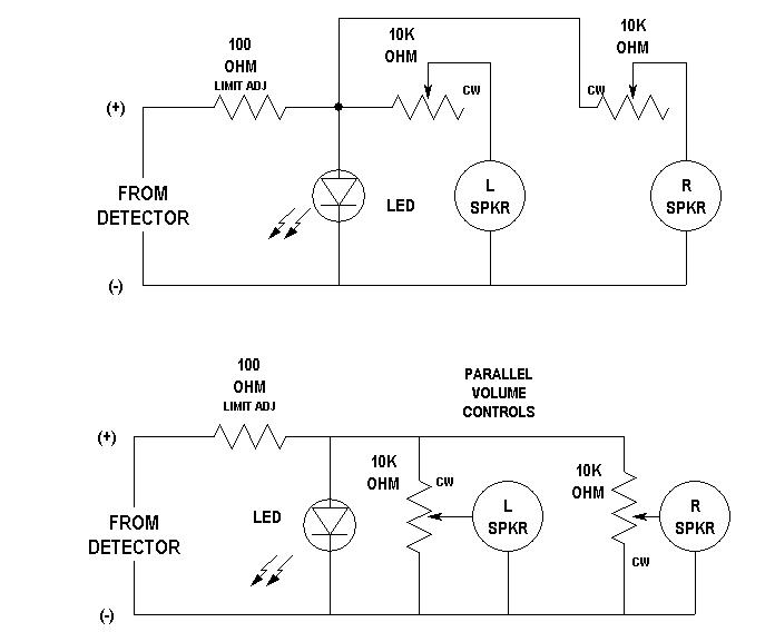

            DO you have circuit on putting led limiter in stereo head phone with volume controls?
              Re: limiter
              Try this. Take red LED's and connect accross the volume controls. Cathodes to ground. Is this for music or a metal detector. Stereo or dual volume control mono?

                          Or this
                          Get a short two headphone adapter. One output to your headphones, the other plug in a stereo plug with an led from each stereo pin to ground. Also try diodes or two led's in oposite polarity on each left/right pin.
                            Re: limiter
                            I will try this on a pair of white headphone.
                            do I use one led or two per side or is there a circuit I could look at? thanks I will be using them on a metal detector XL pro(6000)
                              Mono example, one LED
