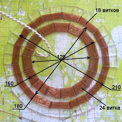

            I have already built several IDX; bara; surf; lobo, tgsl, feleez, pirate ...... a lot of coils for each device, concentric, DD, mono ...
            I follow you on Youtube I subscribe to your channel. my best mono coil is 30cm made with litz wire. it allows a delay of 9ms. but I still do not reach 25cm deep on an 18k ring at the beach ..
              my mpp beach also gave very good results, with a coil of 28cm, but I could not detect more than 28cm on a piece of 1eur. the 18k ring at 22cm max ...

                      kt, 3 years ago, I made a double field coil, and yes it is the best.
                        question?
                          double-field-basket coil.

                              but the most efficient remains for the moment, is my double coil litz wire 30cm ...litz 175/46
