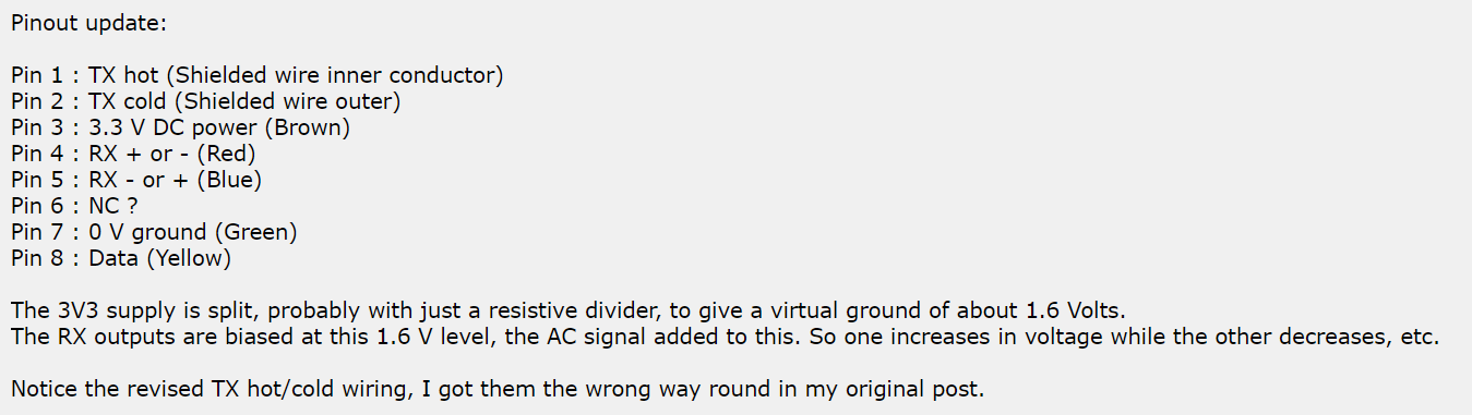

    I was looking at the thread in the coils section that references the Nox Coil, specifically Skippy's Pinout update. It suggests I have P1 and P2 reversed but that is actually what I see on the old damaged plug. I cut the original plug so that I could see the cross section that shows the red outer wire in the P1 position
    Also I used shrink tube to isolate the completed soldered pins from each other instead of the hot glue fill that is in the original plug.
    Pin 1 : TX cold (Shielded wire outer) Red coated copper wire
    Pin 2 : TX hot (Shielded wire inner conductor)
    Pin 3 : 3.3 V DC power (Brown)
    Pin 4 : RX + or - (Red)
    Pin 5 : RX - or + (Blue)
    Pin 6 : NC ?
    Pin 7 : 0 V ground (Green)
    Pin 8 : Data (Yellow)

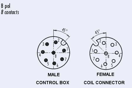

        This is what I have and it is accurate at least on my Nox. I have soldered a number of plugs by now.
        It is very easy to solder those pins in the wrong order, need extra attention on how you hold the plug.
        Pinout of the coil connector (female) while looking at the non-solder side (holes side).
        Perhaps you have made a mistake, because I did, many times.

          This is the thread I was looking at that suggests I have pin 1 and 2 backwards. In the thread Skippy shows Pin 1 and pin 2 as I have listed above and then he posted an update that shows they were wrong and he flipped the P1 P2 wiring.
          My original plug that I cut agrees with his first Pinout list.

                Female connector, need to look at the non-soldering side for correct pin numbers. Note 1 and 2 have a notch between them.
                https://www.geotech1.com/forums/atta...3&d=1574187998

                            When I click on them, they are displayed for me and URL is geotech, not my pc. I did upload them. These images are from Skippy's thread, there is nothing new there.
                            I'll try to attach them again
