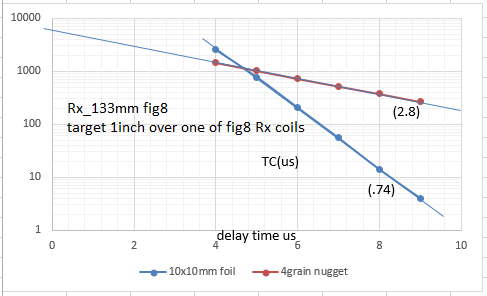

                      HI green
                      do we have to sample as fast as 2.9us to get that 4 grain nugget?
                      I mean for example when we say target X has Tau of 10us does it mean its eddy currents will completely die at 5 Tau (50us) but at 10us it has already lost 63% of it's eddies?
                      so we need to sample even faster that 10us?

                        The targets eddy currents don't completely die a 5 tau(lost over 99% of the signal). Theory says they never completely die. I can detect a 10mm square of aluminum foil at 10 tau(lost over 99.99% of the signal). For low tau targets(less than 10us)signal reduces to half for each .7*tau increase in delay.
                          Charted target decay for 10x10mm foil and 4grain nugget. Forgot where I wanted to put it and put it a different thread so I'm adding it here. Foil at 1inch is easily detected with a delay over 10 tau.
                            thank you so much green
