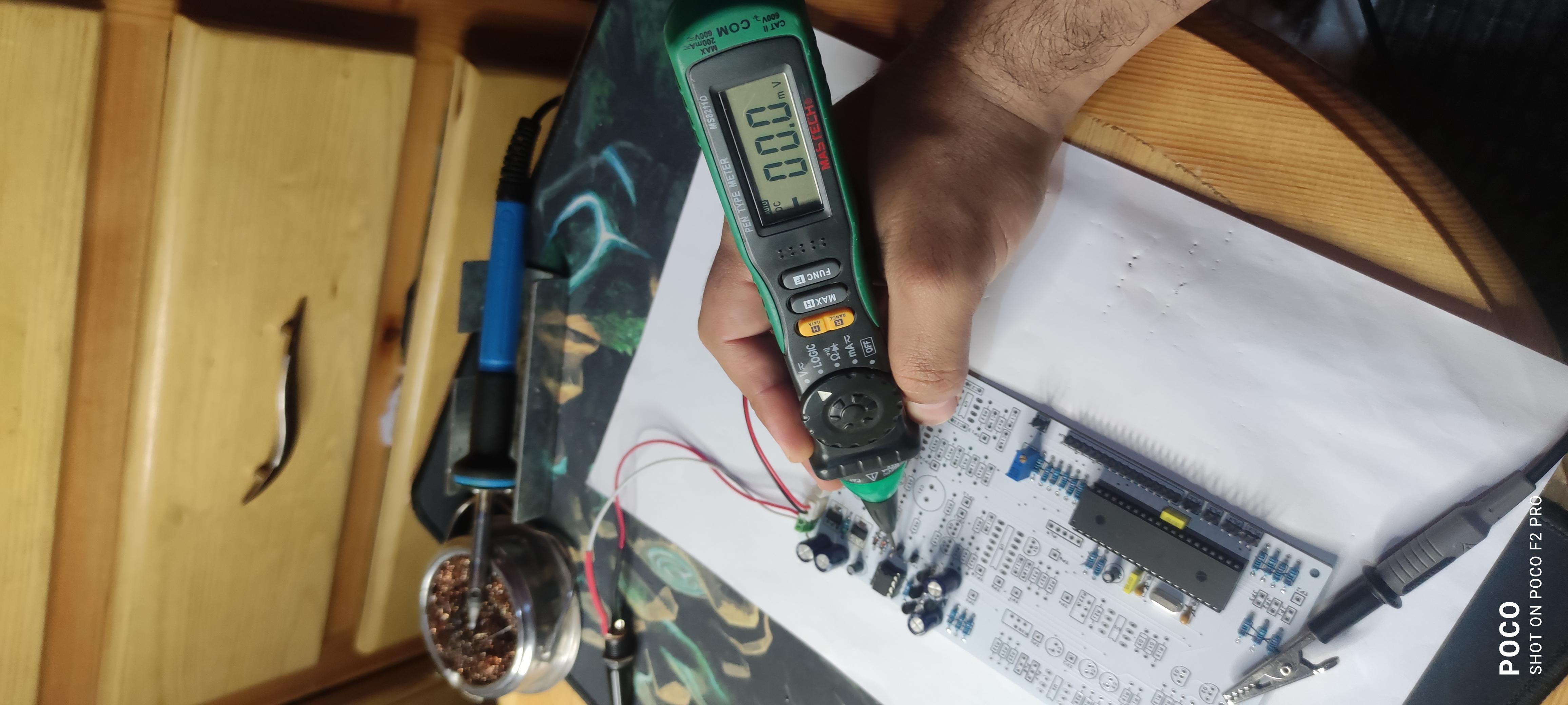

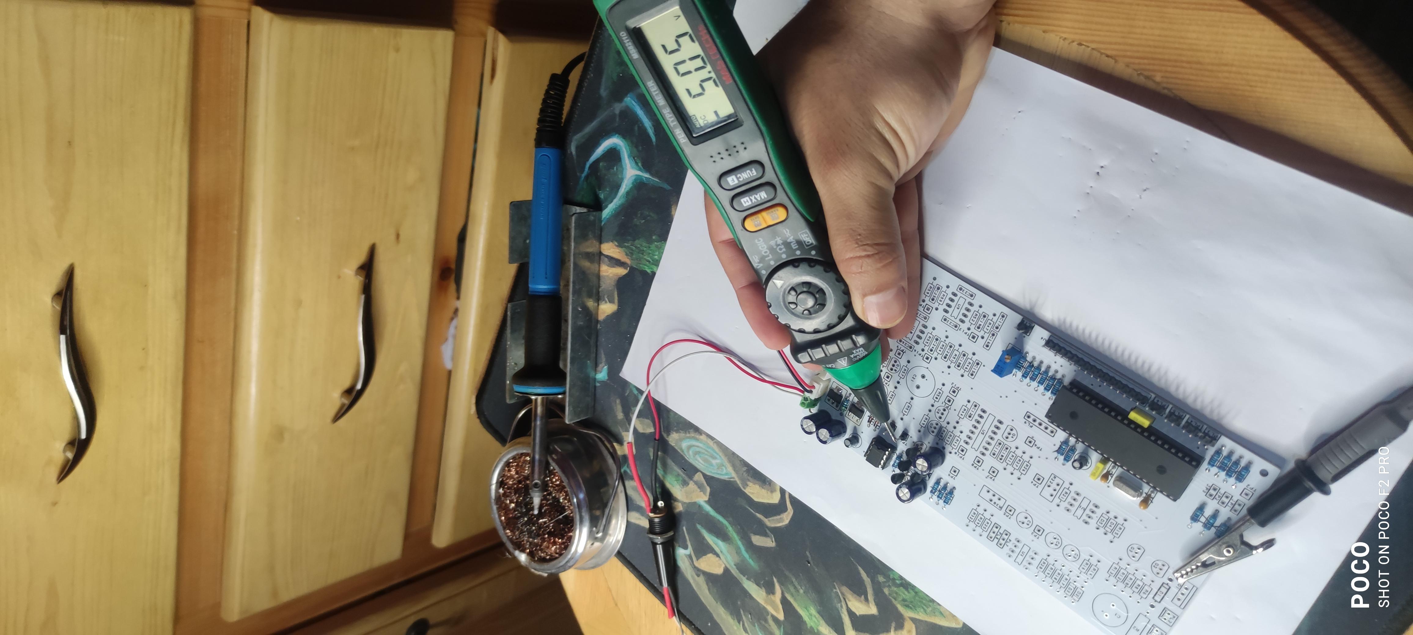

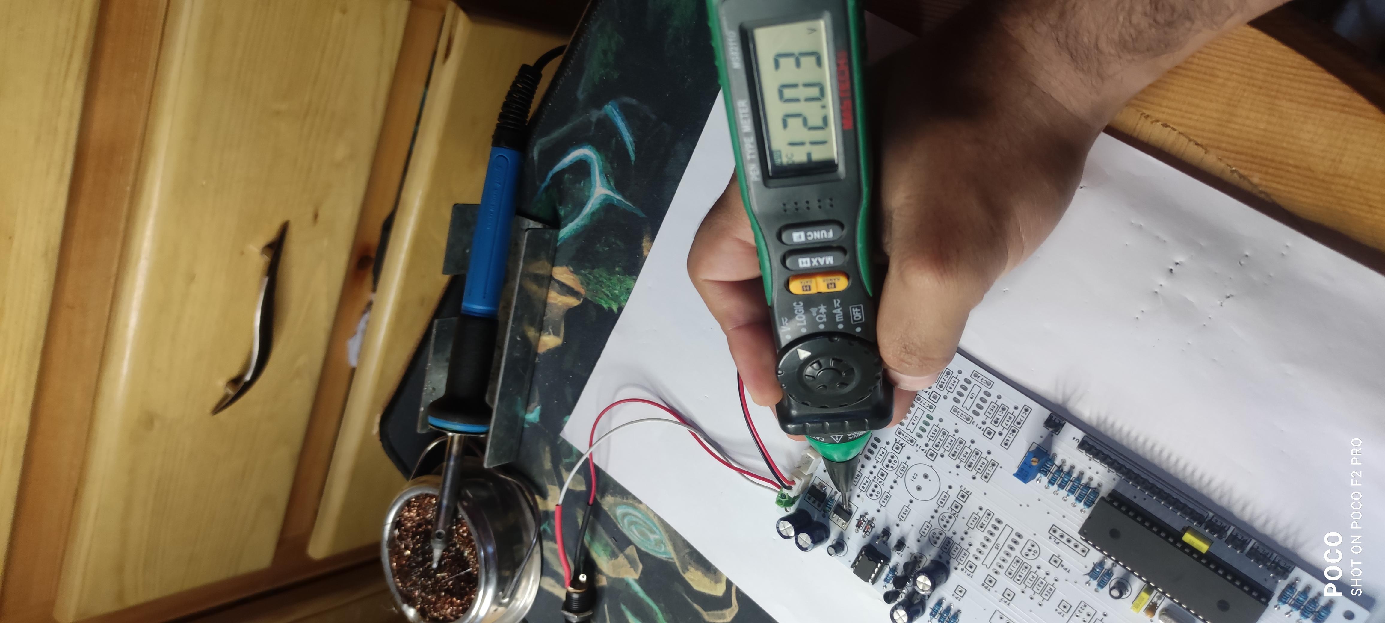

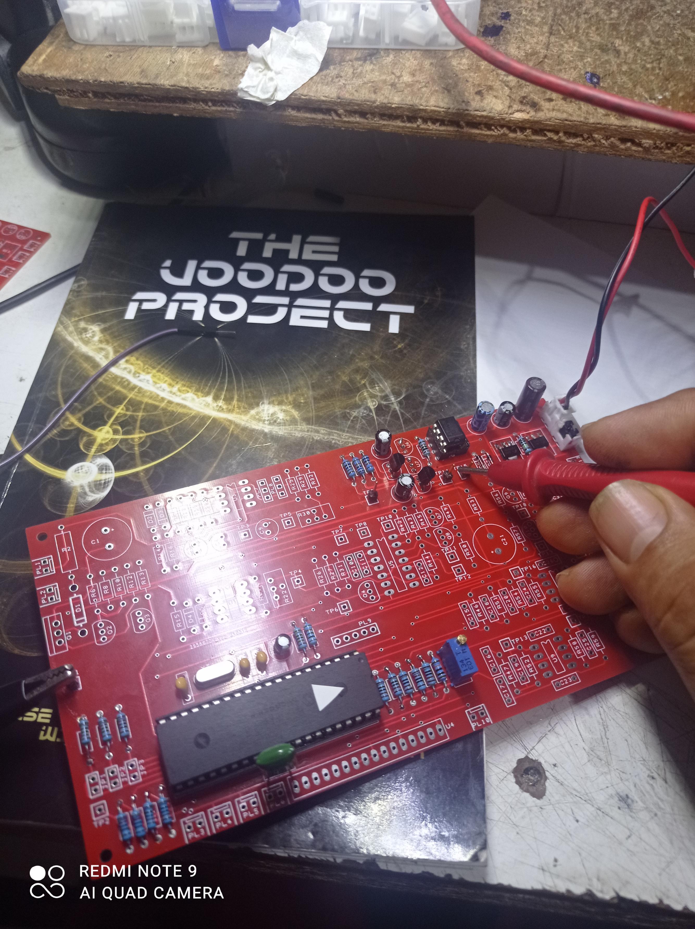

    I have a problem when testing tp15 tp14 on voodoo Power supply circuit .tp15 gives 0v and tp14 gives -0.9v.
    The pic is succefully programmed and the power supply is 12v 300 w ATX of the computer.
    Here are the screenshots of my board.
    I appreciate your help.Thanks a lot
    soon i will provide a video for the problem.

        If you have 0V at TP14, then you have a very basic problem as this voltage should be -5V. Without this voltage the PIC is not being powered.
        Have you checked that there is 12V coming into the PCB, and that you can measure -12V between TP1 and -VB (after the FQT7N10 mosfets)?
          have a problem on power suply
          tp14 = -5V
          tp15 = -0V
          tp1 + (-VB) = -12V

            Is the PIC processor programmed and its clock to the LT1054 running?
            You need a scope to check the clock.
