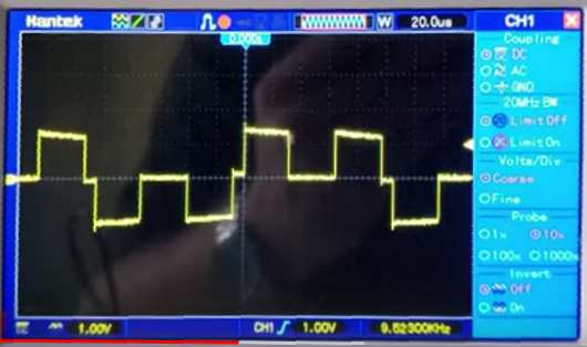

                If I understood correctly, a PWM signal without a resonant capacitor is applied to the input of the TX coil ?.

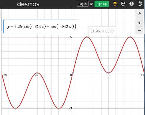

                      I have done some thinking about the 'three-level' waveform, and realise what XP have done.
                      If you add a sine-wave and its 3rd harmonic together, you will obtain this sort of waveform ... you may remember how square waves can be synthesised by adding a smaller amount ( 0.333 ) of 3rd harmonic, then adding ever smaller levels of higher harmonic etc.
                      If you add the same amplitude of third harmonic, you get a waveform very much like XP's synthesised one.
                      I used an online graph-drawer called 'Desmos' ( quite neat ) and here's a plot of:
                      y = 3.25 ( sin ( 0.314 x ) + sin ( 0.942 x ) )
                      this is: y = sin + sin ( 3x ) , scaled so the period is 20 and the peak amplitude is 5.
                      Notice the points of inflexion occur at time values of -8 , -2 , +2 , +8 , not evenly spaced out, with gaps of 4 and 6 seconds.
                      I think XP have taken this sinusoidal waveform , and put a 'threshold comparator' on it. Essentially, if the amplitude is below +2.5 and above -2.5, it's made Zero, if it's above +2.5 it's made +5; if it's below -2.5, it's made -5.
                      The level-switching times match up closely. The detectors waveform period is 210 microsecs ( freq = 4.75 kHz ).
                      The middle of the first peak is at 21 usec, the second peak at 85 usec. The short 'Zero-volt' time is 10 usec, the long one is 30 usec.
                      It all looks a good match ... but it raises the question: why is this waveform not used on the higher 8k / 24k mode ?

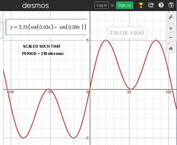

                      Update: I added a new sinewave, with Period = 210 usec ( 4.75 kHz ) so it matches the actual waveform.
