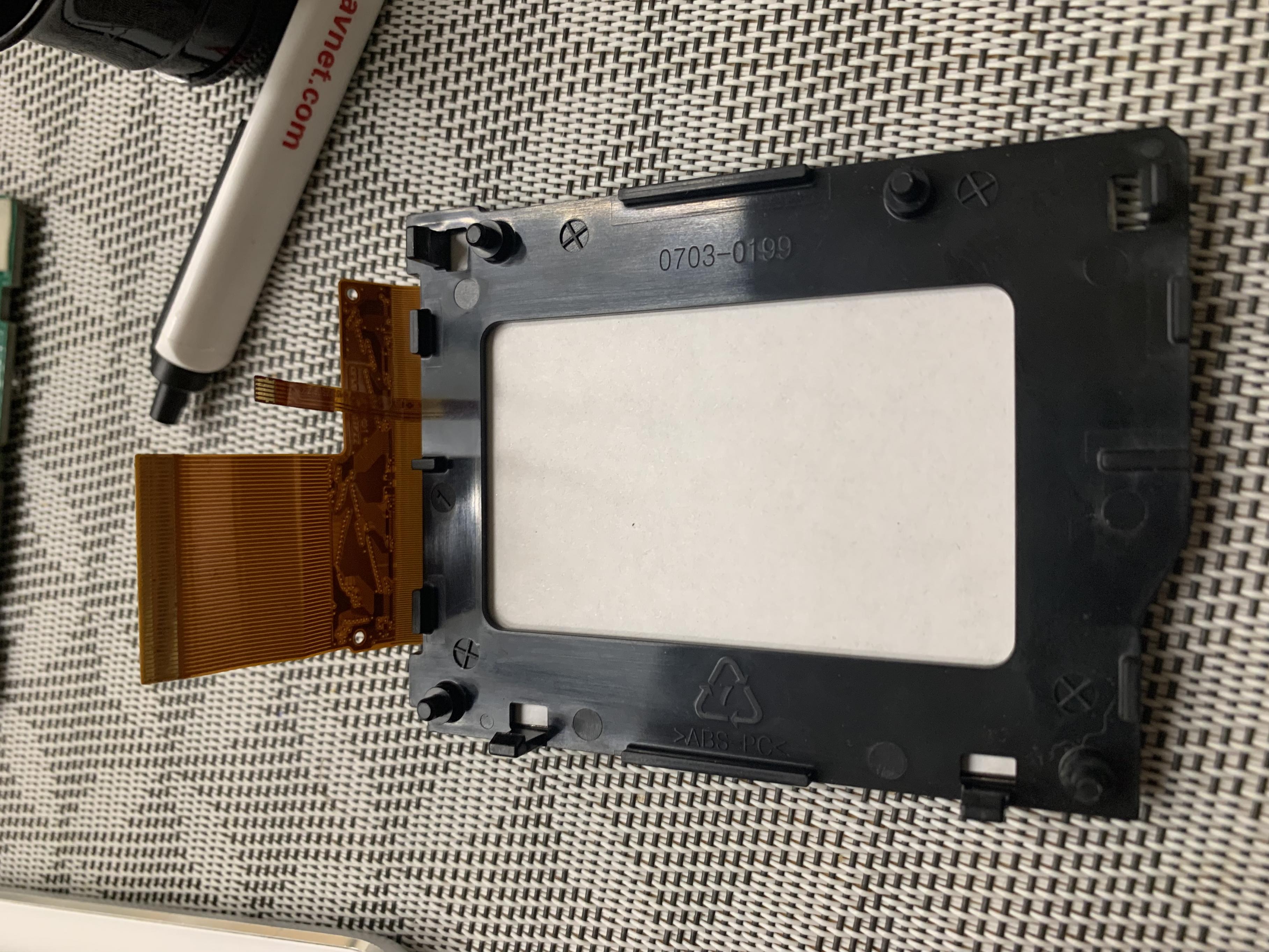

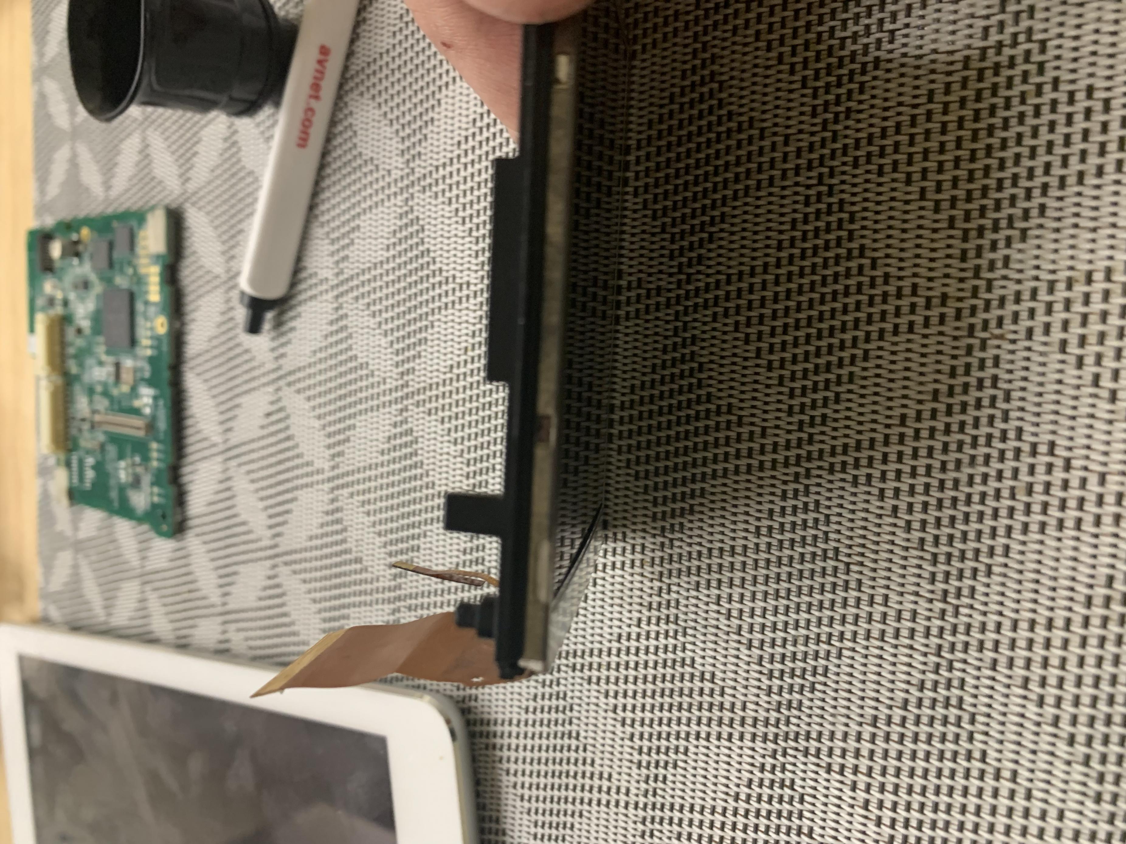

    I have a CTX-3030 repair I?m working on that has a backlight that doesn?t come on. It originally had a torn flex cable to the front panel but I fixed that well enough to test the detector- very thin wires crossing the cut and any flexing breaks them off the kapton flex. I need to determine if the backlight on the display is bad or if it is a driver issue on the board. What is safe to drive the backlight with externally to test it? Or what should I see on the backlight ribbon cable?
    if you have an adjustable bench supply try .5v and just increase in very small increments, if i had to guess it would be between 1.5-3v, some displays use really small voltages.
    not like the old days when they had those tubes.
      Add a series resistor to limit current, maybe 1k.
        Thanks guys, exactly what I had planned but wanted to check…

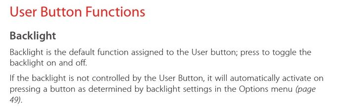

              hello, first you must check if the backlight is actually burned or if it comes either from the on/off button of the backlight, or from the tuning , see pic

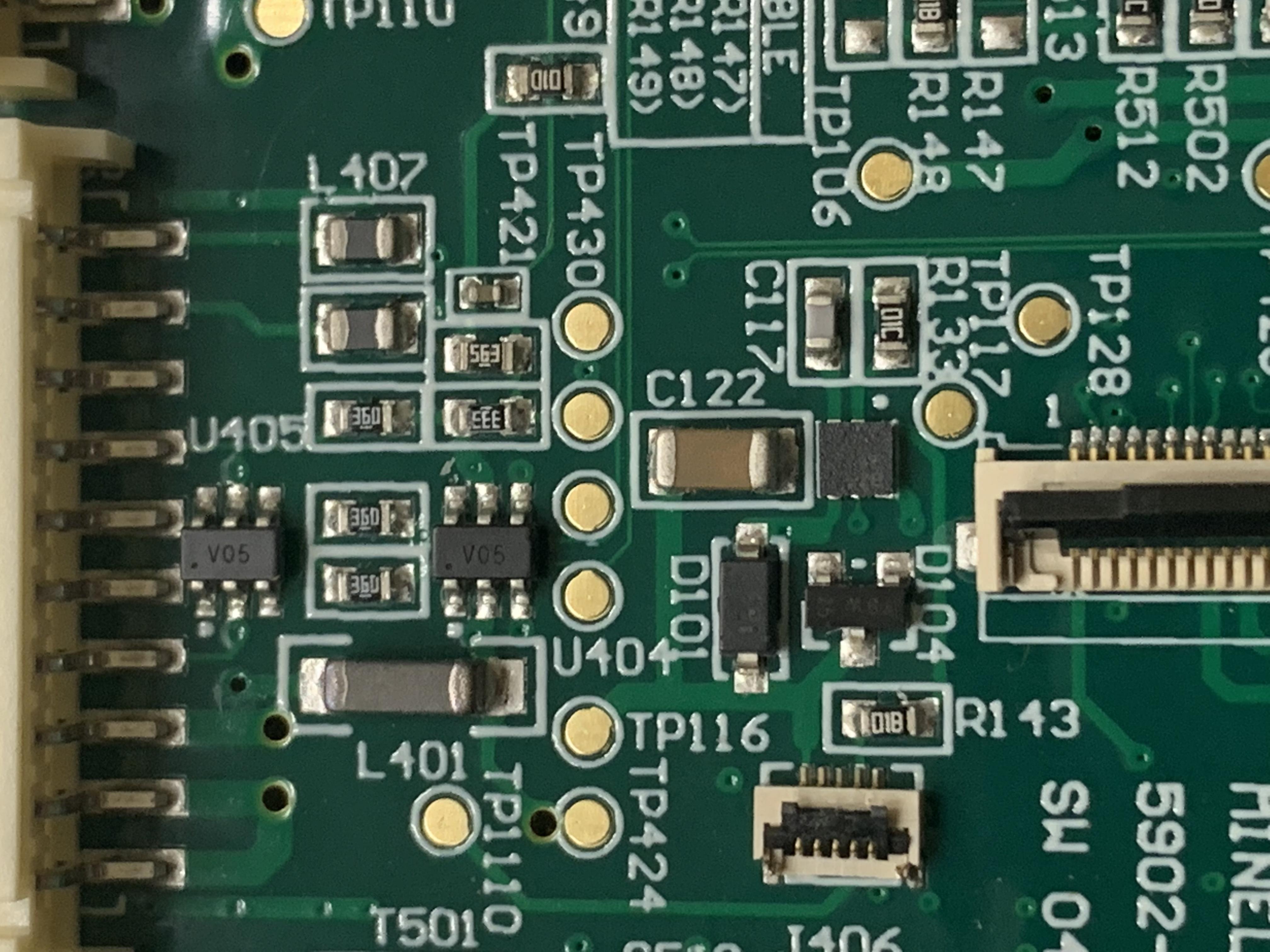

                  Check the chip to the right of C122. This drives the backlight. Is it an inverter circuit for an EL panel?
                    Chip marked BZS261 C3PC.
                      It’s a Sharp display and has a LED backlight. Six leds in series. Test with a 220 ohm resistor and 20VDC. So this means my driver board is bad…. Could Hotwire it…
