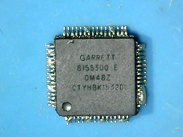

        Purely out of curiosity; does anyone know more about this chip?
        GARRETT
        8155300 E
        0M48Z
        CTYHBK15320
          It's custom-labeled micro. You would have to decap it to see exactly what it is, although the pin hook-up may get you close.
            I suppose so.
            Ideally it would be if it is known Atmega or PIC; masked by custom label.
            But than... Garrett is wealthy enough to produce own custom chips (to order from third party, more likely).
            I am just curious.
            The chip from photo is alright, not burned and not faulty. I only need to clean it from flux and tin.

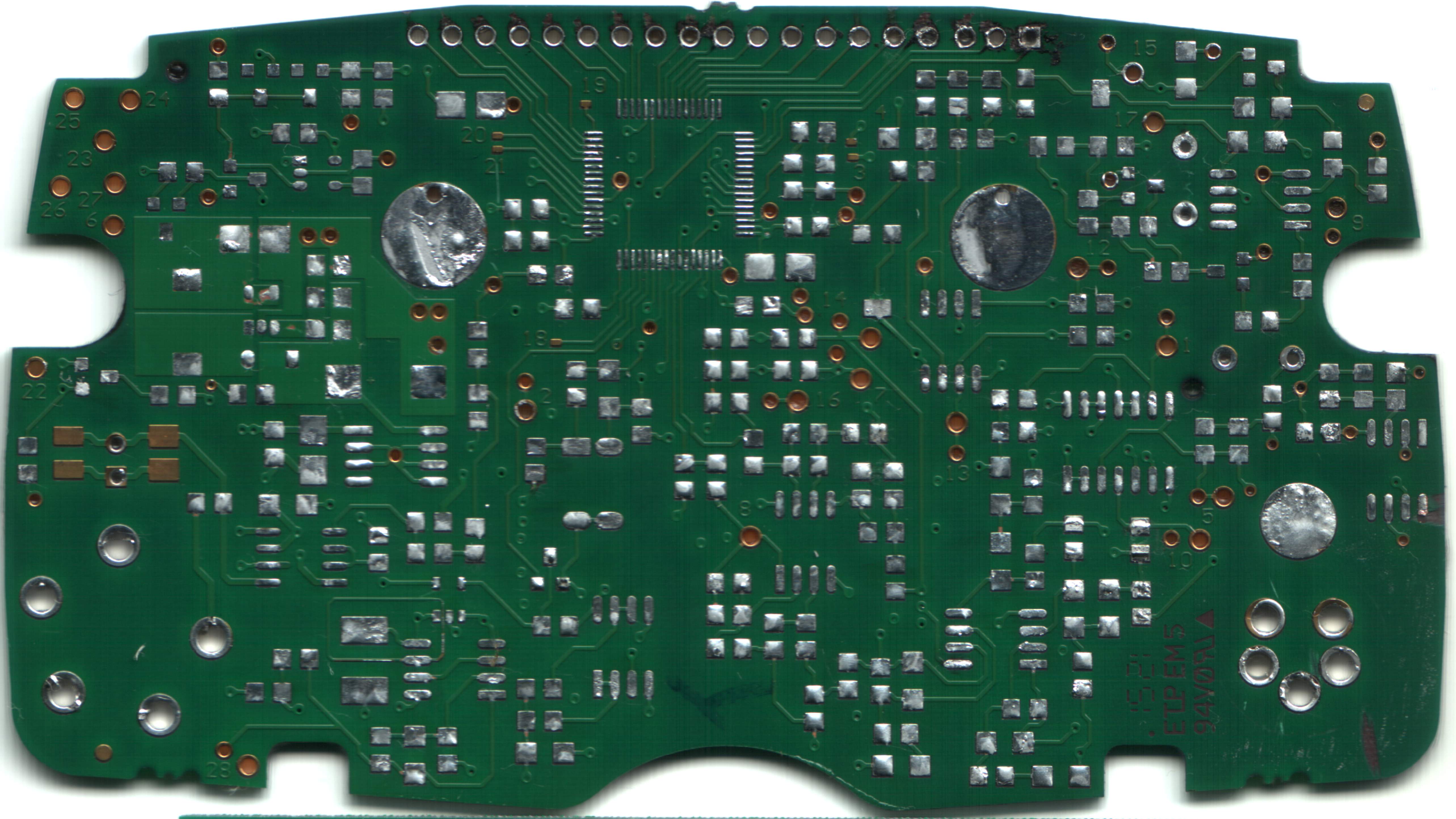

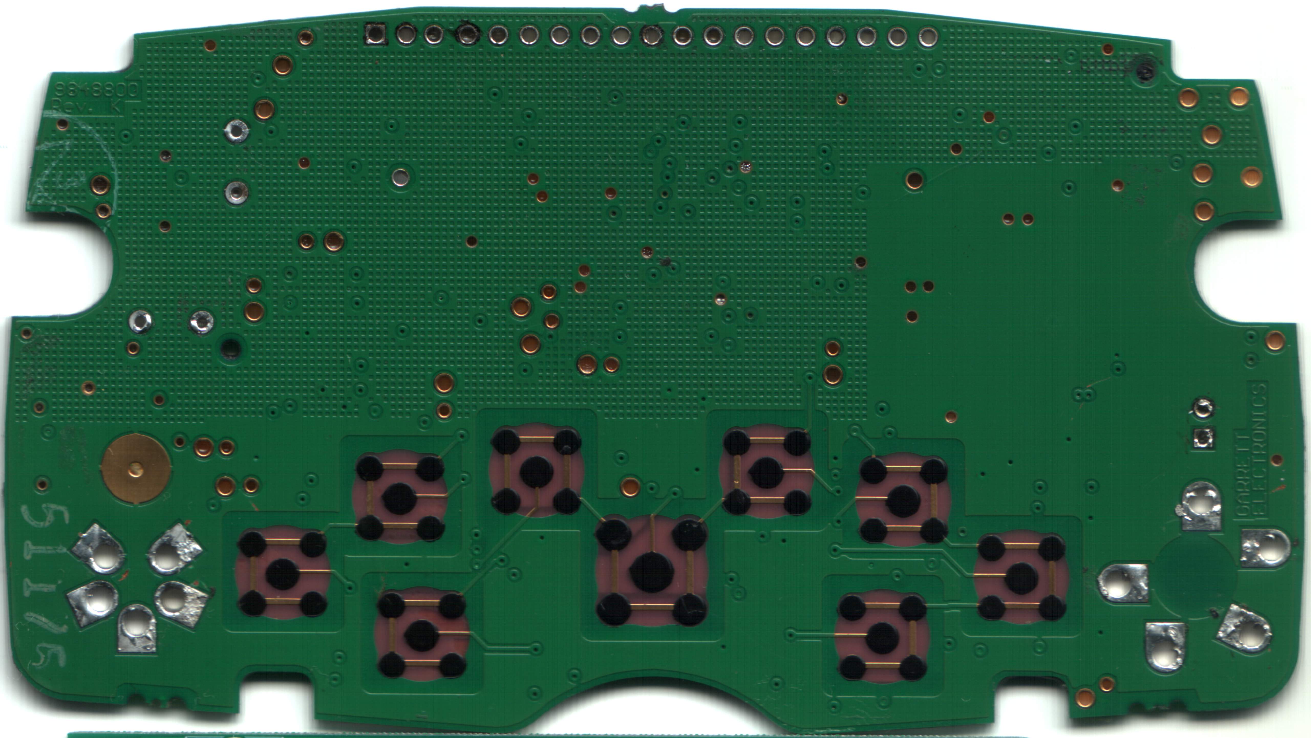

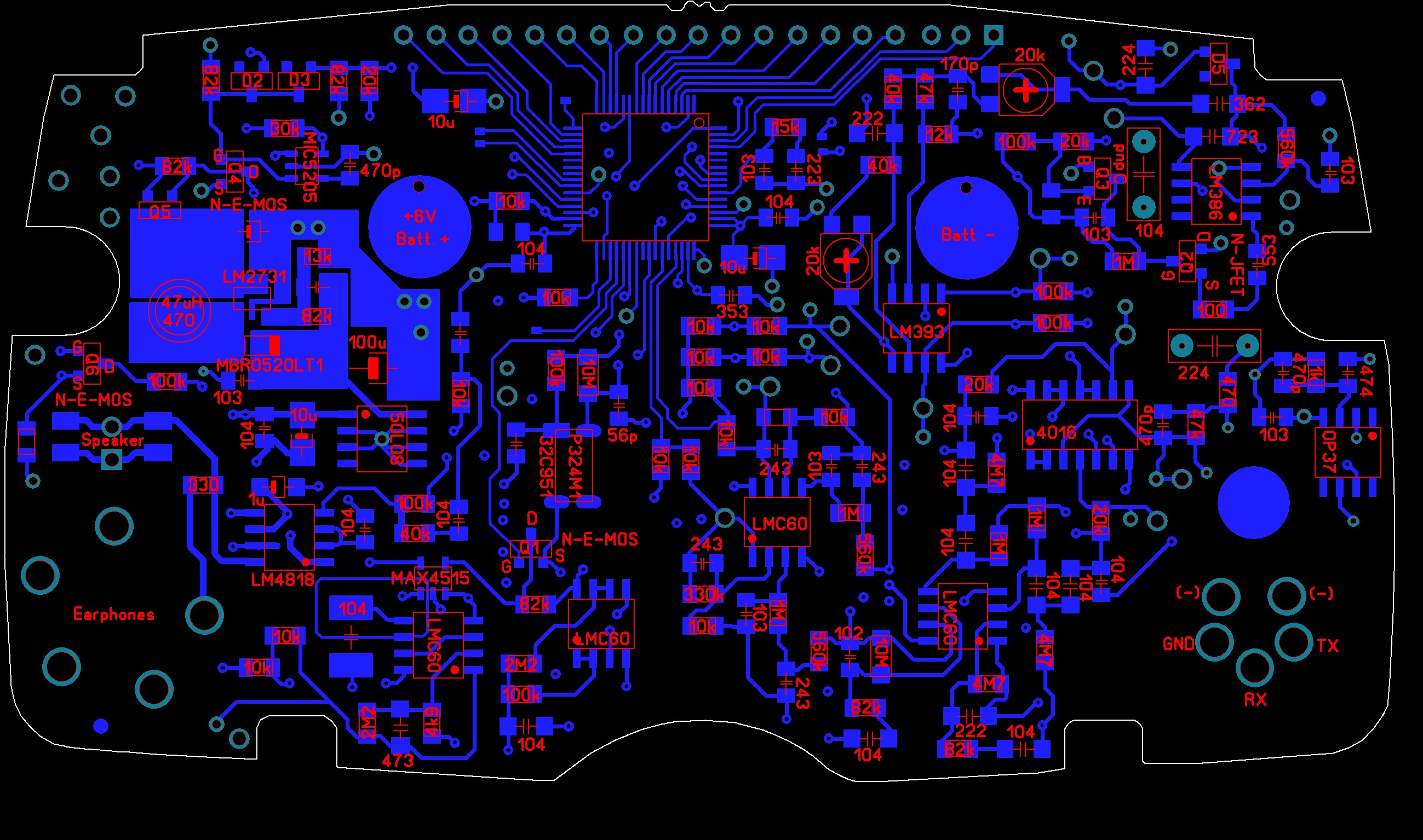

            Along with Euro Ace which is serviced I had also broken Ace 250.
            So I decided to remove all from pcb, scan pcb and make files and documentation on it.
            There is one and the same schematic of Ace 250, circulating over the net and forums.
            But it is having lot of mistakes, so as I noticed.
            So I wanted to try to make more correct schematic of it. At least of some stages on it, that I find interesting.
            Ace pcb is not only 2-layers, seems it is multi layers, can't tell is it 3 or 4-layers board yet.
            So now I am in process of analyzing details and trying to put all together in Sprint Layout.
            Removing parts from the board was not easy.
            Removing parts from the Euro Ace board was much easier.
            While removing parts from the Ace 250 board is twice as difficult ??
            I especially had big problems with removing parts near the processor as well as removing the processor itself.
            At 400 degrees and at 1/3 of the air flow; it is still very difficult and time consuming to remove.
            I assume that this is because the middle layer in the pcb is a large mass or ground plane, which covers that area,
            probably for better S / N ratio.
            And possible due to better heat distribution or cooling of components in that part.
            And the collateral of that condition is also the great difficulty of removing the components and analyzing that circuit.

            Yet with a multi layer board, a processor I don't know which one it is, a lack of code for that processor; this work is at the limit of my amateur abilities.
            So because of that I am not carried away by some great ambitions, I will be satisfied only to accurately reverse a couple of solutions from it that interest me.
