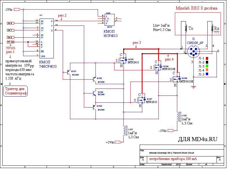

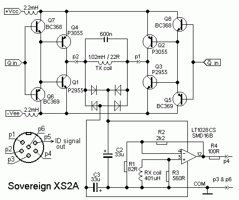

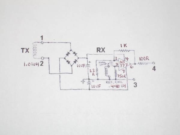

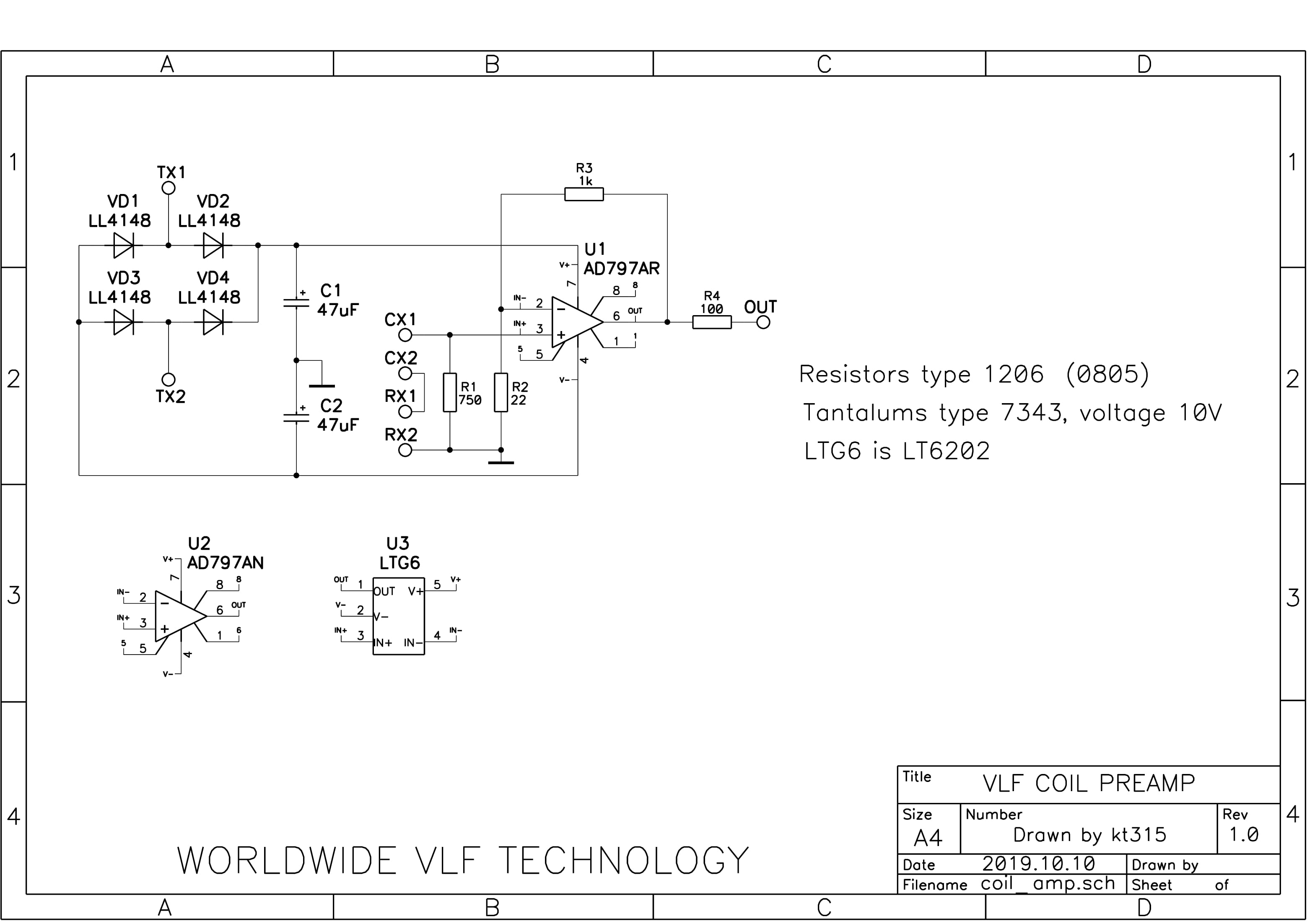

        Are those preamp circuits in both Sovereign and Excal? OBN has some sort of booster on his machine - I wonder what it is…
          Exal is sure Sovereing Elite.
