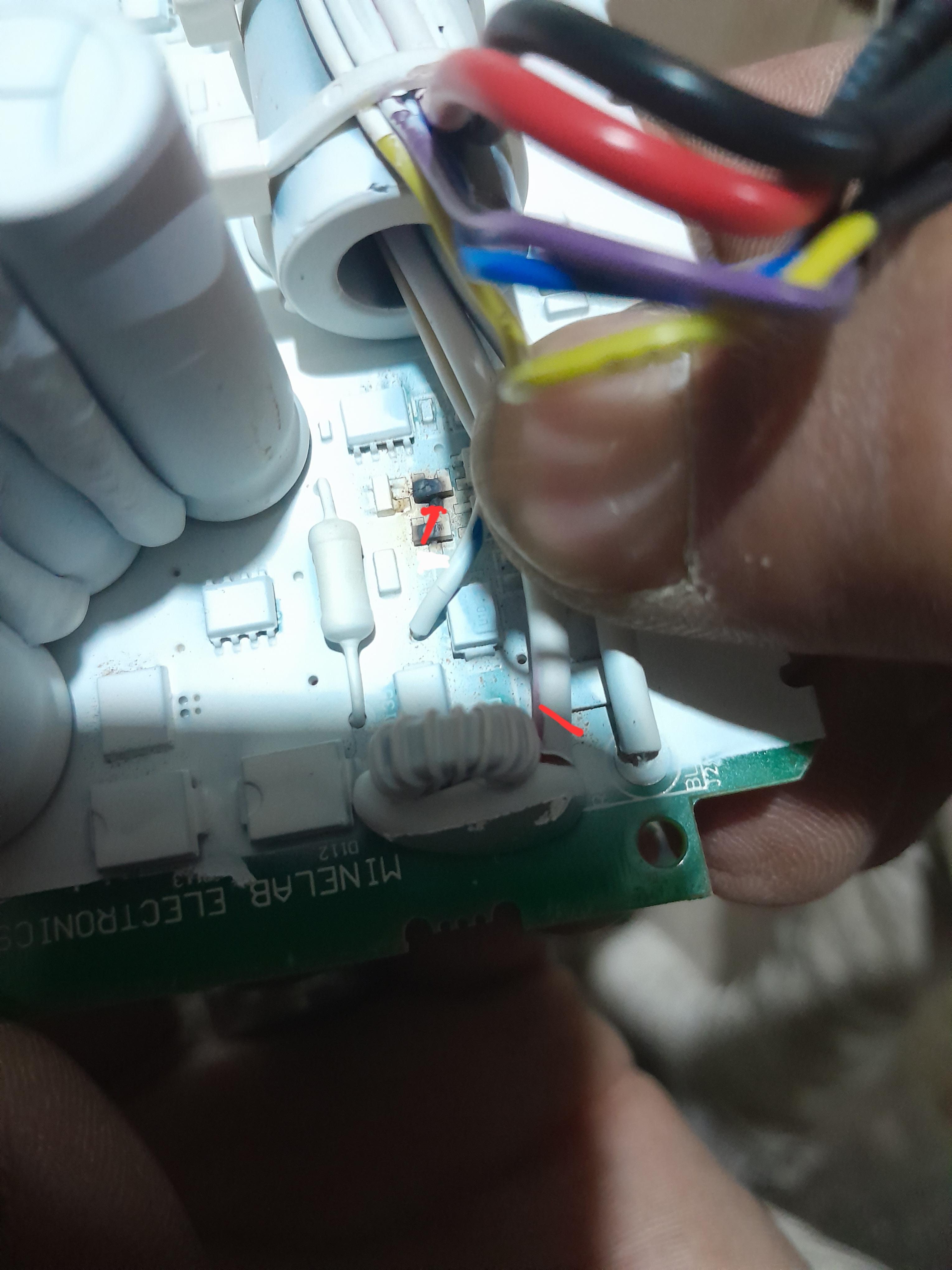

      help me where can I connect the anode/gathod of the diode directly because I lost track ? and I can't remove the paint

        If you watch the video i point out the N channel mosfets and the bav99 protection diodes, just remember that SD GP detectors input fets are n channel and then p channel and with gpx the fets are both n channel, my take is that the p channel had too much intrinsic capacitance for the faster switching time for enhance and fine gold. Did you see my video on the floating front end? Gets rid of the board based gate drive with associated noise injection and gate modulation.
        The device worked well until I tried a commercial coil I think it is not compatible with the device. Perhaps its resistance is higher than what is required. The device now does not work in normal mode. Waiting for help
          Only few people have pocked around the GPX so much that they may be able to help with that. But this sounds serious.
